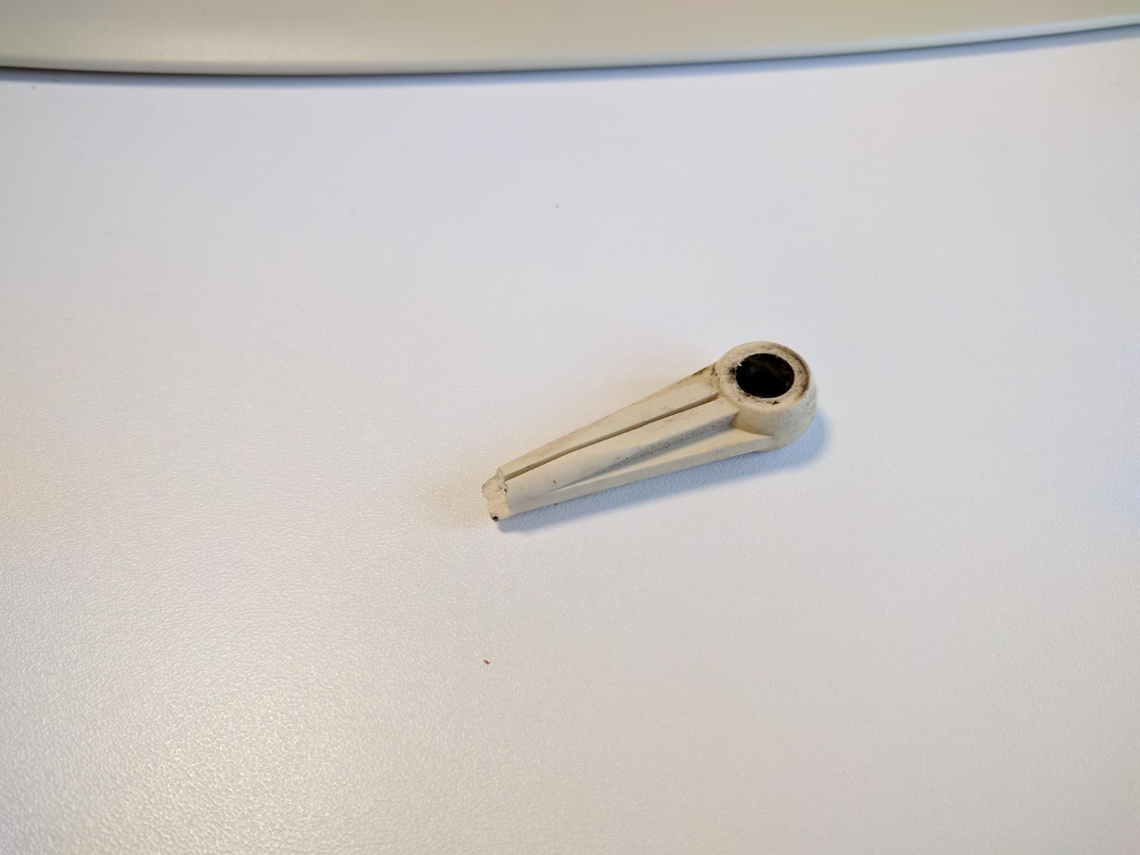

Colleagues wife's focus broke some plastic clutch bracket over the weekend (so it's not just French this happens to!)
Anyone know what this part is called, and how the rest of it comes off to be changed? I presume the other end is attached to a cable (he said it is there still) but I did tell him I knew nothing about it, but knew some chaps who might...
In short, you can't, it's part of the clutch master cylinder. You have to replace the lot, new part is £20 on eBay but it's a pig to fit if you don't like working upside down in the footwell of the car.
Yep I had this in my Focus, thats located at the top of the clutch pedal and you cant replace that little part I went to Ford and bought a new master cylinder and fitted it within an hour. The drive to Ford without a clutch was interesting. Cost about £40 quid I think.
THat white bit connects to the top of the pedal on an actuator type thing, I actually bodged mine - before I replaced it. I piece of copper pipe attached to that bottom of that and squahsed onto it to hold it all in place did the trick.
Yep, a chlostrophobic job and not a lot of room to move. Think I actually removed the driver's seat.
Also involves a bit of fannying around at the bulkhead at the other side to release the connectors, then you'll need to bleed the clutch, which in itself isn't hard.
Probably an hour or so Labour in a garage.

A local garage is popping round this afternoon to have a look apparently, and made noises about just being able to replace the arm. I made noises about making sure the master cylinder isn't on the way out or similar (as per the clutch clip going twice on my xantia, pointing to issues further down the system etc) and he said he would bear it in mind.

Chances are if it's old it's weeping anyway. I'm surprised how well they actually last given they're only plastic.
get a good brand if replacing , dont want to do it twice
didnt find it too hard to do , needed a ratchet spanner iirc , use a syringe and clear hose to reverse bleed it easily

Just thought id update you, the guy came out to fix my wifes car today, apparently the clip on the pedal itself has is broken which caused the issues. The replacement part from Ford apparently costs £500!!!!!
Although hes managed to find one for £35 on ebay!

I told him to go for it, as the cars probably not worth £500. Told him to mind the labour charge to change the pedal assembly and master cylinder/master cylinder clip though.

Oh, turns out this is after £140 for a new master cylinder. Oops, but tbh the prices seem fair for getting someone else to do it
All he needs is the new master cylinder, happened to my Focus, £30 odd quid for the part and a couple of hours of time. Job done. It's a fiddly job - clutch will need bleeding afterwards. But its two bolts and out it comes.

Got the T-shirt with this one too. Clutch master failed along with the pedal. It's cheap nasty rubbish (as you'd expect for a Ford) and I too am amazed they last as long as they do.
I don't remember it to be a difficult job, but for some reason took an absolute age to bleed through, along with loads of brake fluid. I bodged the clutch pedal with a nut & bolt iirc, which worked fine and outlasted the rest of the car.

I couldn't afford to fix the master cylinder on mine to begin with. I bodged it with a piece of copper pipe squashed and melded to fit, glued the white actuator thing inside of that and popped it in place. It lasted quite a while like that.
