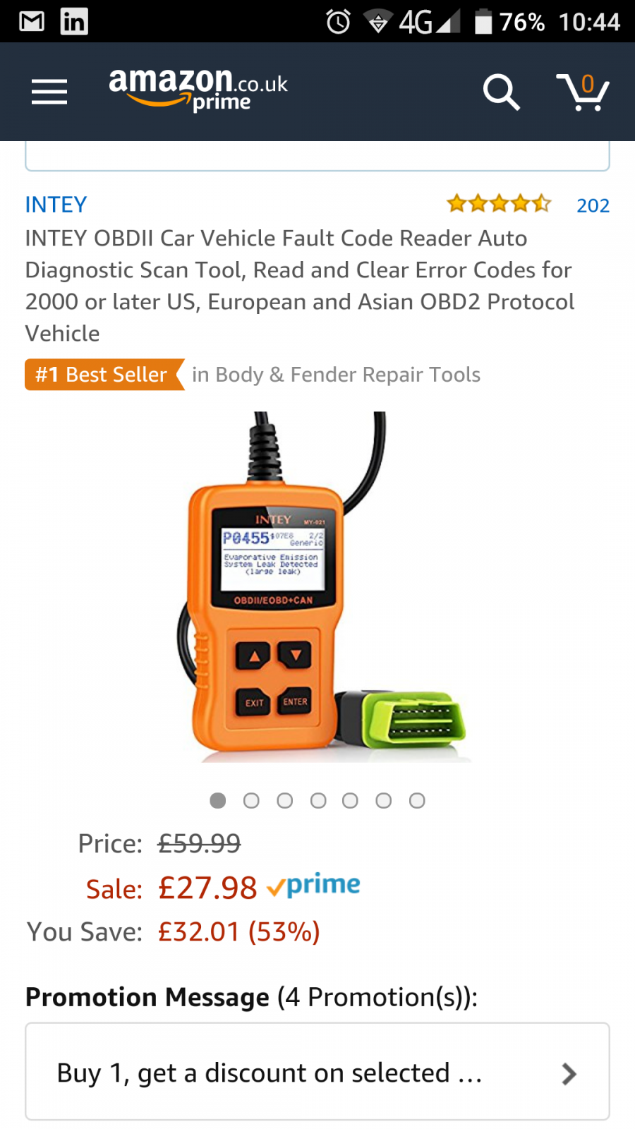

Thanks Mr Cobblers and all others who've commented. This is a great site for practical, down to earth advice. I now feel a bit more qualified on this subject! Think i'm going to treat myself to a code reader.
I've bought one of these which I can use to check the fault code and hopefully will work on other cars too.
Well, nearly a week in and no engine light. She's very happy with it so a good result. Will still try connecting my new fault code reader though to see if it works.
