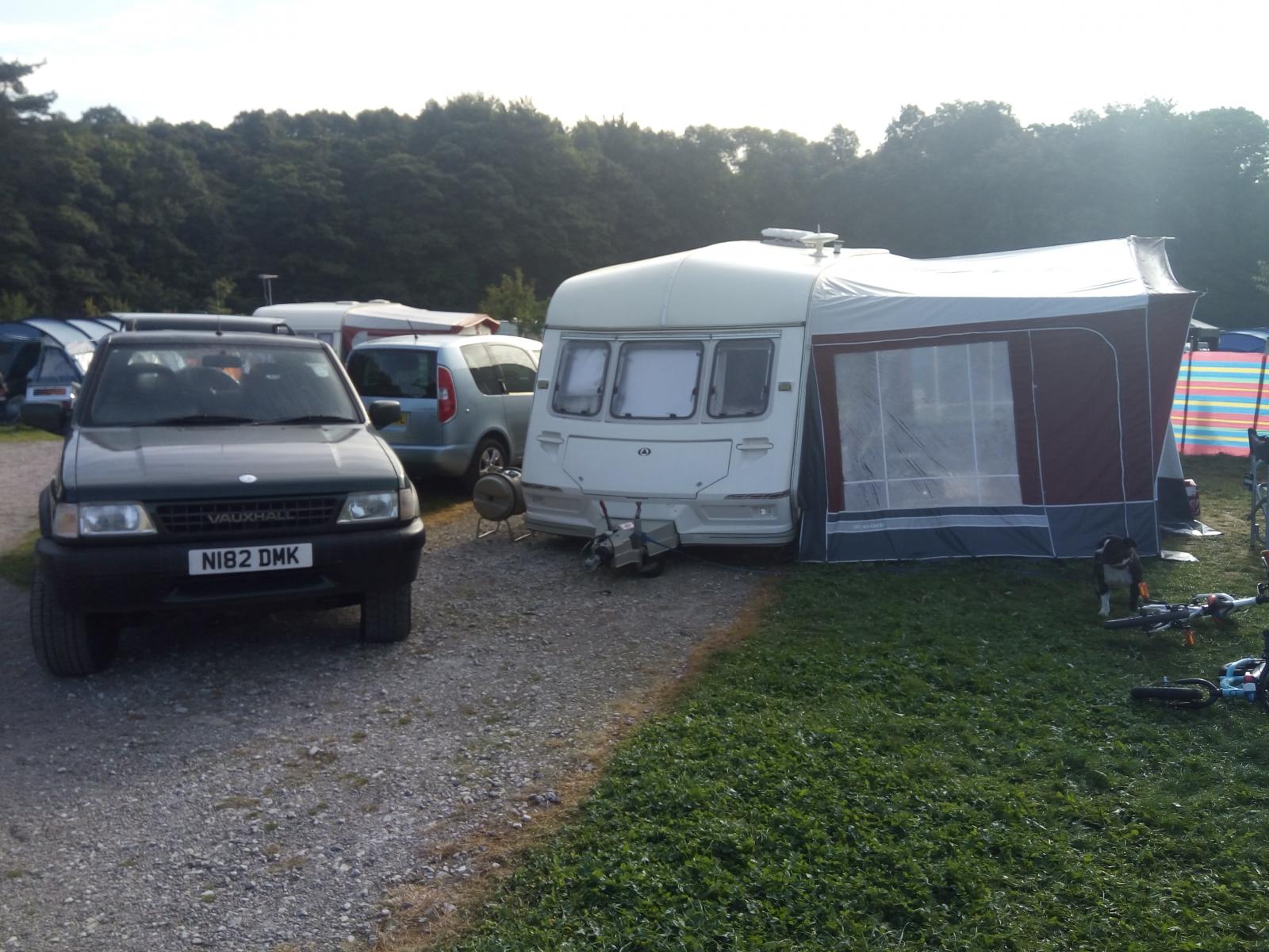

Frontera burst its rear brake pipe as I was about to hitch it up and drive home. Literally as I put foot on brake to release handbrake and leave. Loaded avec wife and kids etc. Bloody good job too.

Older 4x4 and light commercials have a front/rear split, as does this one. Rear pipe burst. Fronts now lock horrendously and have a min brake effort. Drove back solo very steadily. Parking brake/engine brake/ light braking. Oooer.
Zero risks taken. Braking commenced far far in advance of any possible hazard.
