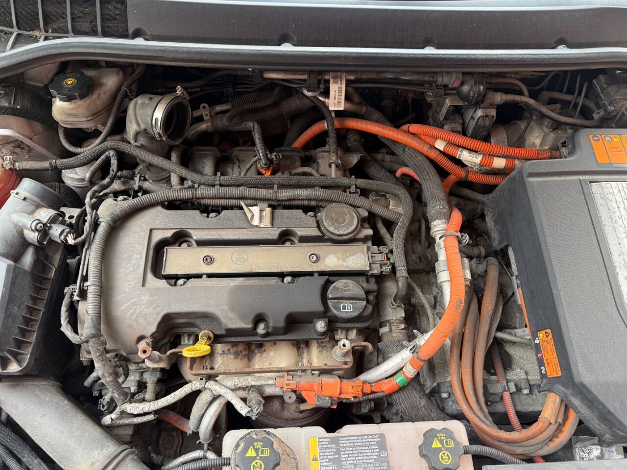

The Ampera has been behaving itself by and large, with just an occasional EML relating to a fuel tank evap leak. I stuck it up in the air the other day and connected up the smoke tester to the filler neck to check for leaks but everything checked out ok.
Fast forward to today and a flash of inspiration occurred…the purge valves on the inlet manifolds are known to fail quite regularly on GM stuff so off it came and sure enough, it’s not sealing correctly.
I bodged it up with a finger from a rubber glove to effect a temporary seal and it’s now running fine with no pending codes in sight so a new one has been ordered for the grand sum of £12!
