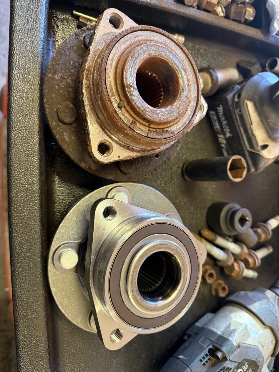

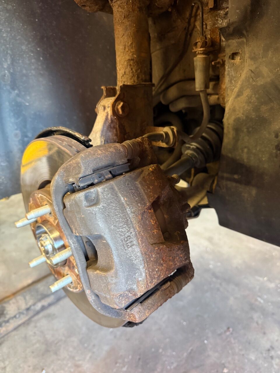

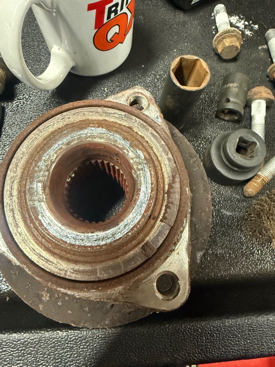

We’ve found the issue…
You can just see the remains of the magnetic pick up ring at the 3 o’clock position of the wheel bearing assembly.
It’s amazing it managed to pick up any signal at all to be frank!

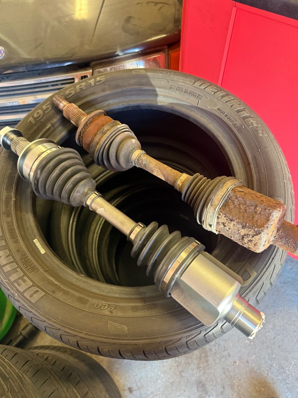

The driveshaft isn’t too bad but there’s a pair arriving tomorrow courtesy of DPD and the nearside CV boot is split and held on with a rusty jubilee clip so, for the sake of £115, it’s getting both sides replaced.

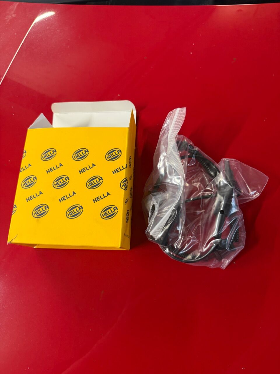

The ABS sensor turned up this morning…£12 for a Hella one…so just need to order a new wheel bearing and it can all go back together.

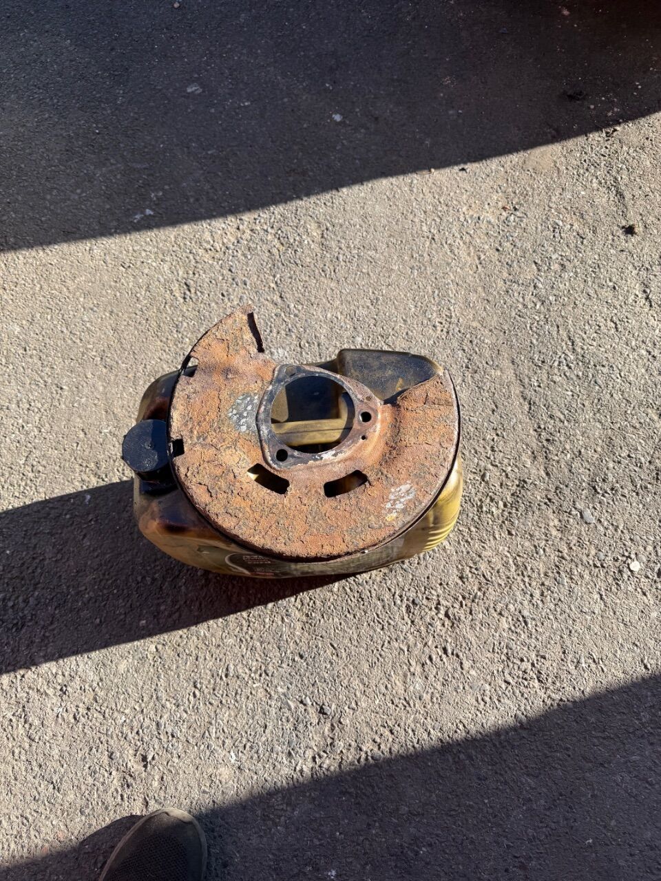

A new wheel bearing was ordered this morning…can you tell which one is which?

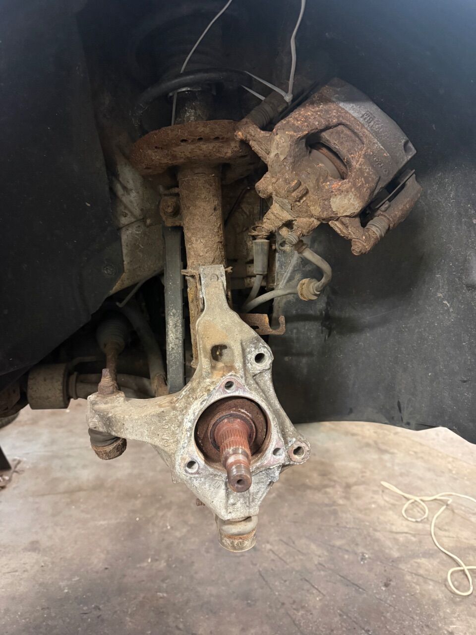

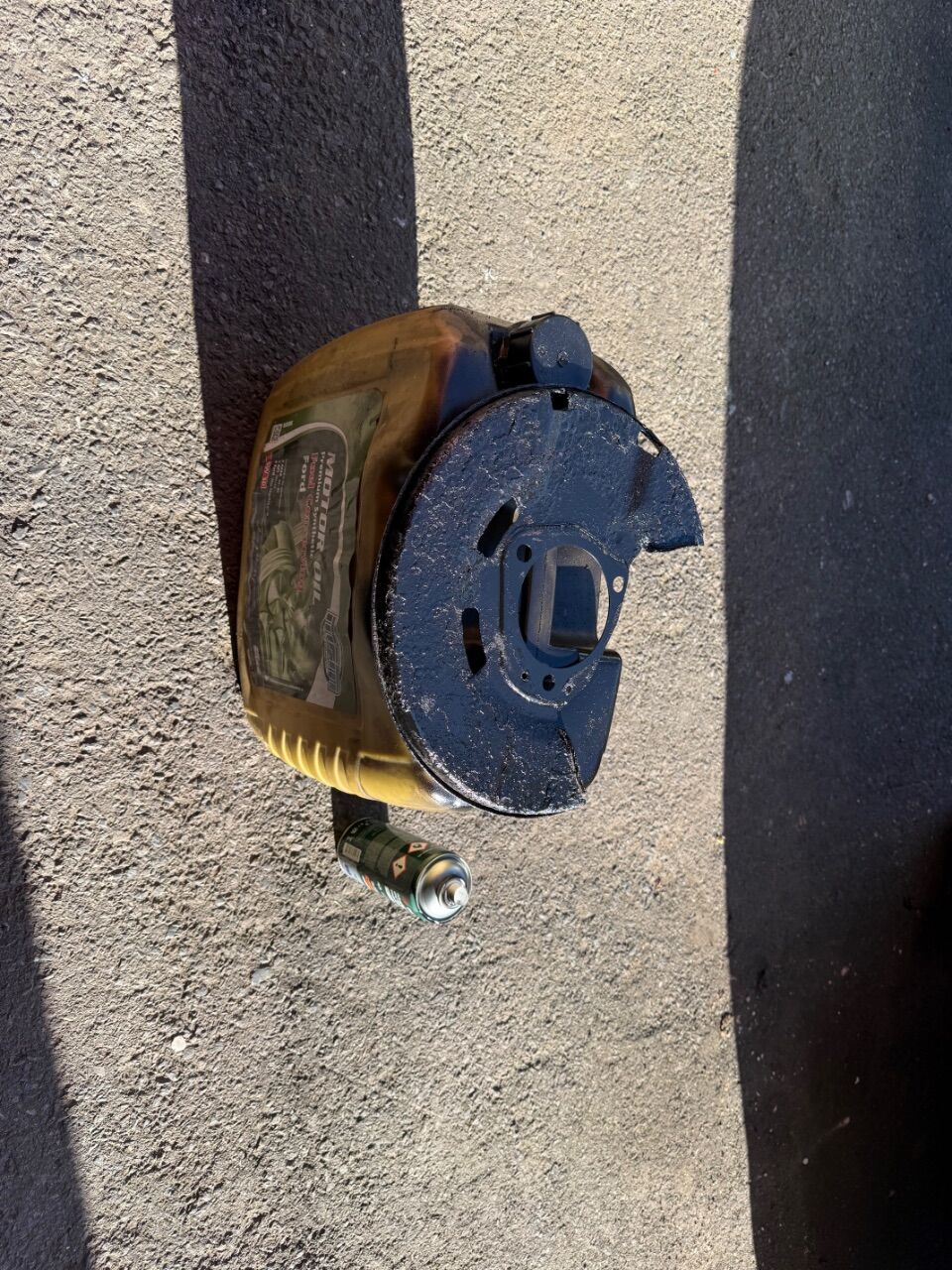

Whilst everything is stripped down, the brake backing plate was attacked with the wire wheel and treat to a couple of coats of Lidl’s finest black rustproofing paint.
This…
became this…

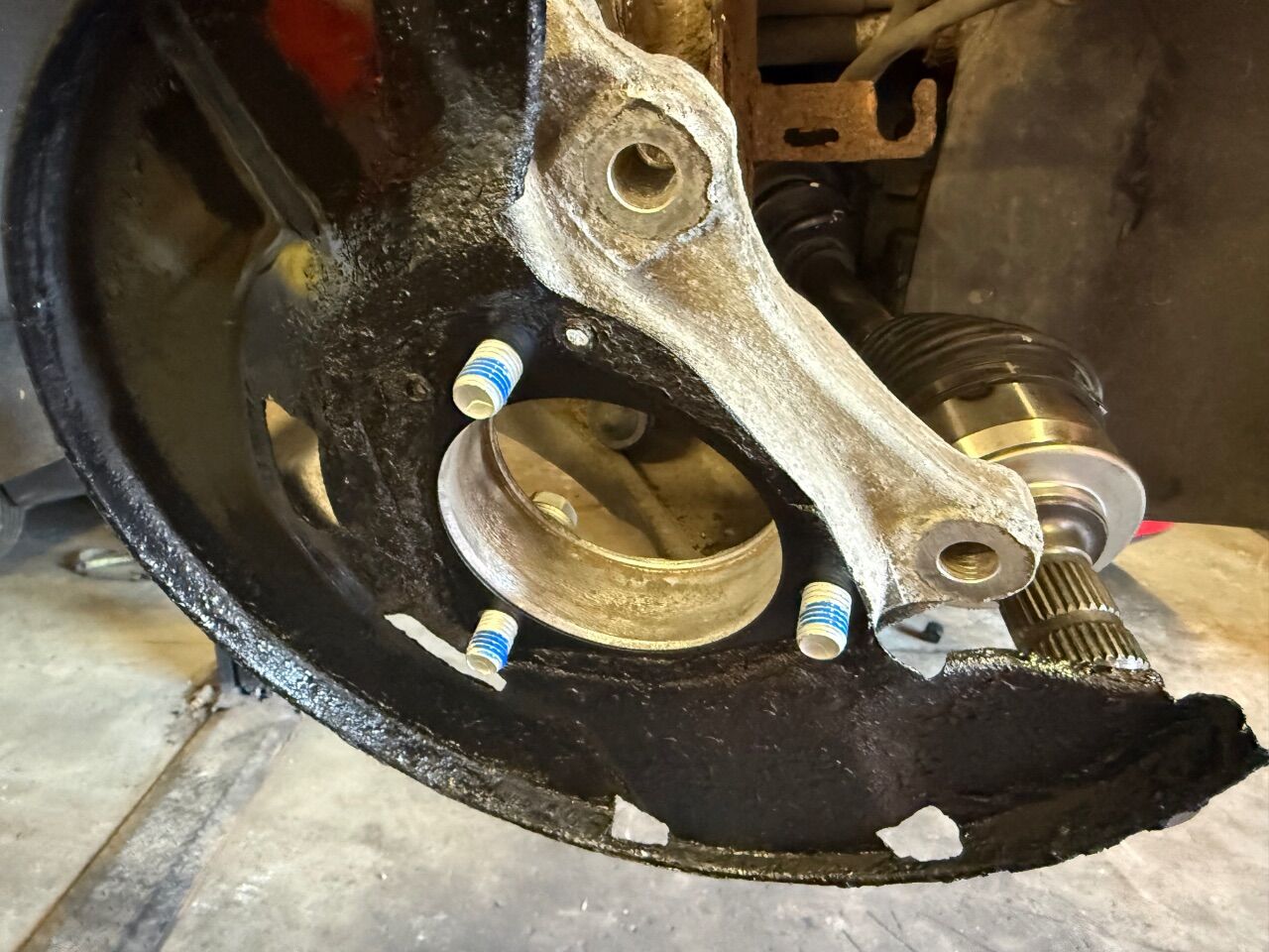

In place and ready to fit the new bearing hub assembly…

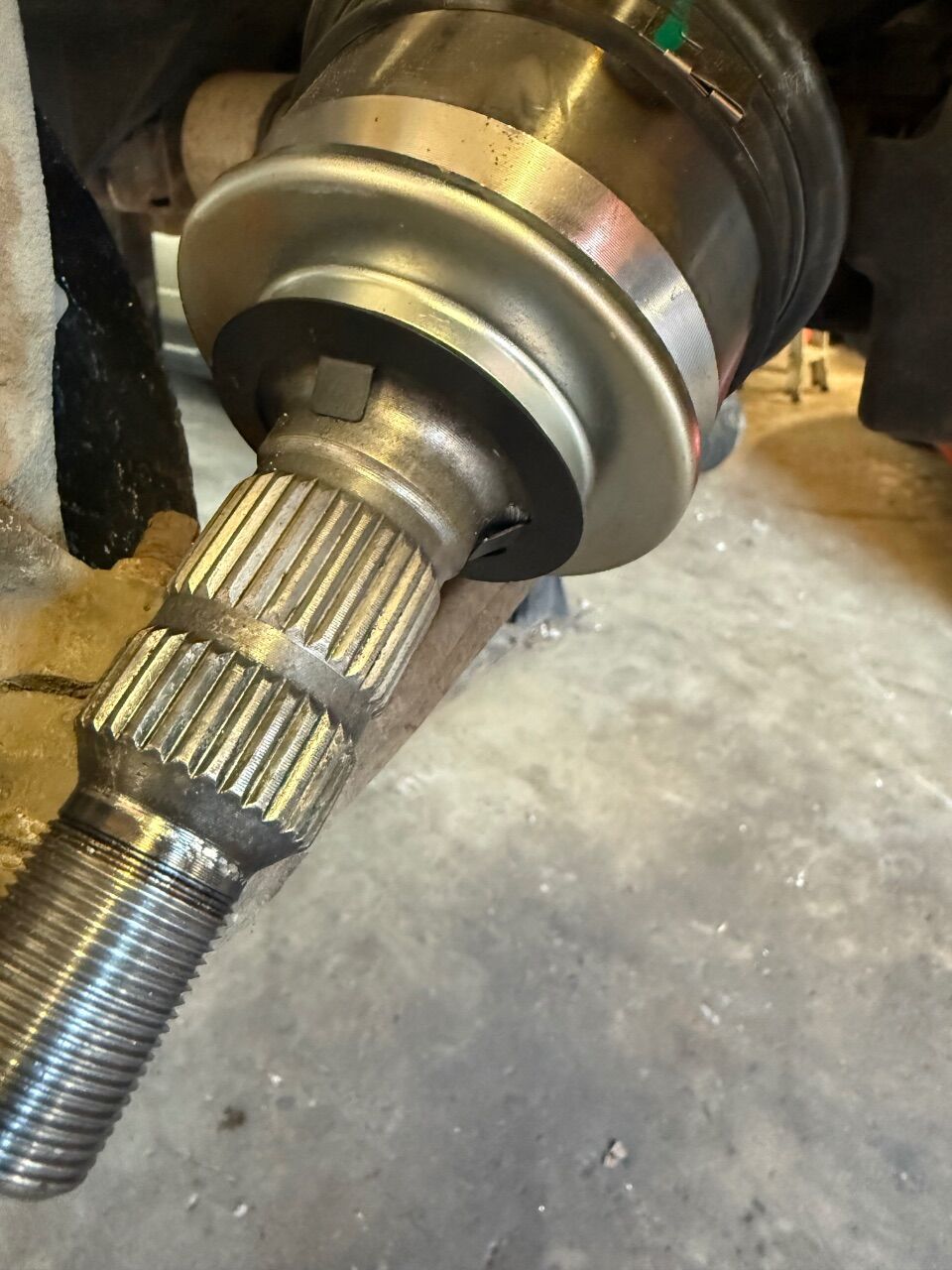

…then it was time to swap the driveshaft. Not strictly necessary but they were on offer and are shiny…
Fitted, along with one of the new genuine washers that @Bear left in the boot…

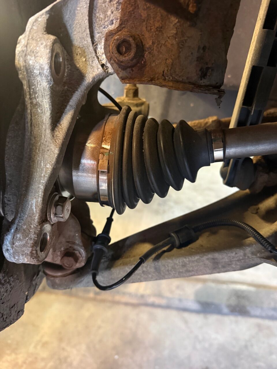

…followed by another new sensor…
and it all went back together nicely…
After all that, we have no fault codes at all remaining!!
Still drives exactly the same (beautifully) but just with a lack of yellow lights on the dashboard 😂

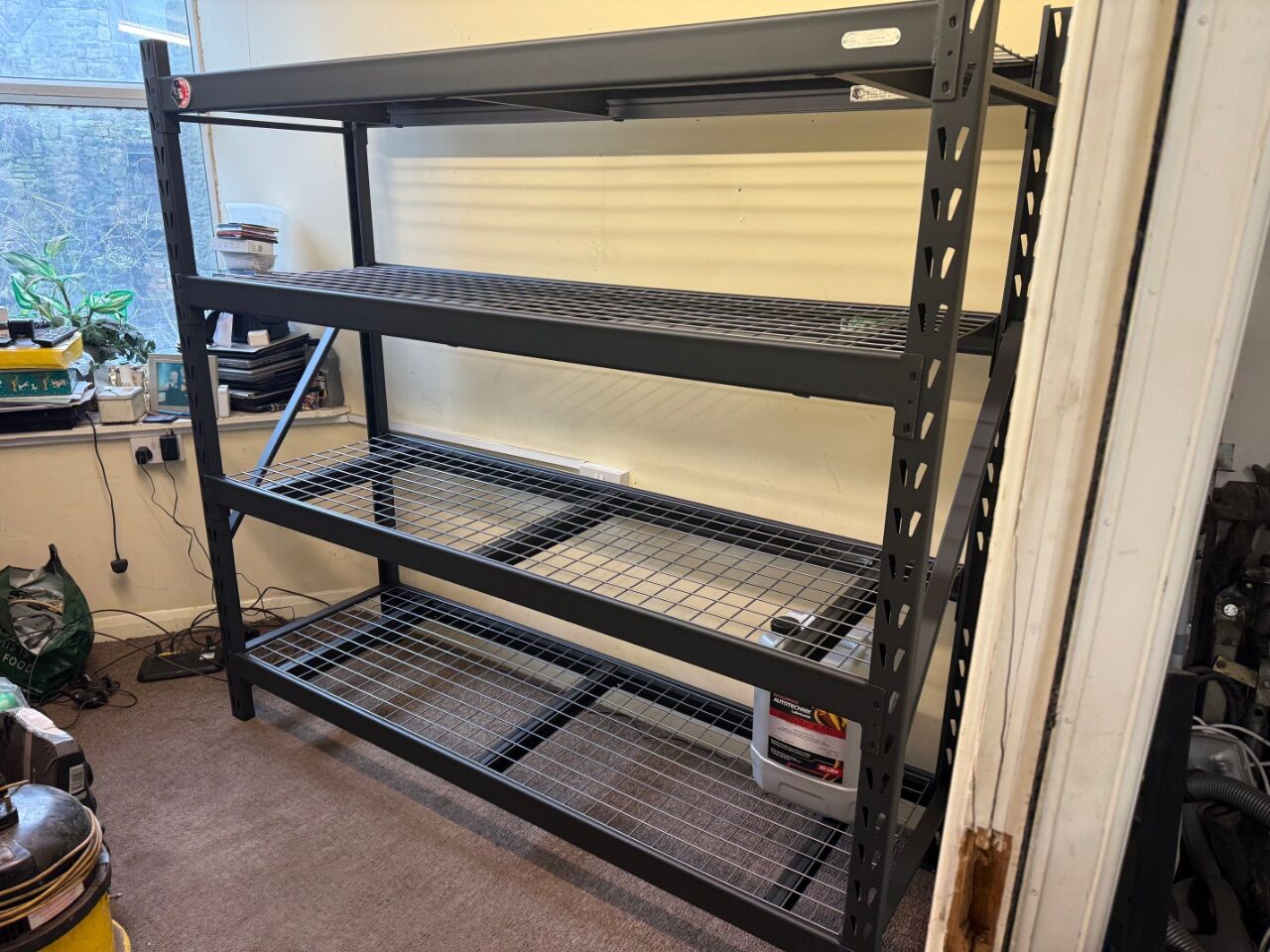

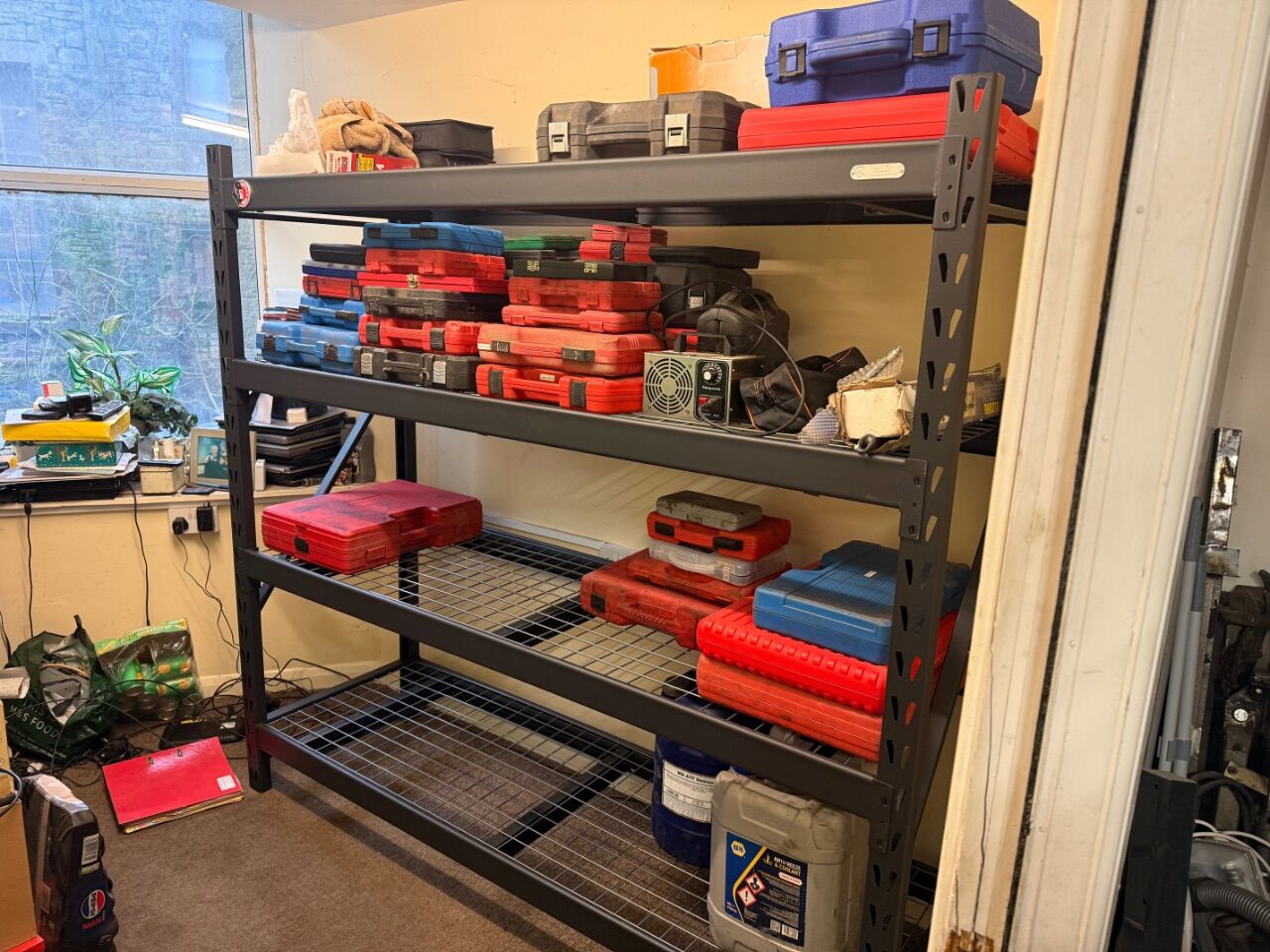

More workshop than car related but if anyone needs any substantial racking, these are currently on offer at Costco until the 15th for £99+vat
Properly heavy duty compared to the Chinese crap online and expandable too.
Trying to justify in my mind buying another couple for the main workshop!
Don't do it. The more shelves you have, the more stuff you buy to fill the shelves.
Then you can't find the stuff you want and have to buy more stuff.

I've got those, or if not those exact ones, they are very similar. Mine were load rated to 900kg. Per shelf!! I could basically disassemble both of my cars and store them on there. In fact I had a good go with one of them 🫣
