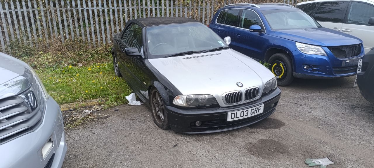

I spotted an ad for this 2003 BMW E46 Convertible on FB marketplace this morning. It was in Gateshead and we were heading that way today anyway. I quick exchange of messages happened and I got the Range Rover ready.

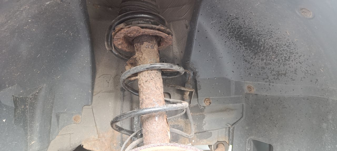

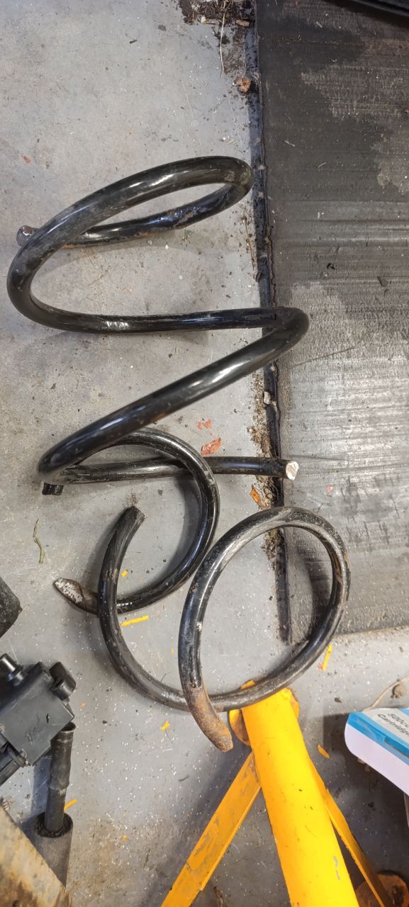

An hour later and I've arrived at a garage run by a Jewish family. The car was a customers car and snapped a spring, as BMWs like to do, which tore up the front right tyre, basically stranding the car there.
Apparently before those events the bonnet must have popped open (while driving), the garage owner replaced it with this silver one (probably in an attempt to make it a little more presentable). The windshield had already been replaced. Fine specimen of an E46 then.

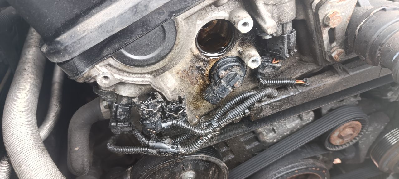

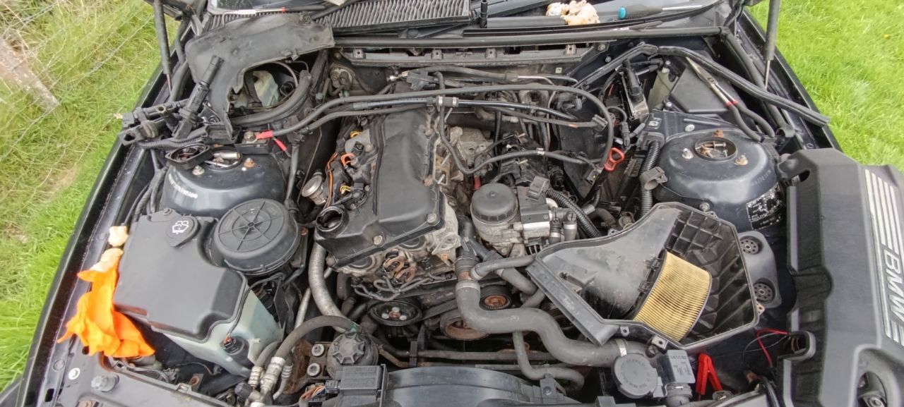

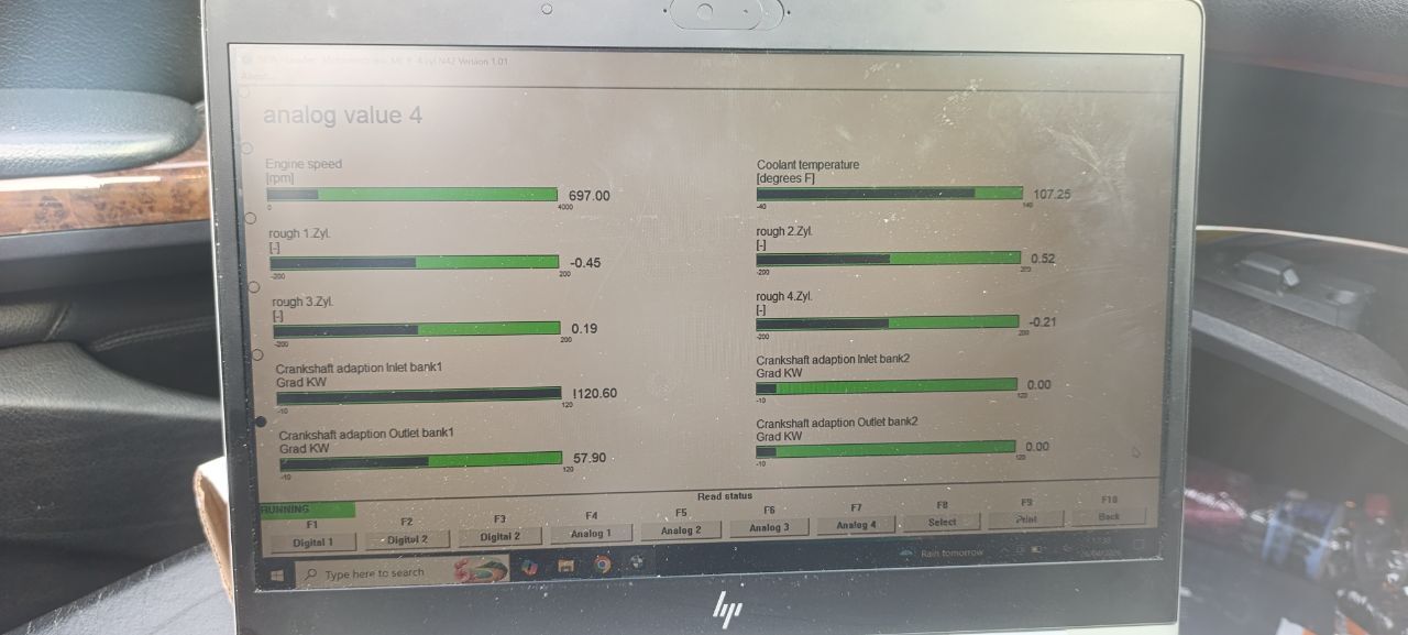

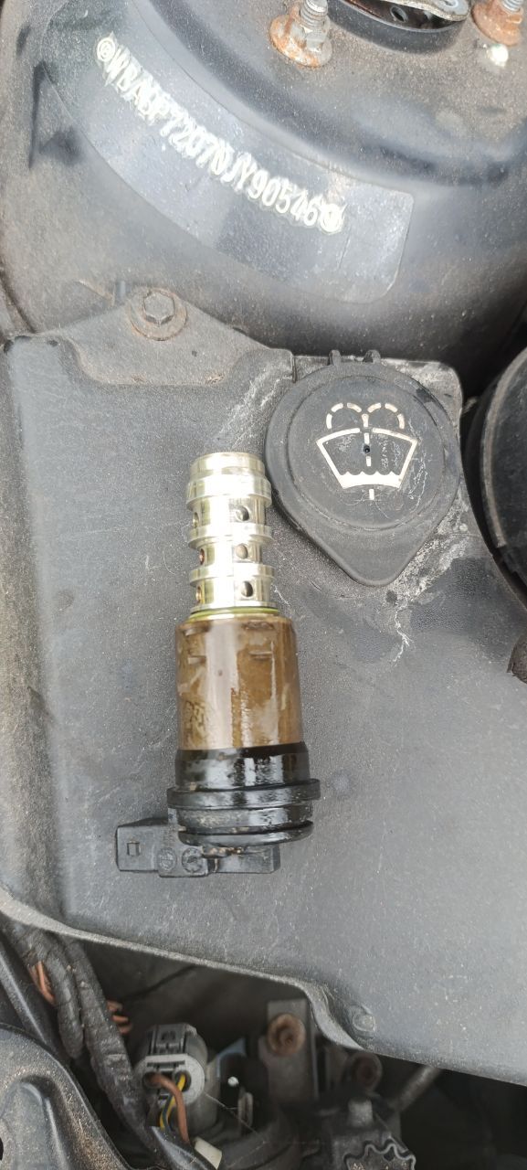

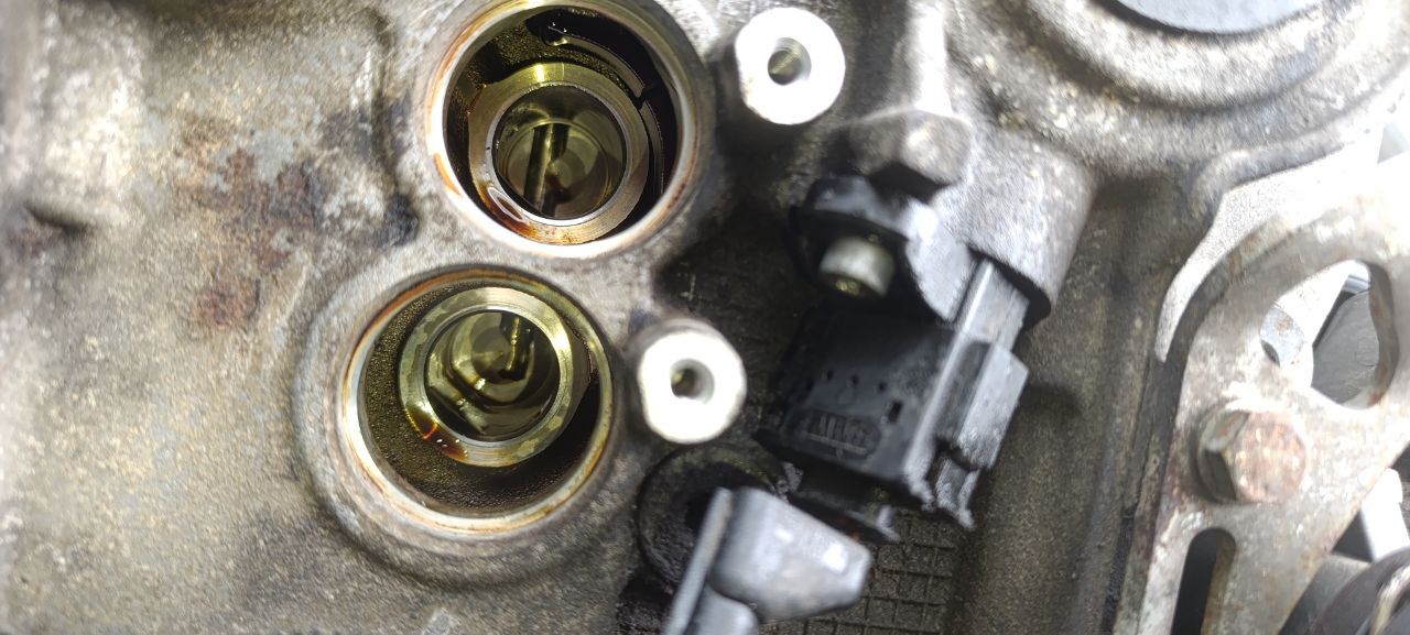

I hooked up inpa to see what the CEL is about. Looks like the canos is adjusting the intake valve timing to the absolute maximum it can do. Looking at the vanos solenoids they've probably never been cleaned in there life so before I even start replacing that spring I'll probably pull them out, clean them and replace the seal rings. I'm hoping that's the cause of the issues im seeing right now.
If anyone has any other theories why it would be that far out of whack, let me know. I've already switched the cam position sensors around, same results.

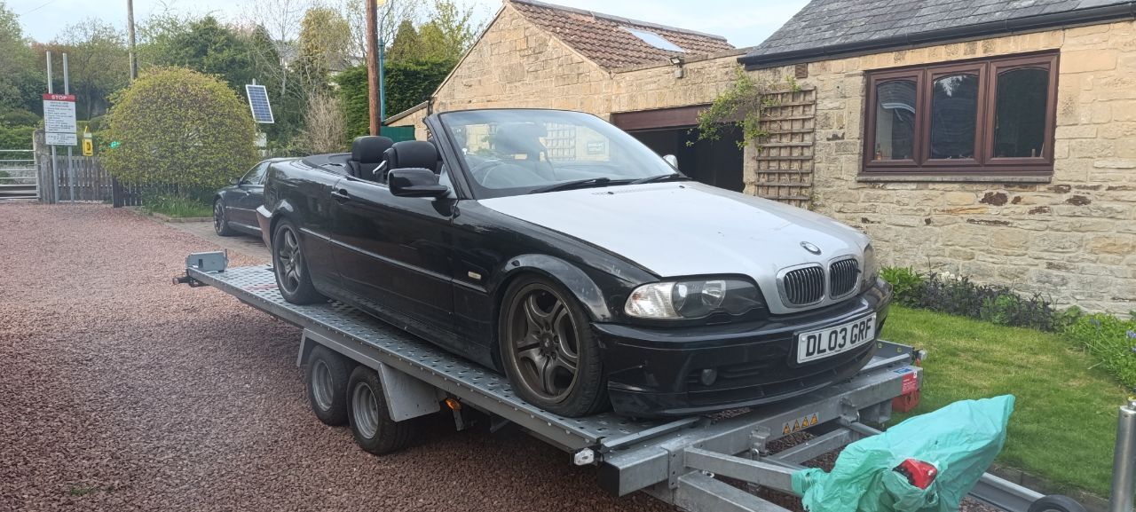

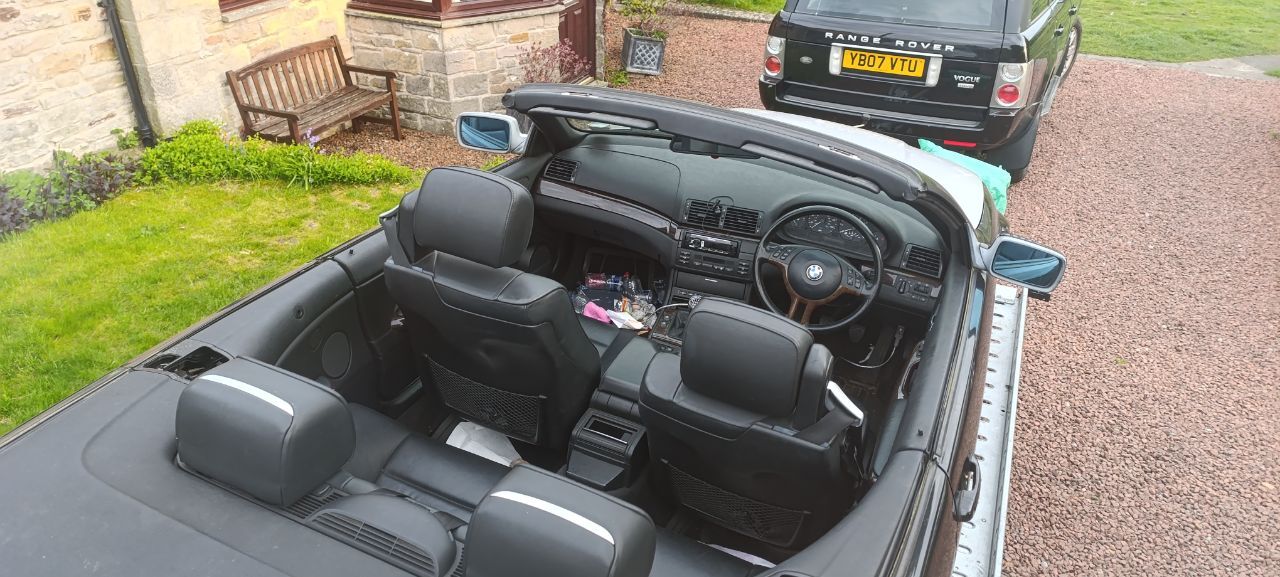

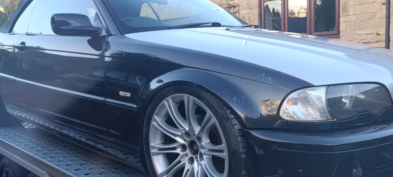

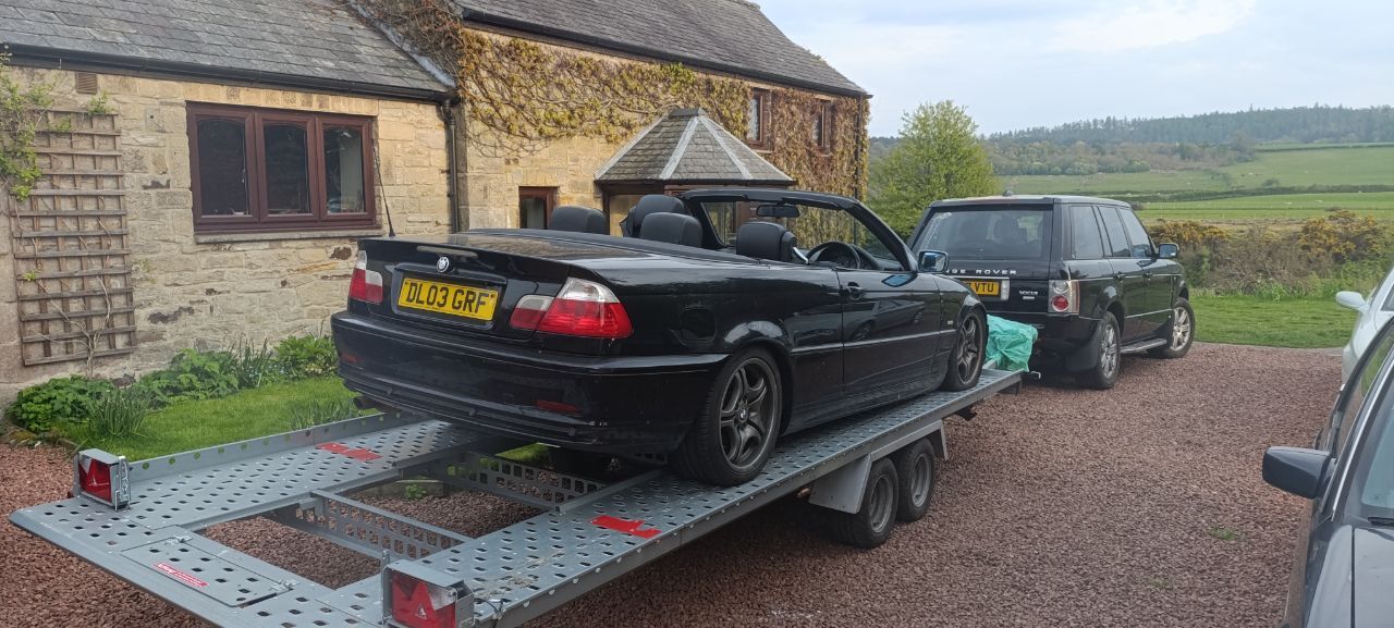

Appreciating the comments! Have some photos with the roof down:
IMG_20260426_190101.jpg.314ac8dabb6d7c765a4c863c019dc5d8.jpgIMG_20260426_190112.jpg.a2d566abaa78c15367c36f323d5c3d51.jpgIMG_20260426_190122.jpg.c1bdd316e0104e2c5ba6159530cb2bb0.jpg

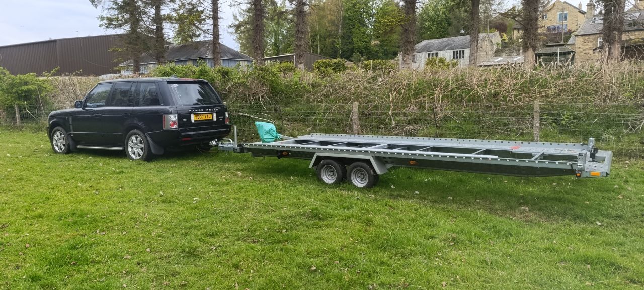

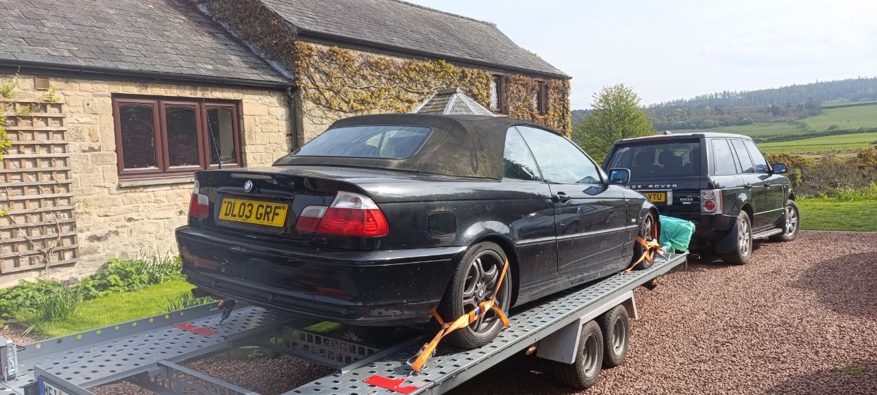

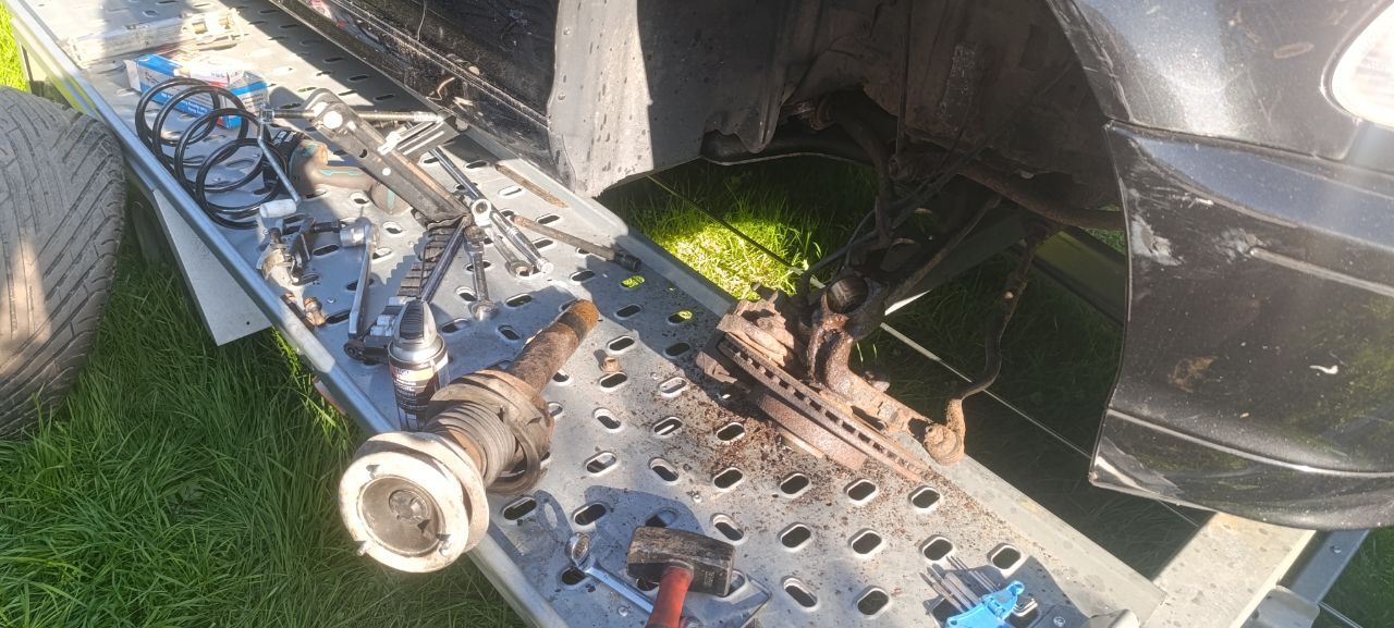

Since the flat tire and snapped spring prevents it from going anywhere a plan was conceived:
The trailer makes a great ramp btw.
Yeah that'll be the problem.
Ended up cutting the remains of the spring. Once again the Dremel proves to be one of the best hand tools you can have.
Slammed yo. Fortunately my parts E39 came with this random E46 MV2 tyre seems to hold air. It's still hardly movable but at least I can get a jack underneath there now.

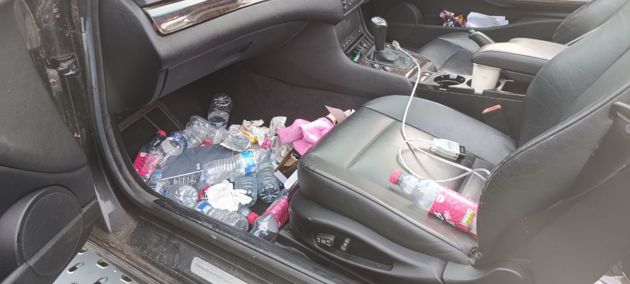

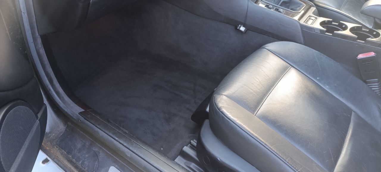

Have another look at the state of the interior...
Only quality motors here at bargain barge extravaganza...
