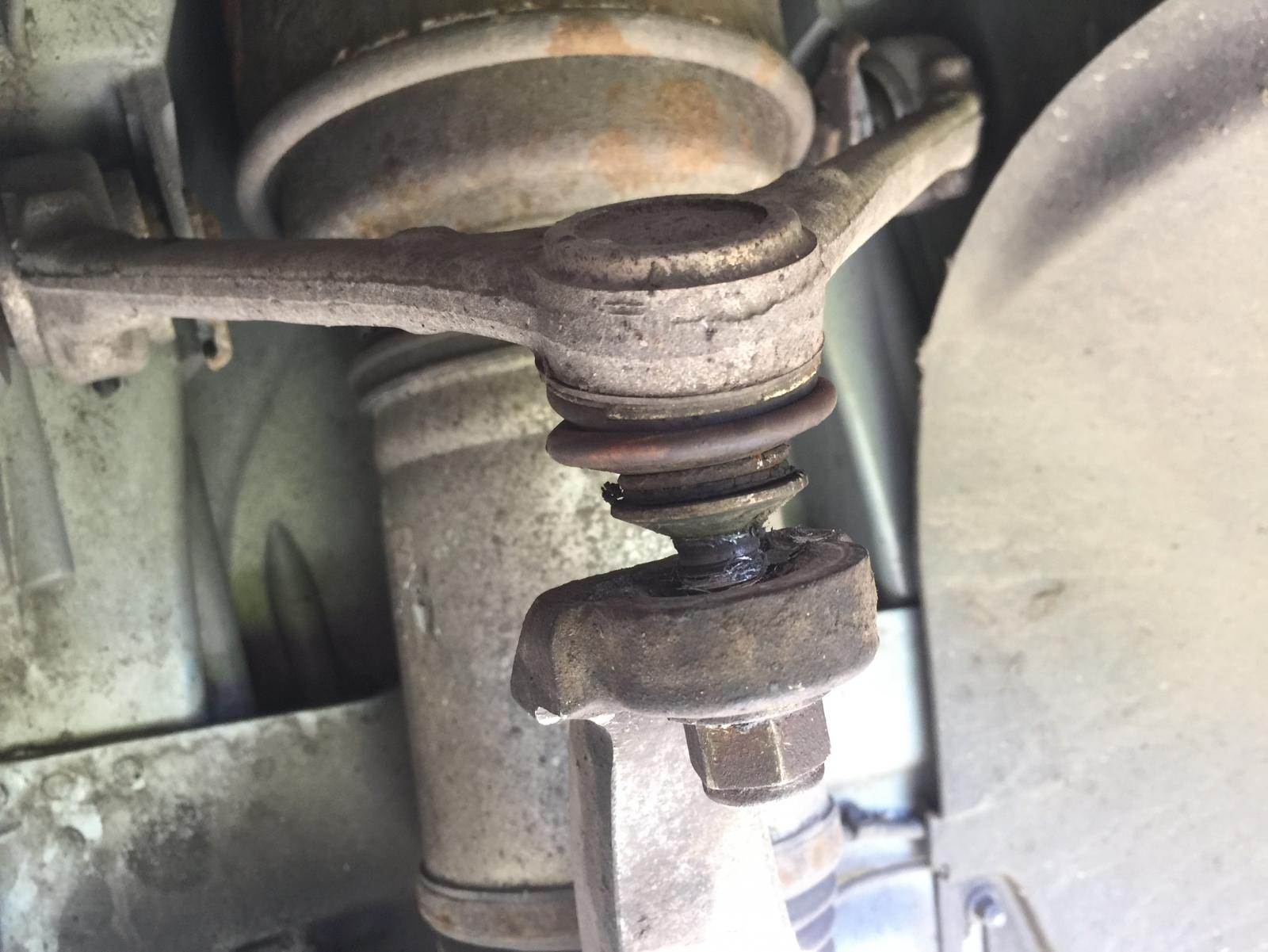

AMC Rebel Posted October 9, 2018 Author Posted October 9, 2018 Curses - can't get the balljoint off as the hex is now rounded and nothing to grab to stop it turning.
dieselnutjob Posted October 9, 2018 Posted October 9, 2018 If you can crush it into the taper with some water pump pliers or a G clamp then the taper will hold it still enough to get the nut off.
motorpunk Posted October 9, 2018 Posted October 9, 2018 Curses - can't get the balljoint off as the hex is now rounded and nothing to grab to stop it turning. Have you tried leaving it in rice overnight? (My new smart-arse answer to all technical problems) Lacquer Peel and AMC Rebel 2
AMC Rebel Posted October 11, 2018 Author Posted October 11, 2018 If you can crush it into the taper with some water pump pliers or a G clamp then the taper will hold it still enough to get the nut off. Tried that - with water pump pliers, g-glamp and mole grips. Have you tried leaving it in rice overnight? (My new smart-arse answer to all technical problems) No I did remove it in the end by cutting it off with an angle grinder. In typical shite-fiddling style, I found I needed a Torx T60 bit for the lower shock mount - in an atypical development, the bolt came undone OK. Now in the "assembly is the reverse of dismantling" phase. I have zero hope that the noise this was supposed to cure will be cured.
