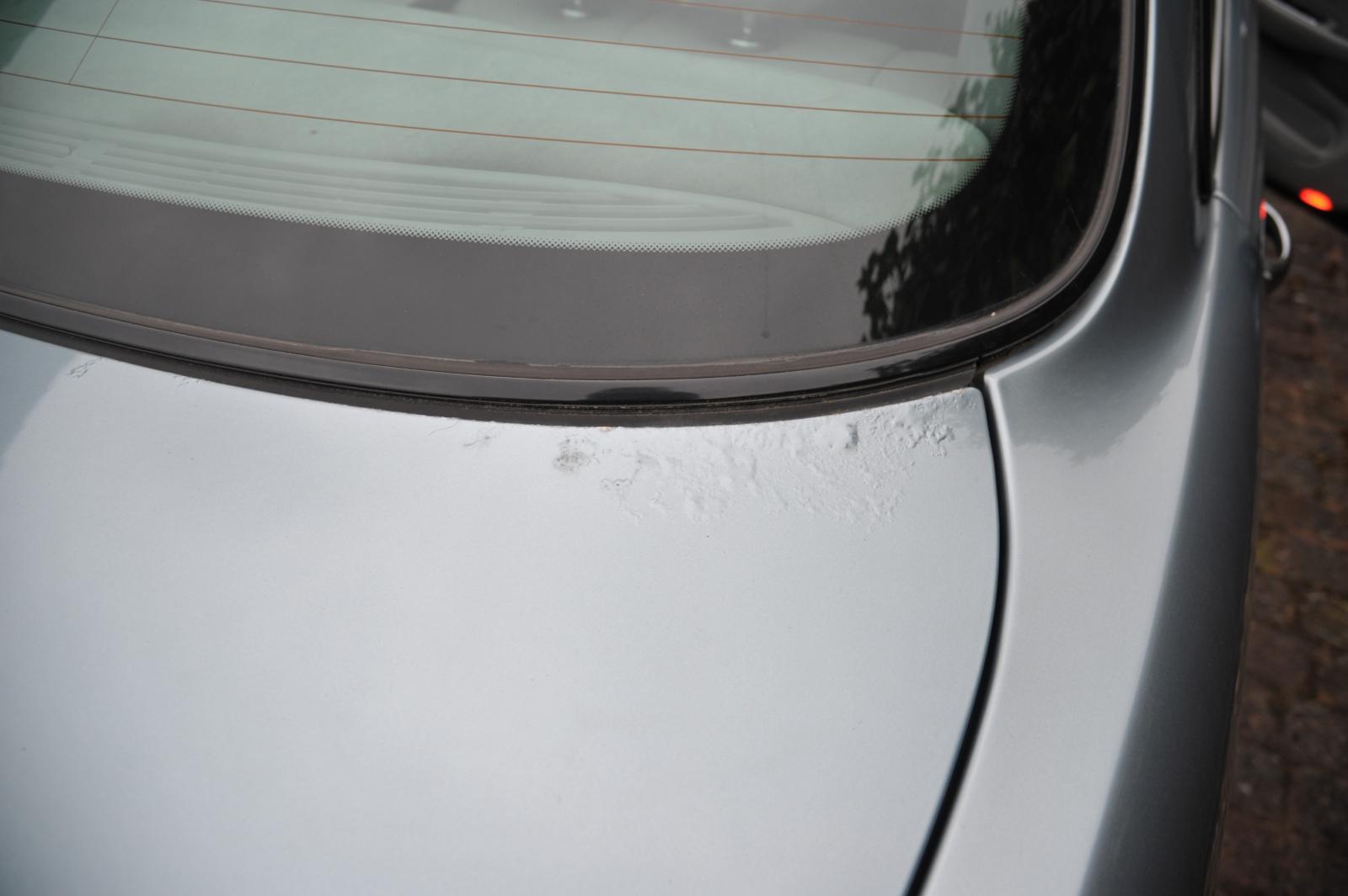

Partridge Posted June 29, 2017 Posted June 29, 2017 If these are all alloy, is that just a case of the paint reacting with the alloy rather than body corrosion? pics -DSC_0172.JPGDSC_0173.JPGDSC_0174.JPGDSC_0175.JPGDSC_0177.JPGDSC_0178.JPGDSC_0180.JPGDSC_0181.JPGDSC_0182.JPGDSC_0183.JPGI'll be following this thread with interest, being a Jag man myself
AMC Rebel Posted June 29, 2017 Author Posted June 29, 2017 Dunno about the corrosion - it's really not bothering me - it's not galloping rot like it would be on a steel car. flat4alfa 1
dieselnutjob Posted June 29, 2017 Posted June 29, 2017 I would say that it is the paint unsticking rather than corrosion. The folding mirrors are an easy fix. You pull off the downlighter bulb holder underneath the mirror and then spray oil and then spray grease into the mechanism whilst working it backwards and forwards. HID headlights are as likely to be the ballast as the bulb. Also they suffer from dodgy earth points where all the wires are attached to the body just behind the headlights. Swap the bulbs over left to right. If the fault moves with the bulb then it's the bulb, if it doesn't then its the ballast or earth or something. The V6 is probably the one to have and on LPG it will be cheaper to run than the diesel and a lot more robust. A tatty V6 X350 on LPG has to be the ultimate cheap daily. Also you have 18" Dynamic wheels which give the best ride whilst being the best looking 18" wheels that they came with. AMC Rebel and uk_senator 2
