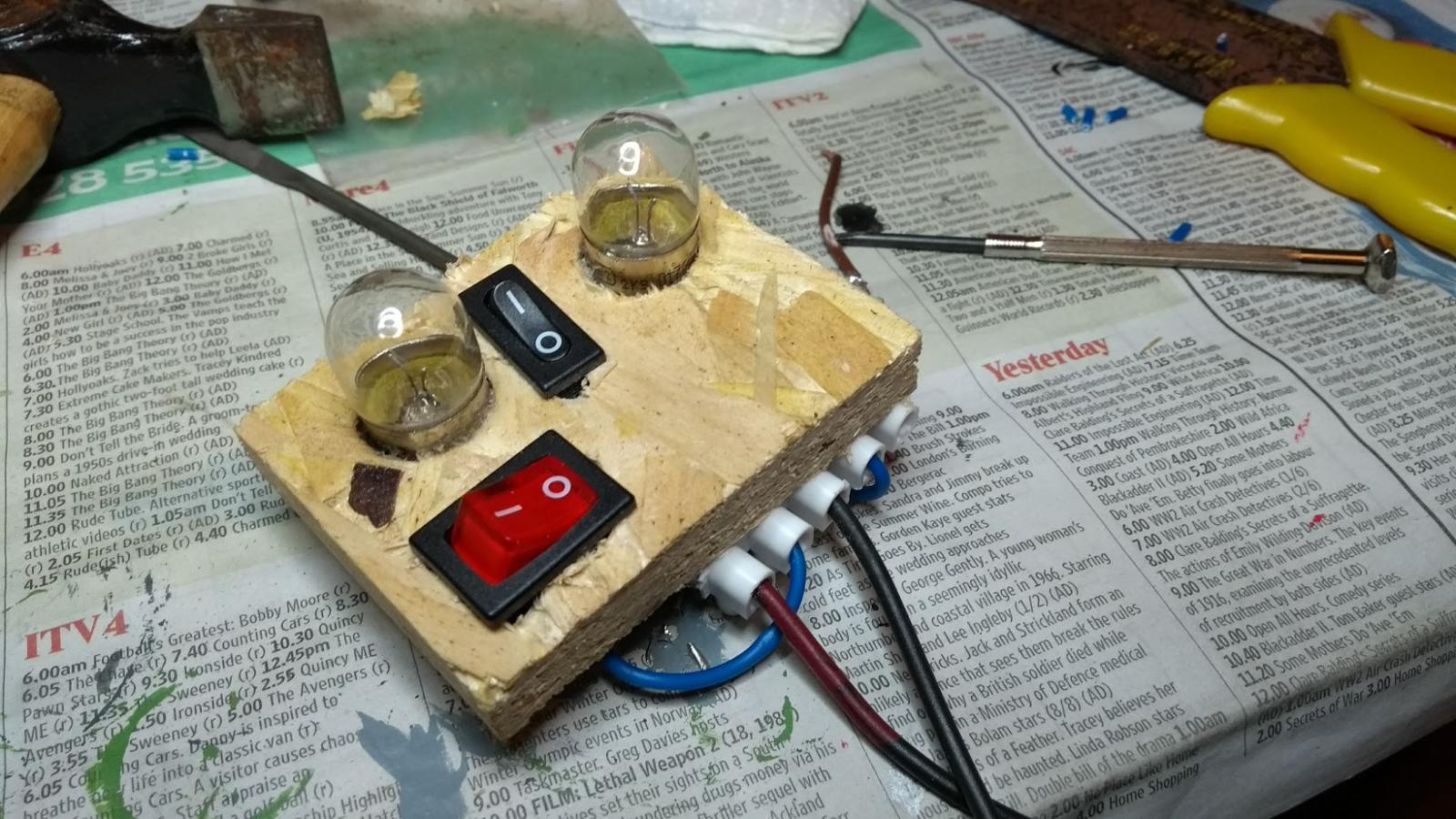

Lets say for example that your Suzuki was not starting because the bit in the distributor was being as much use in providing as spark as a wet fart in a hurricane.
You phone Aldon Automotive, suppliers of things like this and ask them if they have a counter open on a Saturday.
'Not this Saturday mate, what you trying to fix?'
'I'm trying to work out if an ignition unit inside a dizzy is dead or not, I only get open circuit.'
'You want to line it up with a bulb, knock it across 12v, turn the dizzy, if the bulb does the light house dance then it's good.'
So today I made a test rig.
1 bulb on 3.3 Ohms, for high resistance coil sim
2 bulbs on (parallel) 1.9 Ohms, for low resistance coil sim
Yes my soldering is that shit
It's dark and wet now, testing can wait till tomorrow.

Tests completed, distributor electrics very dead. It was passing no current even with 12.5V hooked up across the terminals. I will be contacting HH in the morning.

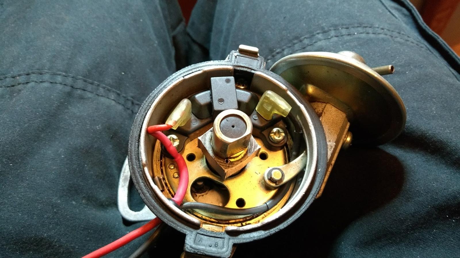

1. I sent the dizzy to HH they said all was well

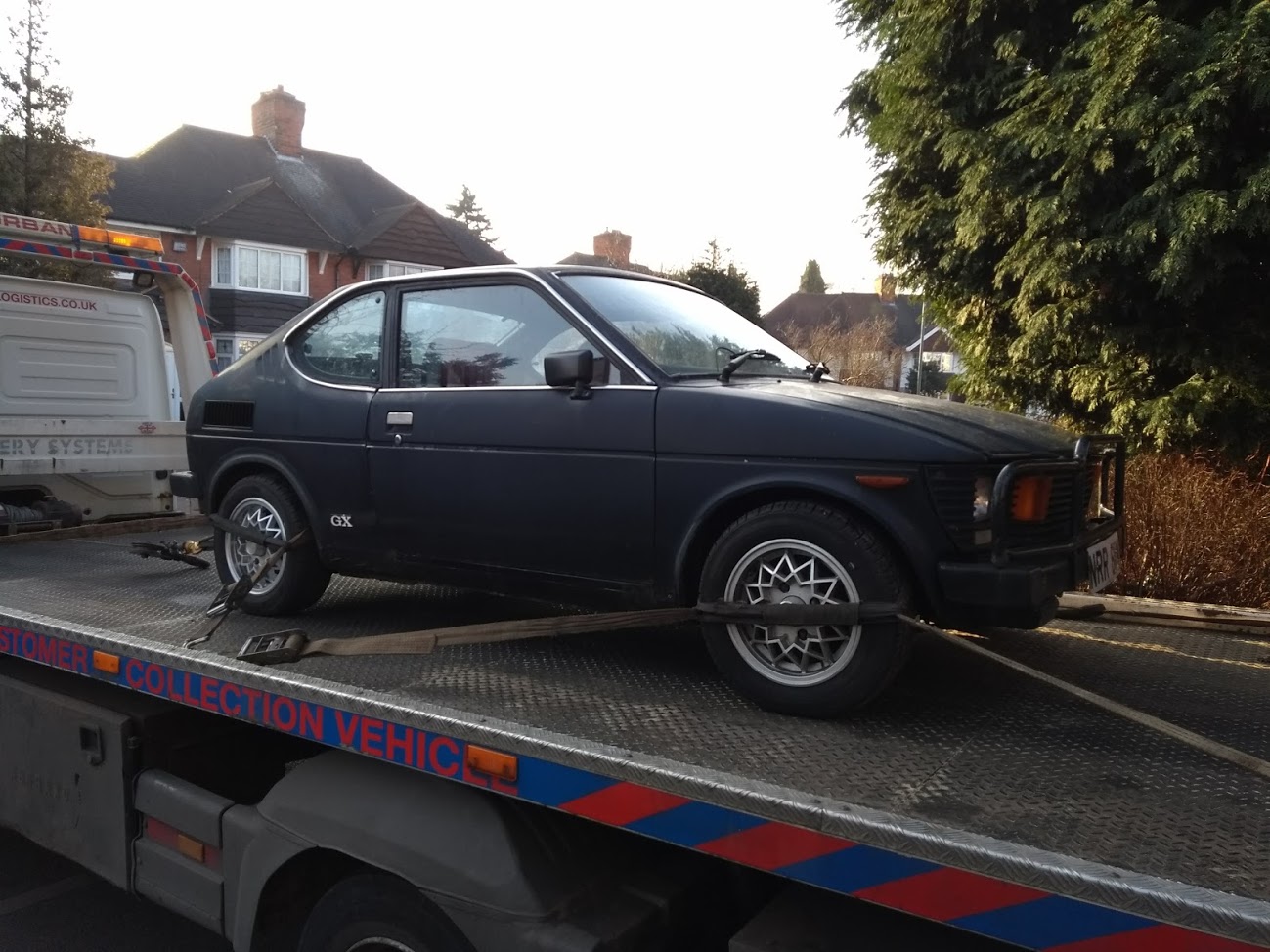

2. I started a garage share in Tamworth with a few other shiters got the Wizzkid transported
3. I tried wiring a second battery to the electronic dizzy in case it needed more volts than the Wizzkid could provide while turning a starter.
I also added some much needed fresh fuel to the tank.
It still didn't want to make a spark.
Spot the epic wiring skills
4. Finally I bit the bullet and ordered a new old school, clockwork, dizzy from India, it arrived yesterday.
My initial timing was early by 30 degrees (one tooth on the helix), then I realised what I had done and got.
VID_20180415_152510694.mp4Fetching info...

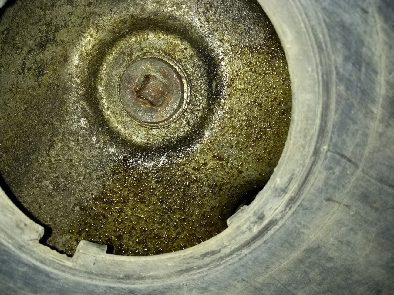

It's service the Renault day so I'm happy heading to shitefest and beyond.
So the usual oil, oil filter, air filter and a plan to replace the rear brake pads as the current ones make noise that they shouldn't.
Jack up front of car, locate hole in the undertray to get to drain plug and try to find an allen key to fit, none do. Try some of those torx things, nope.
Take a picture of the hole that I am trying to put things in, to see what the correct shape is, bugger.
Fortunately I had left the backup plan in the workshop. Which cleared over 3 litres of old oil out the sump.
Aldi oil pump to the rescue.

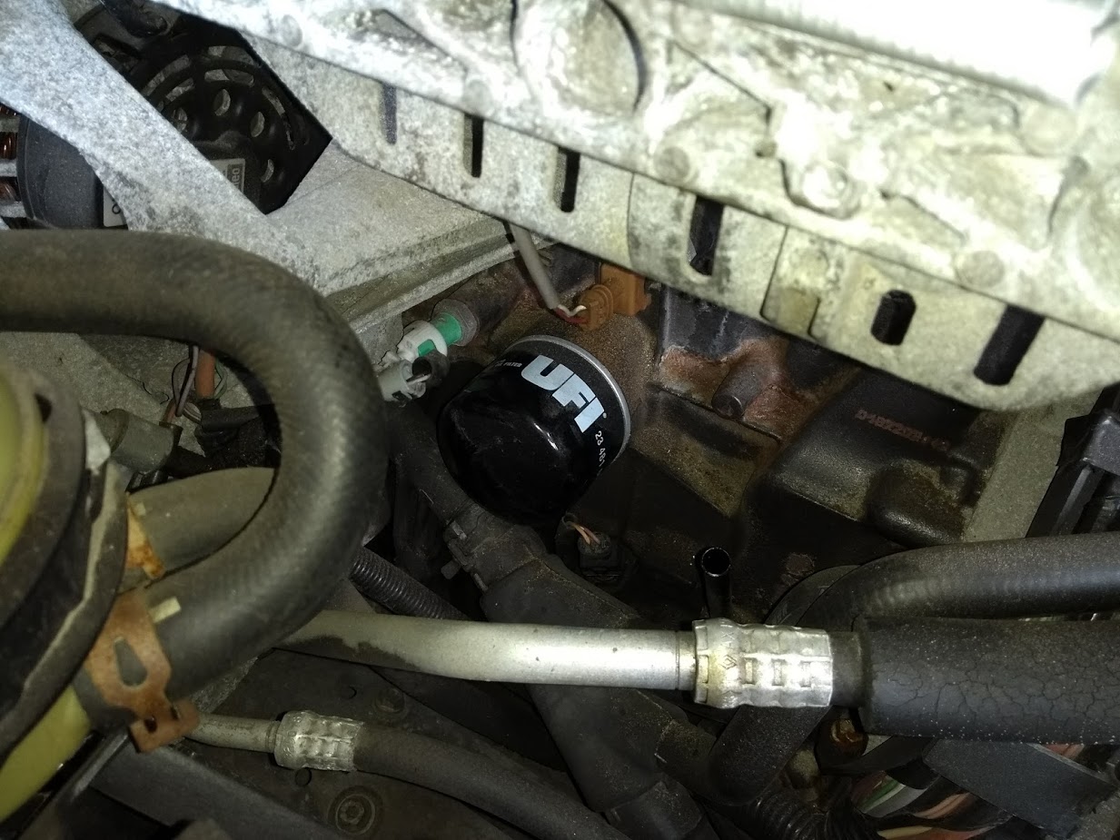

I thought the oil filter was going to be a pain to remove as they almost always are in my experience
post-17488-0-18328400-1526234054_thumb.jpg.
but no, with the right tool it moved very easily and the appropriate replacement was inserted.
next top up with oil, 3.5 litres in the engine and a hundred mil all over the engine cover.

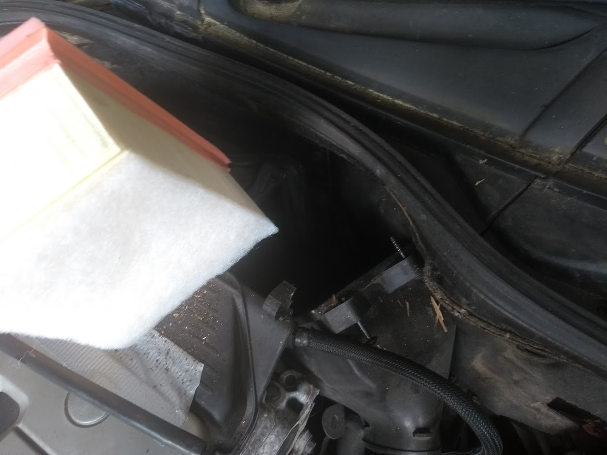

now for the air filter, does it go in this nicely accessable box here?
No, it goes in this sod behind the engine.
Where you have to squeeze it though a gap left several mm too small in every dimension for the filter to go in, by the thoughtful designer.

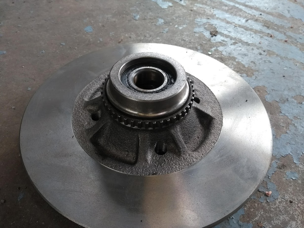

A bit more pre-shitefest planning saw me get a pair of new disks for the Megane.
So I drove it to the workshop, took off the old disk and swore.
The expensive disks have the ABS rings attached, the very expensive disks also come with bearings in place.
My disks were cheap and so had neither of these optional* extras.
Fortunately Tommotech has the power, skill and a big press.
So bits were switched over, saving me a small fortune.
New disk looks shiny on the car
A definite improvement on the old shite and much thanks to Tommotech for skills, advice and equipment. A few tweaks still needed on this baby GT but, it's nicer than when I bought it.
