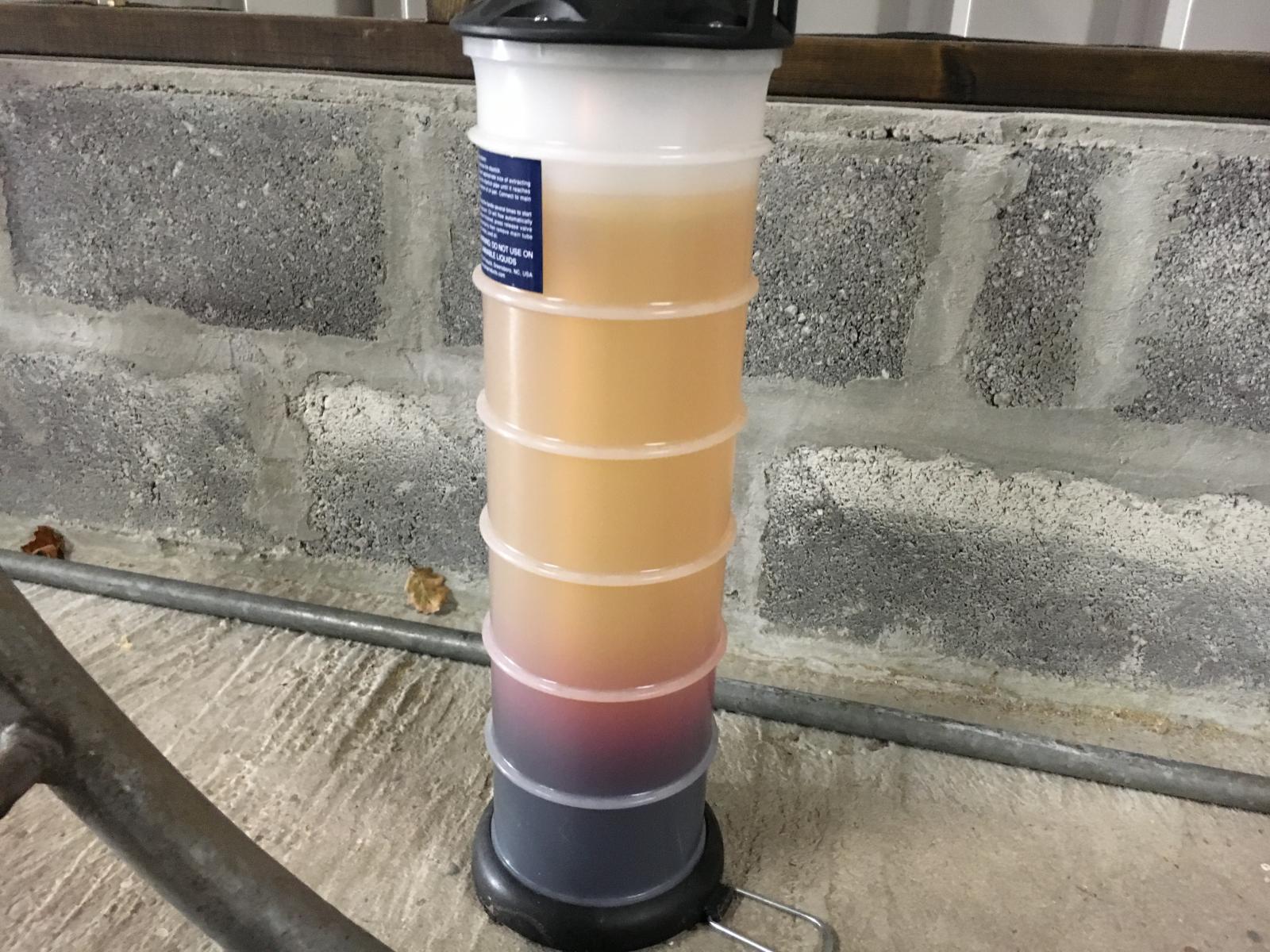

Mine is actually in my good books today: Dermist (occasional poster and serial Lancia owner, including my old barn-found Dedra) and his mate Greg (an Escort/Cortina man but otherwise sound) came over last weekend to do a bit of car fettling, and did a bunch of diagnostic work ont the Gamma.
Long story short, my replacing the ignition module has restored sparkage but lthe cold start injector was leaking, various contacts were very dirty and the fuel is horribly stale.
We siphoned off some fuel with a Pela pump (that’s Jeep PSF at the bottom but it’s still yucky)...
...and put a can of fresh petrol in but, with the cold start injector isolated from the fuel supply to stop it pissing petrol everywhere, it was still no go. We did a compression test and that was fine, and we got a bit of a cough on EasyStart so figured the timing was fine and it hadn’t lunched any valves. I didn’t think this was likely but various Lancia types said ‘ooh, Gamma, that’ll be the belts then.’
I tracked down a replacement injector on German eBay (about 65 Eurobucks secondhand, it’s about the only variant Bosch doesn’t still stock OF COURSE) and fitted it today.
IT RUNS! Well sort of - it runs like shit for about 10 seconds then stalls but that’s the stale petrol. I can easily sort that out. There’s a video but it’s a pain to upload so here’s a still of me concentrating extra hard, or possibly swearing.
