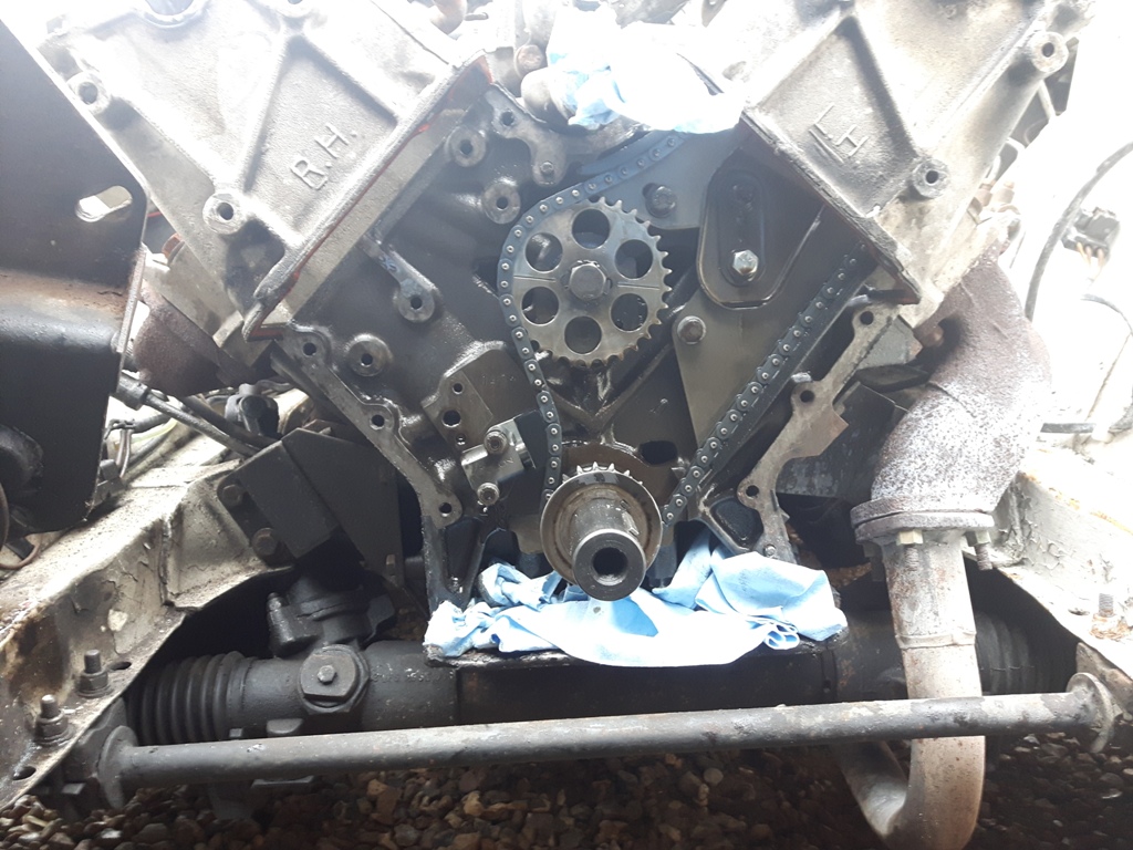

The distributor and water pump are driven by a jack shaft from the LH cam chain. on the bottom of the distributor shaft is a gear and hole for the hex drive to the oil pump.

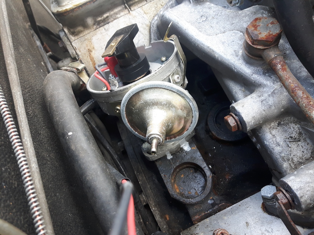

Did a roadside dissy baseplate removal and found two issues.
This crud was jamming up the bobweights and even though the engine wasnt pinking and didnt explode etc ;) they were not helping, thermostat was also removed and replaced with a spare that I had.
I guess that they have come from the inside of any of the distributor caps that have been on the car over the last 40 or so years
the second issue, I had a Piranha Electronic ignition system. It sits on its own baseplate and the vacuum advance moves the optical sender back and forth on the base plate. only mine was sticky, had worn a ridge. I loosened the securing screws a tinsey bit and lubed it using the dipstick and popped it all back together in 30 degrees and on a very hot engine it was not a pleasant job.

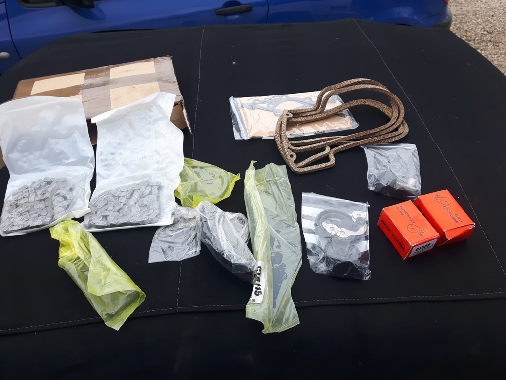

I have just fitted German chains to mine which are a kind of fit and forget, well until you need to replace all the bearing shells again that is, the journal issue is not so much the diameter as the width, and short of building a new longer stag v8 that wont work.

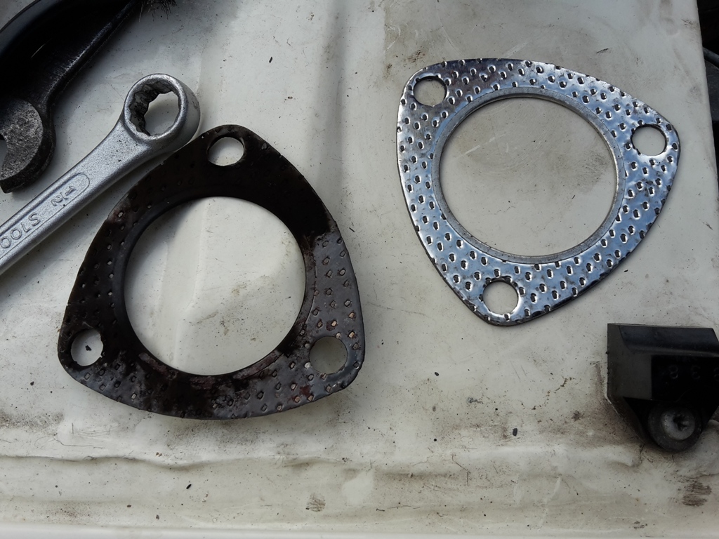

After LeMans and filled with enthusiasm I needed to fix a couple of things. First the RH Exhaust was blowing.

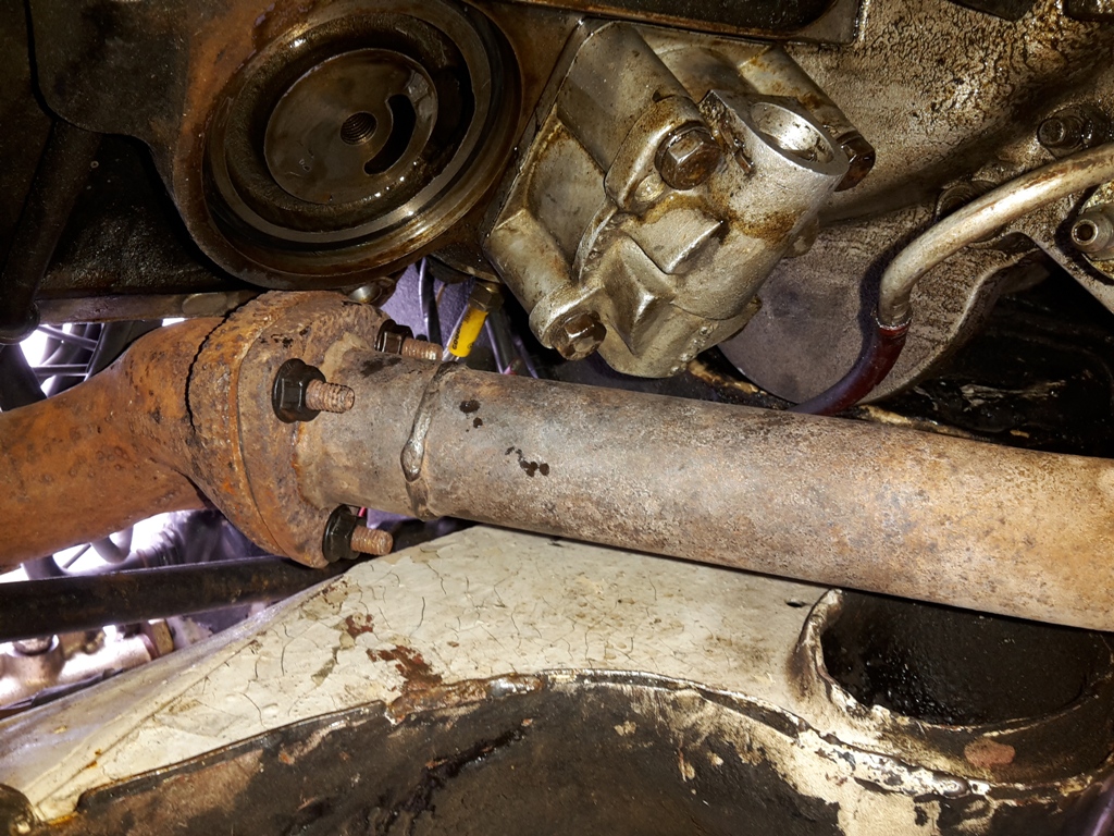

Thought it was the downpipe gasket -
On removing it showed very clear signs of blowage
All a bit tight on the RH pipe because of oil filter which has to be removed to allow access, steering and oil pump
Did it fix it? Did it fuck
Next removed the manifold from the head which is a right arse ache, everything is in the way
Ok gasket looks knackered. must have been hot running that did that

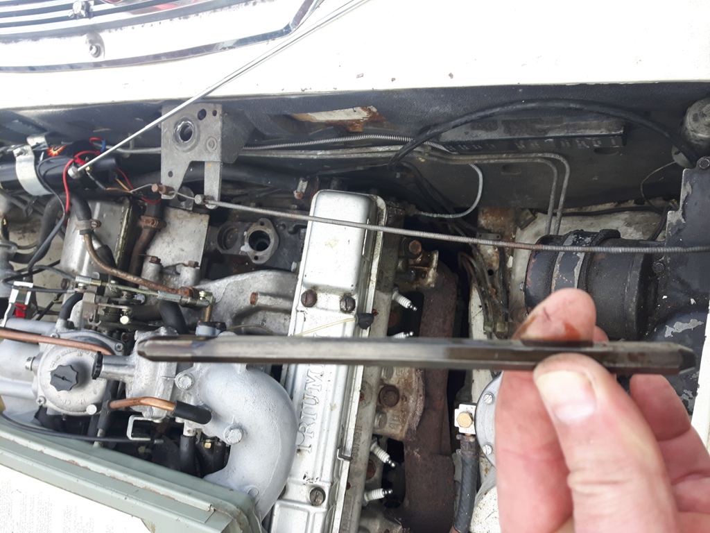

then just before putting it all together again I noticed this.
another manifold was found in the man cave, studs moved about and itb was fitted
Nice quiet blow free manifold again
One job fixed, next up ignition
My distributor was probably original to the car, when I first got the car it had its factory supplied engine, I moved ancillaries onto the rebuilt engine and have never really touched the dissy aside from a dot of oil and piranha ignition install years ago.
Old unit needed a new vacuum advance module, needed the ilectronic ignition renewing, I think I had my moneys worth out of the old Piranha and I could not get a chopper for love nor money. The shaft had slight play and so...
I bought a recon unit for not much more than the cost of the parts, included were shit cap and rotor which I sent back with the old dissy to partly cover the fact that the original stag base-plate was missing.
The dissy included an accuspark ignition module just wire it up to the coil and away you go
install was easy and ignition timing is now consistent and correct

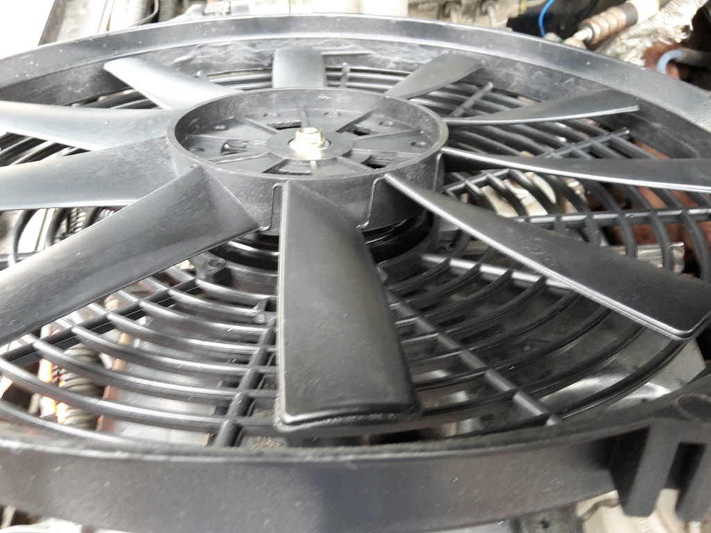

I also bought a cheap electric fan to give the viscous fan a boost. it is still on the shelf
To check the viscous fan you grib the blade and try to spin it 1/4 to 1/3rd spin is pass anything over 1/2 spin is bad. Mine was around the 1/3 mark so I ignored it. until one day when it was all hot and bothered I gave it a spin and it when right round! one full revolution. so the viscous fan is dead

next job for the spring was to change the standard timing chains for "improved" German chains. Standard JWIS chains stretch through their life and when they start rattling they need changing, this can be anything from 20k miles upward. My drivers side chain rattles on start up which pisses me off as I only installed the bastard in 2013. Still I can fix that sump gasket leak while I am at it, oh and back flush the radiator.
German chains are prestretched but are better quality and the assumption is that they outlive the life of the crank bearings, so become an engine rebuild item rather than a service item.
First step, remove bonnet - a two man job, bonnet goes upside down on softtop for parts storage
Here is the Germain chain kit, less the sprockets which I am sure are fine on my car

First check, using endoscope down the RH head was to check the tensioners which both looked fine
Then I marked up the ignition
so the distributor could come out and I could check the oil pump drive
which was still hex shaped at both ends - they can fail
next was to find the pump anticlockwise on my cordless to see if I could get oil pressure, bear in mind that on the starter the engine can wind up 45psi from cold. I was disappointed at 20psi.
maybe the pressure relieve valve on the pump is jammed open, not unknown
the pump is quite accessible once you get under the car, remove the oil filter and the RH exhaust downpipe :D
Took pump apart, no sign of any issues and wear was well within tolerances.

I decided to crank the engine over, ignition disconnected and lookee whatee happened
Clue RH chain which is on the left of the picture should be tight against the guide to the left of the jack sprocket in the middle of the pic.
The chain guide must have come loose, no idea why unless bolt wasn't tight enough or chain tension was too tight. Locked it up until I have time to dig deeper which I did tonight.
Pulled RH chain off, counted the links and yes it is the correct 104 link chain. looked at bolt threads and they seem ok. they wer 20ft/lb tight the tensioner is ok. just going to have to refit again and see what happens. Pretty sure this is root cause of oil pressure
