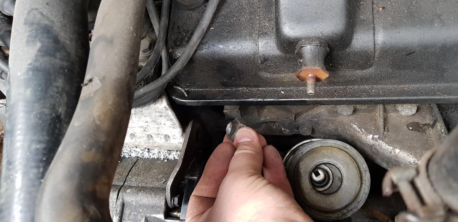

When I got home from work I decided to have a little fiddle with this again - See if I had any luck double teaming it with two nuts on one side etc.

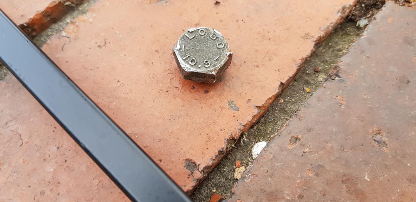

But of course the fucking bolt head snapped straight off with just medium power on a 17mm spanner.
10.9? Fuck off!
Obviously a mega soft bolt turned IMMEDIATELY into an incredibly hard bolt as soon as I got near it with a drill.
Four batteries, two drill bits and mild smell of melted plastic I've managed to drill about 20mm into the bolt. It's on the piss slightly but not as bad as it could have been and the entry hole is in the right place so it's all usable. It's a good job I've got the angle drill otherwise I'd have no chance at all.
I'd ran out of batteries and was getting really frustrated so I gave it up for the day, I reckon I'm going to try and pull whats left of the stud through the housing by tightening a nut on the end very tight, and then try and help it through with a hammer and a drift while keeping tension on the nut.
But what will most likely happen is I'll snap the other end of the bolt off too.
