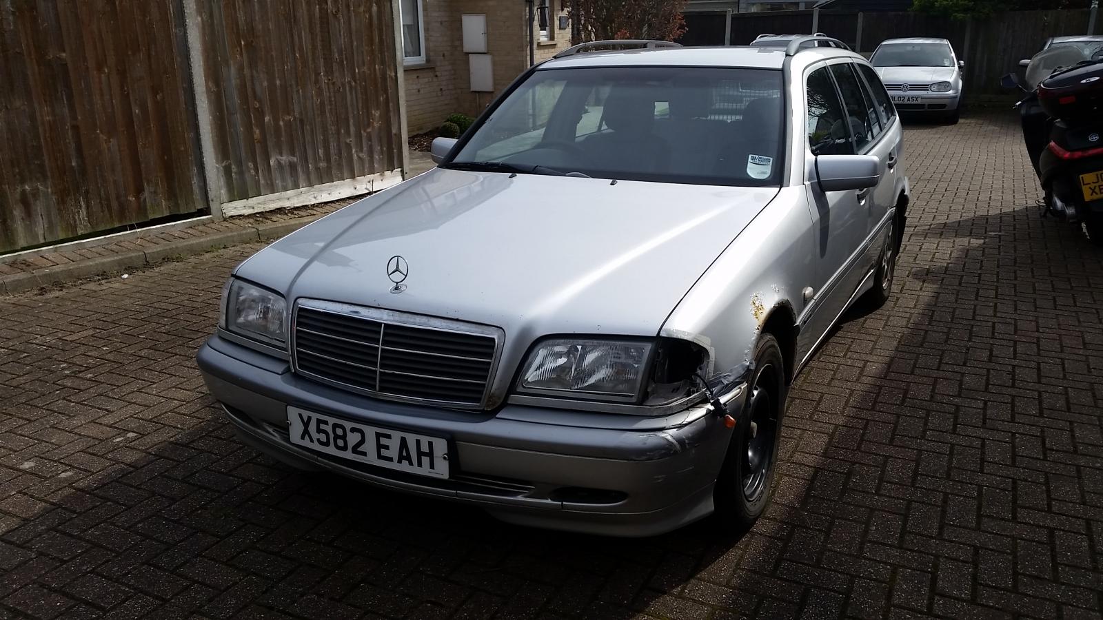

It drives really well although it doesn't look like it. A few hours cleaning it up (at least the inside-I quite like the filthy exterior).
Can't seem to load the photos as very poor sinal on my mobile here- unadulrated interior shots to follow once home.

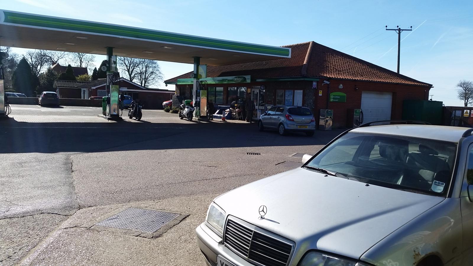

Pez shot (sort of):
Drove 110 miles or so home, and it's really good. Engine is quiet, rattle free and pulls well, auto gearbox changes smoothly, brakes and suspension all good.

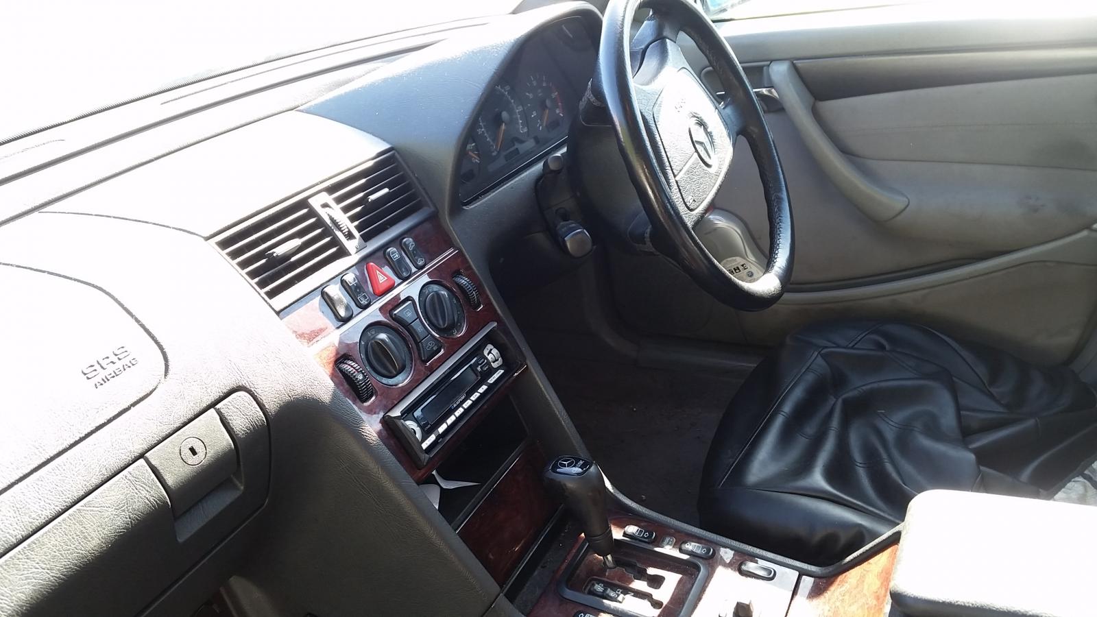

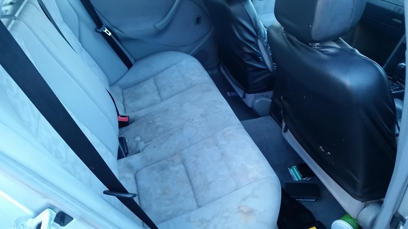

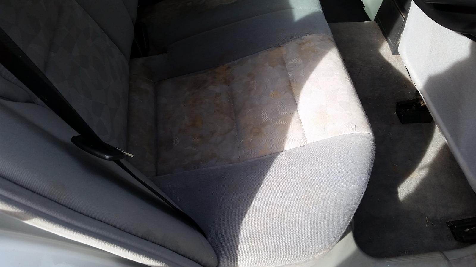

Inside is dirty, but better than I thought:

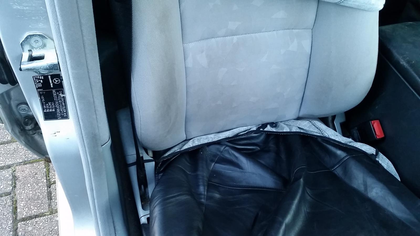

Front seats have covers on them post-19526-0-42399900-1490463984_thumb.jpg which have done their job, as the actual seats are dirty bit intact. Not many cars with over 216,000 miles on them without threadbare bolsters:post-19526-0-54558500-1490464103_thumb.jpg

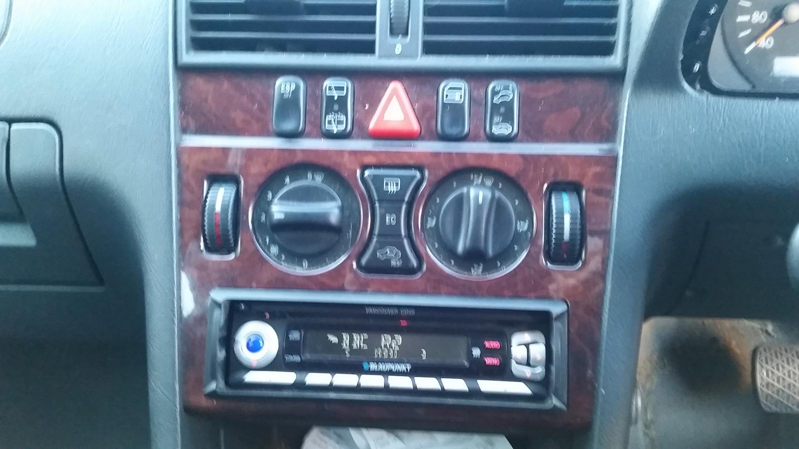

Even the "wood" on the dash has no cracks or crazing, and the radio sounds ok;

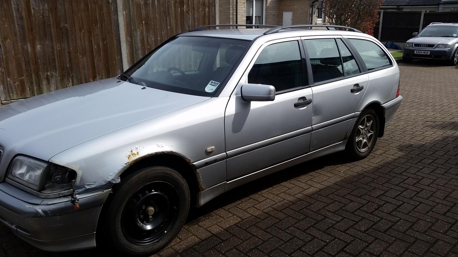

Had a poke around the outside and apart from the front wings, although a fair few areas of rust, nothing appears rotten-cills and jacking points all good. And most of the flaking paint has rust underneath, there are no holes. A wire brush wheel, a lick of Kurust and some rattle cans will stop the rot setting in.

After the tip, took it to the local jet wash to get all the muck off of it-not sure if I should have now, as it has exposed all its rustiness.

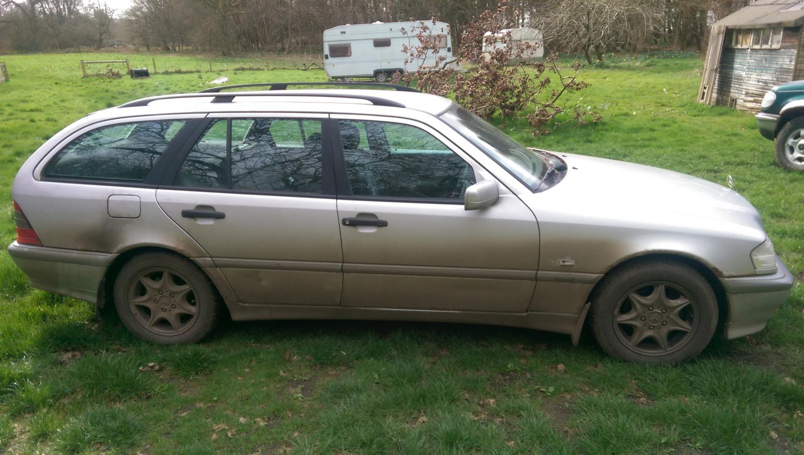

When I picked it up;

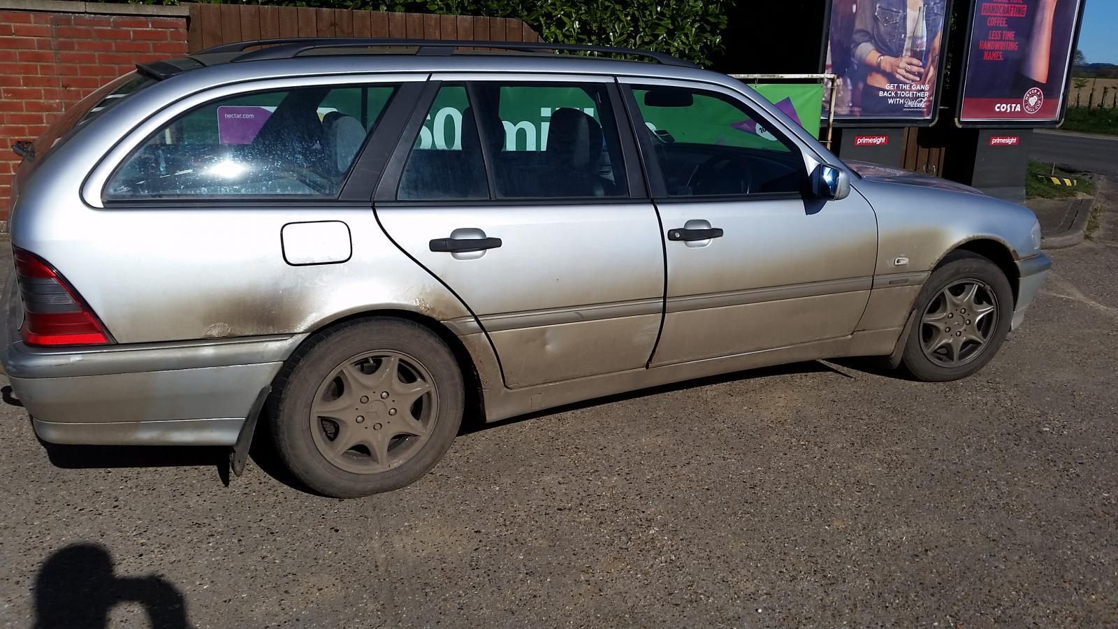

And now
Although it has exposed the expanse of rust, it is all surface rust under the bubblING paint. So I'll just rub it down and primer it and a few coats of rattle can silver. It will never be anything other than a shed.

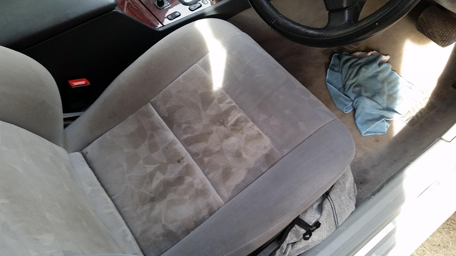

Had a go at the drivers seat.
Before;
No after shots yet-and to see if the stuff I purchased at North Weald market about 10 years ago works. Seems to have done but want to see what it's like when they are dry.
Two things have raised their ugly head-the brake pad warning light is flashing away, and I lost the front left indicator-my fault as I noticed it was loose when I went out. Looks sorry now.
Seats are drying nicely in this breeze;
Big difference and so quick-small bowl of warm water and a couple of capfuls of RAD shampoo applied with a small nailbrush. Took about three minutes to do this much. Hopeful that the inside will be a respectable place to sit in very soon.
Not sure mine is the same model Vantman-the headlights on mine are different. I think mine is one of the last of these models registered on a X plate
OK,i saw it was X reg but never noticed the headlights were different!

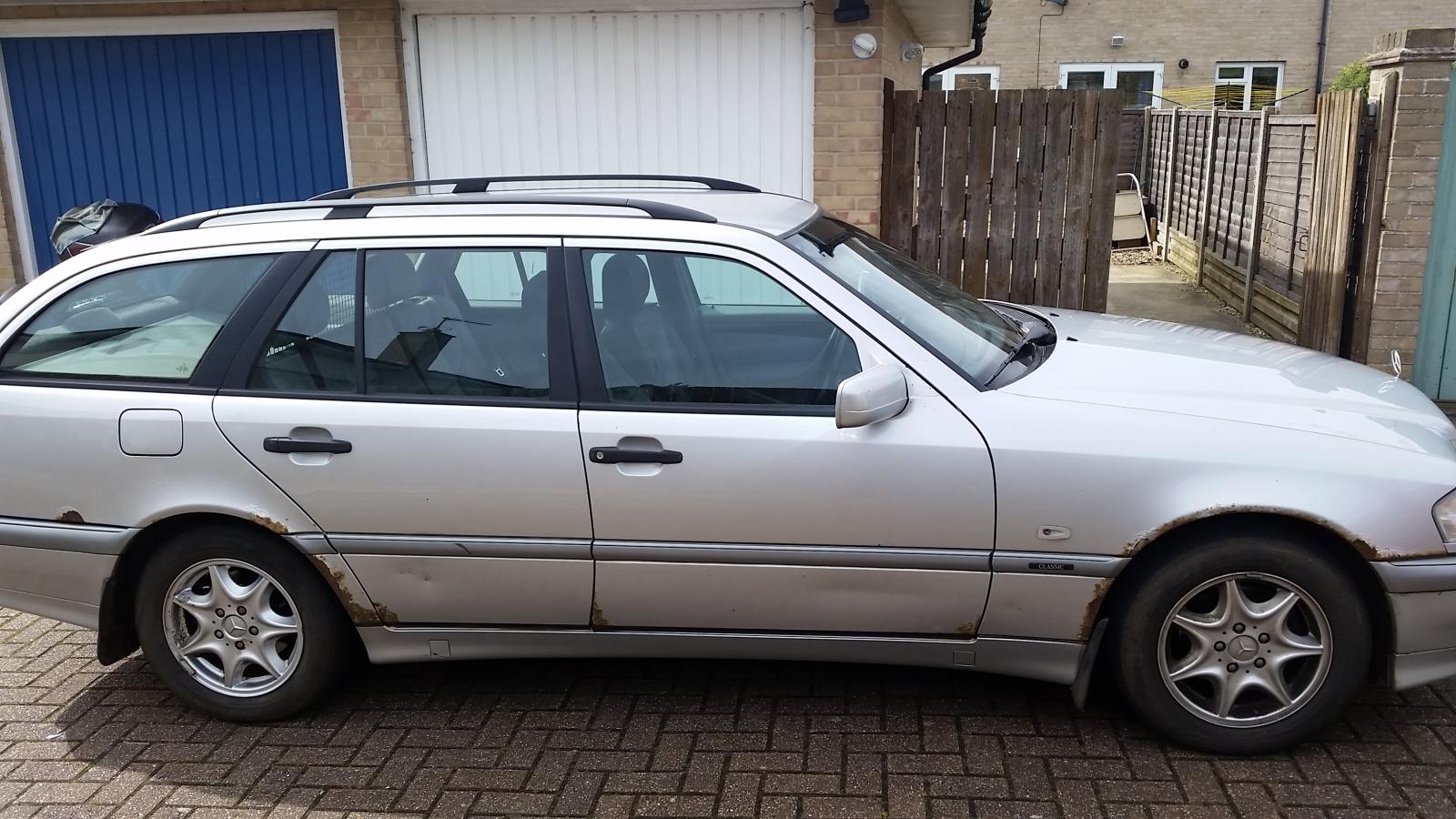

Not spent too much time (nor money) on getting this into a presentable state. Despite looking rotten in places, a quick blast with a wire brush in a drill showed no perforation, and a splash of Bilt Hamer rust removing gel and then their rust converter, primer and a £4 rattle can from Halford has tidied it up no end. At least from 10 yards away!
Interior has cleaned up remarkably well, with just a few very light marks visible.
Tyres are on the limit, but managed to bag 4 immaculate alloys with Goodyear tyres for £50. These will be fitted over Easter along with the new brake pads. I'll then put it in for the MOT before it expires at the end of the month.
