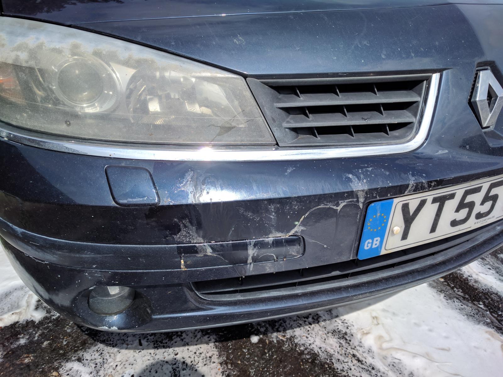

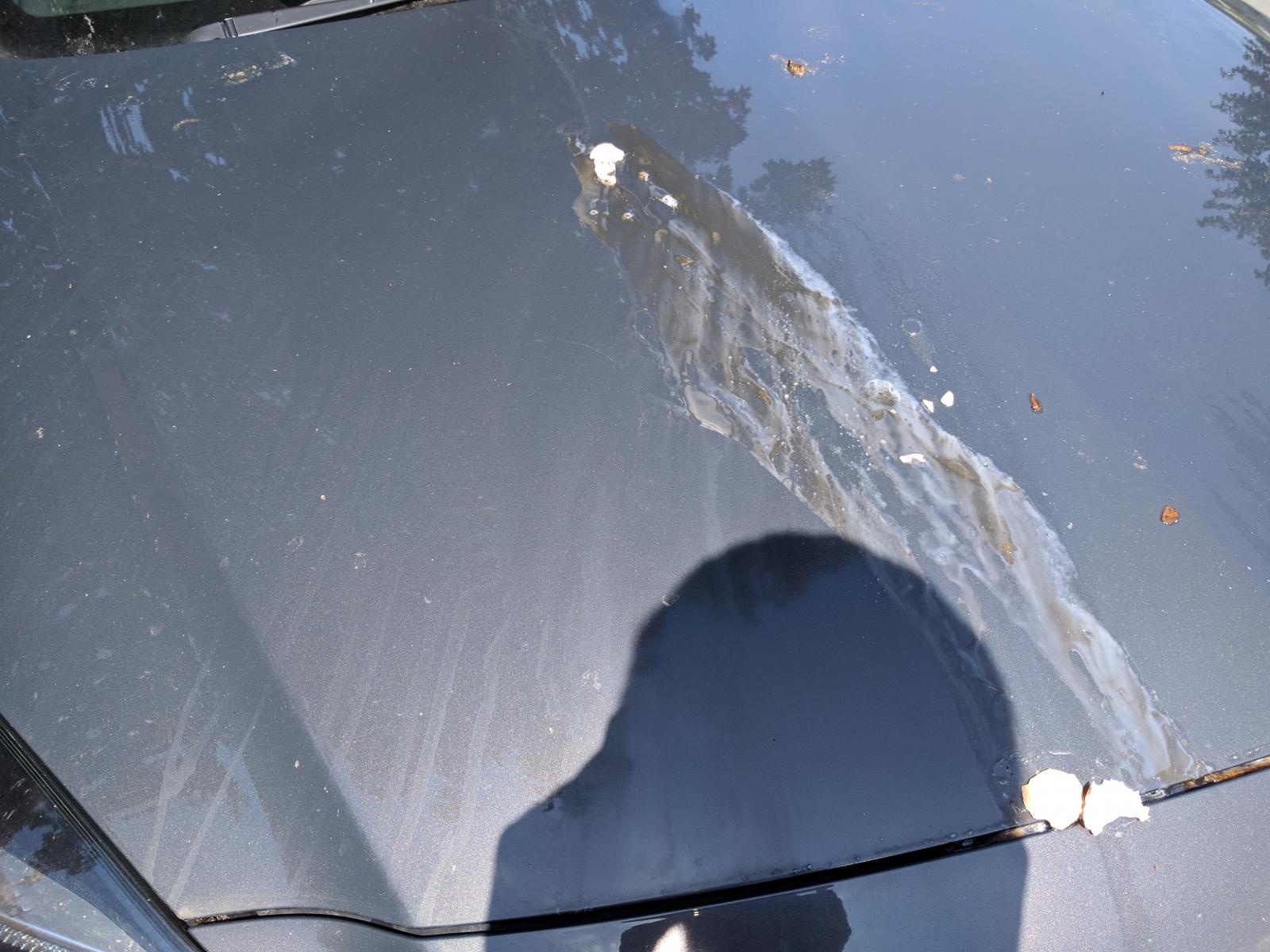

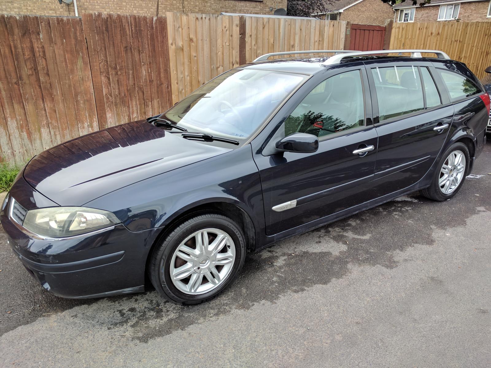

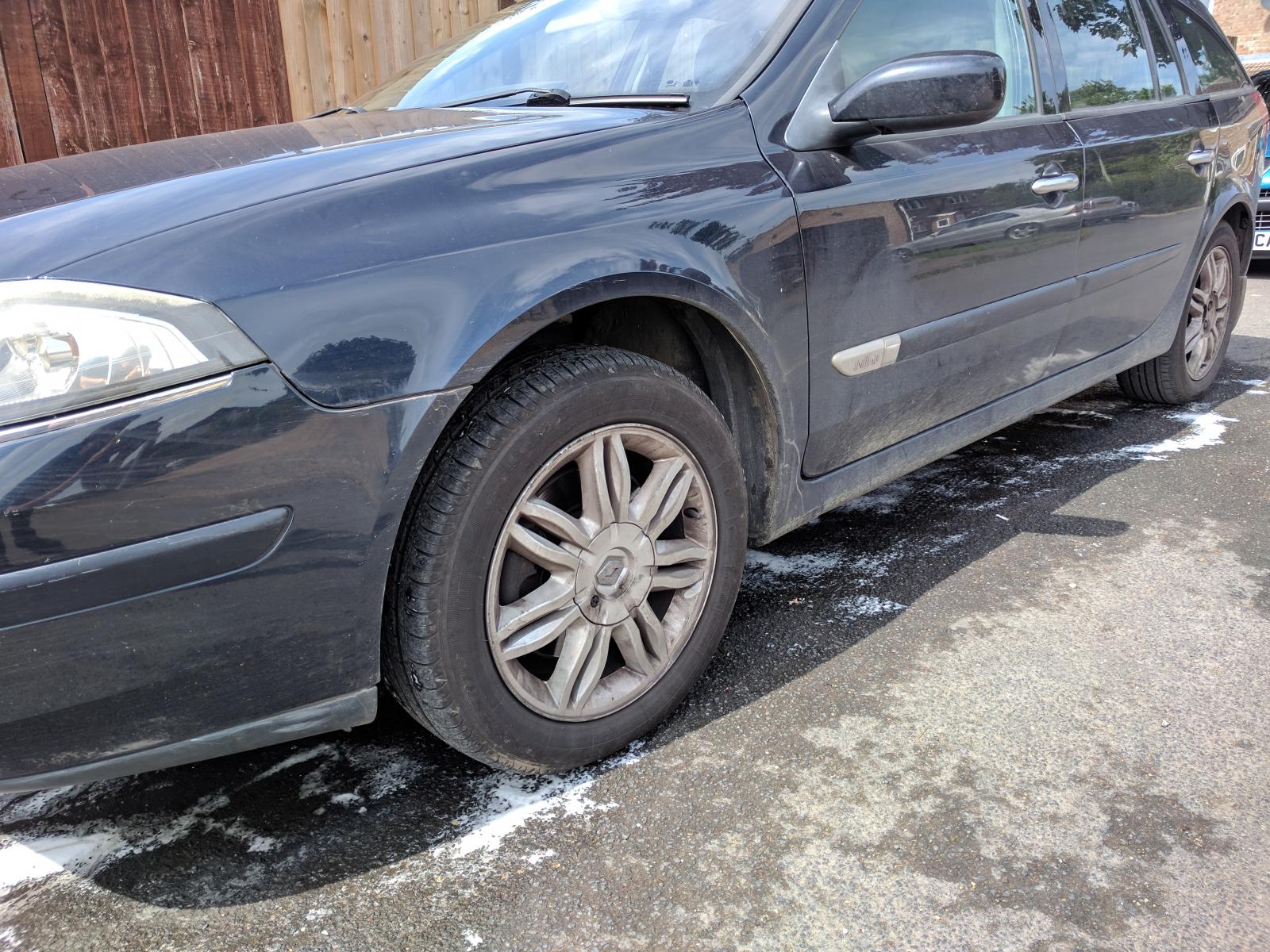

beko1987 Posted August 11, 2017 Author Posted August 11, 2017 I don't think this was anything to do with the 5000+ pikeys we have had in thame this week or just kids, but after we had eggs for breakfast we saw eggs on our cars... And the gooner They must have been a shit shot as there were several just on the floor. But ive got today off, so got the gear out and washed the Zafira (no damage) and Amy went out. So I washed the gooner! (again, no damage but tbh I wouldn't have cared if there was) Gooner needed a wash ah way, I haven't touched it since the small wash I gave it a few pages ago Etc. Came up well with just a rinse, foam, wheels, wash and dry As I was finishing my car, a chap from across the cul de sac came home and confirmed that it wasn't just us it happened to I told him to park behind the gooner and I'd get it off for him. He then asked if I could wash it, as he's seen me out before on weekend marathons so I said sure, and spent 2 hours giving it a very thorough wash. Didn't go to town, said I would do that another day when I've got time and the sun's not beating down, but the egg came off, and it's the cleanest it's looked in the 4 years he has owned it He had a Mazda xedos when we first moved it, utterly hanging but always with decent tyres etc. He gave me £30 too, result! Will see tomorrow if I have to do it all over again... Rusty_Rocket and Dave_Q 2
Kiltox Posted August 11, 2017 Posted August 11, 2017 I fucking love how tidy that car looks with a quick wash. You'd never know it was £400 or £0 worth beko1987 1
beko1987 Posted August 11, 2017 Author Posted August 11, 2017 No, it comes up really well! It's swirl tastic, but I can forgive that! Its one of the reasons I don't care too much (might care a bit tomorrow if it happens again though...)

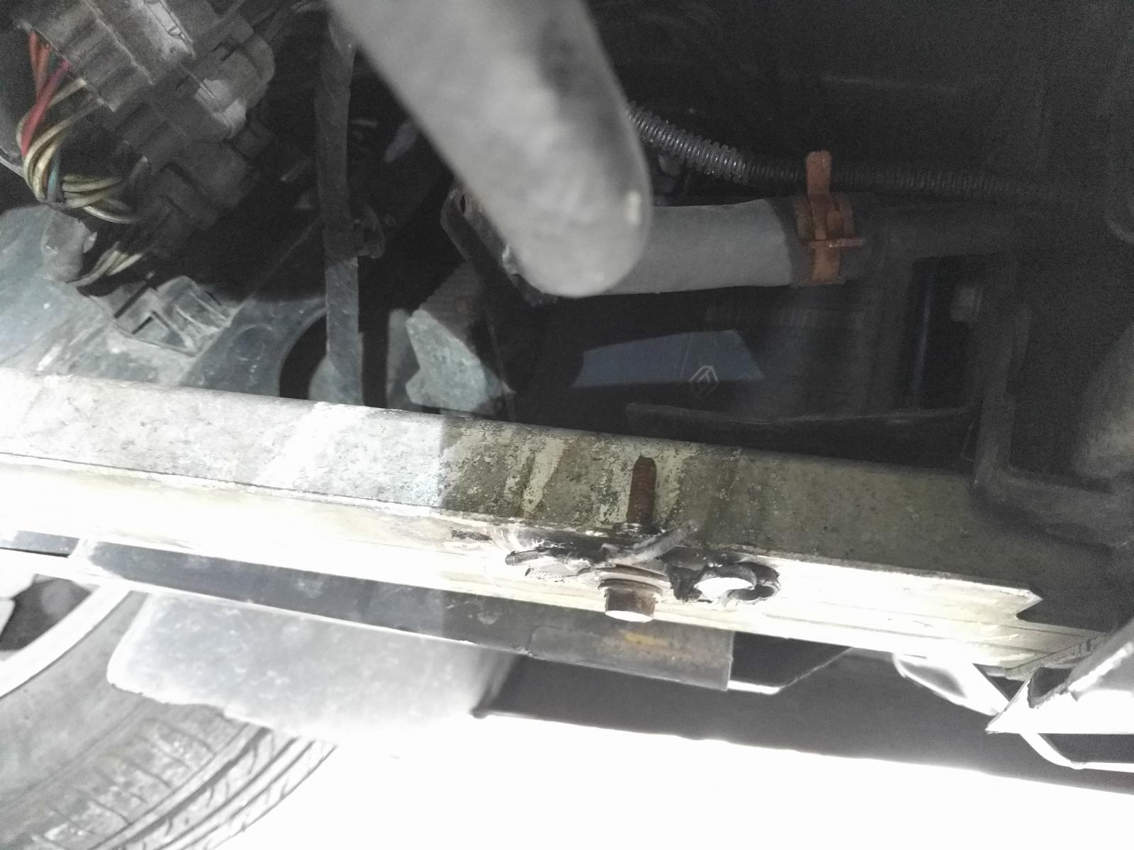

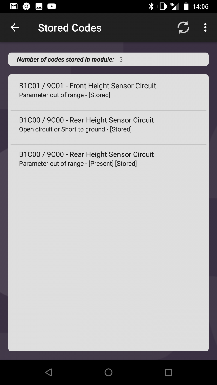

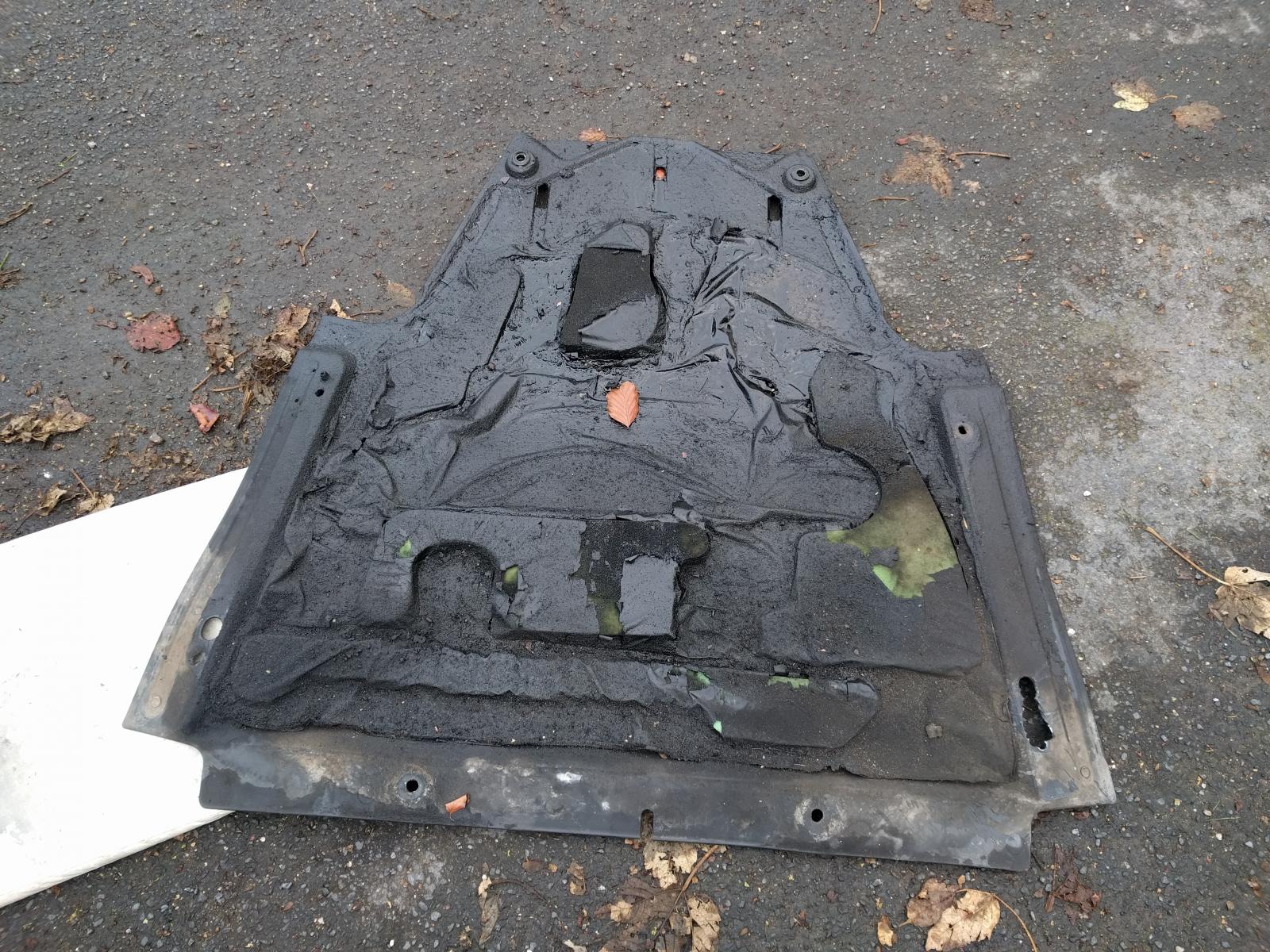

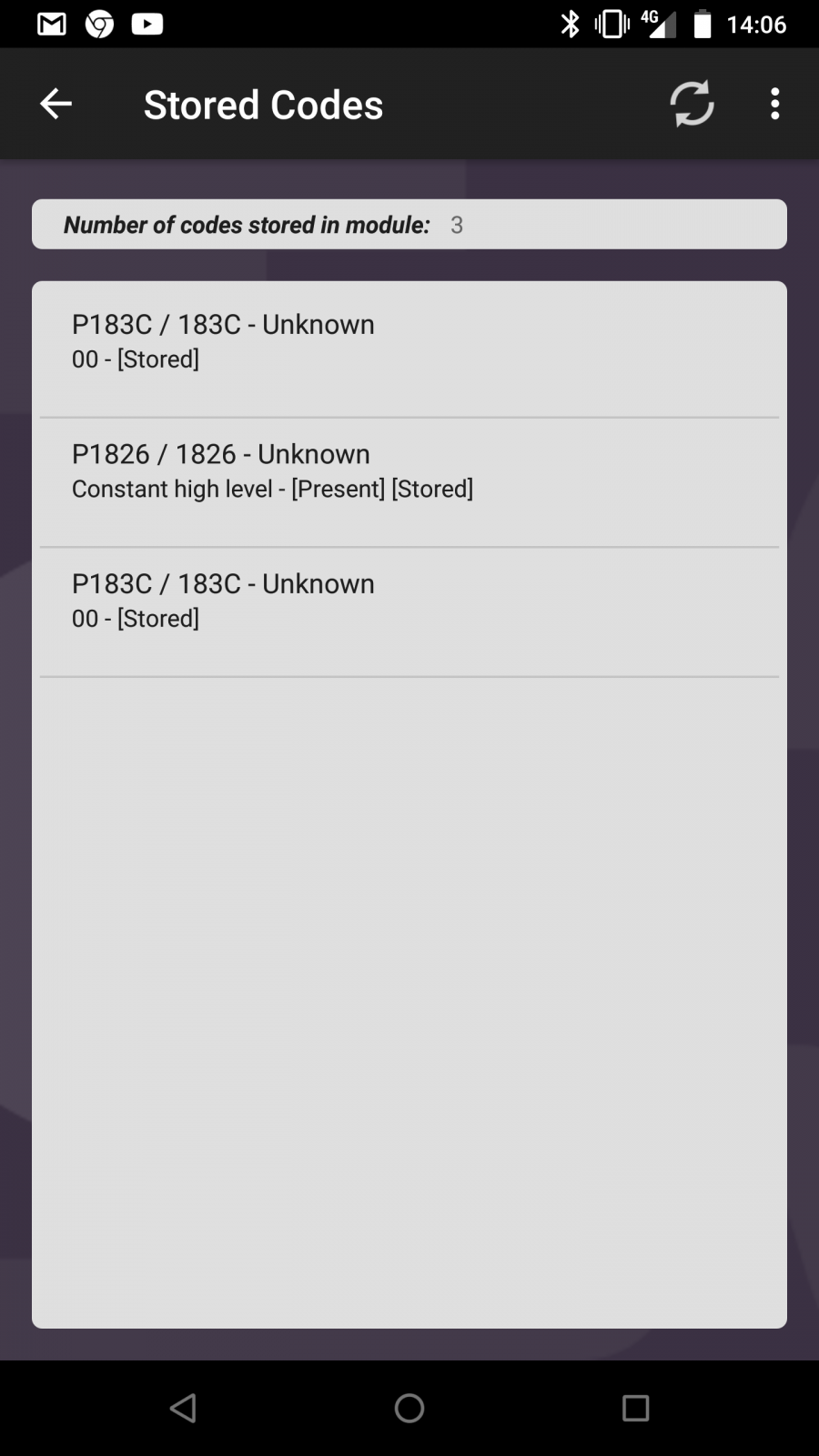

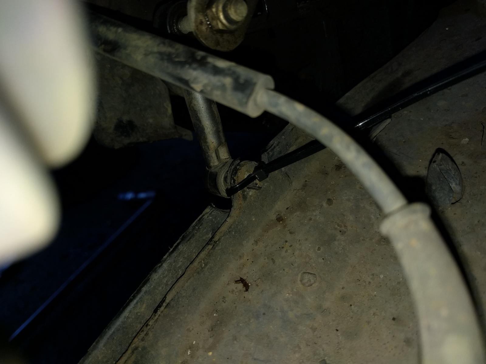

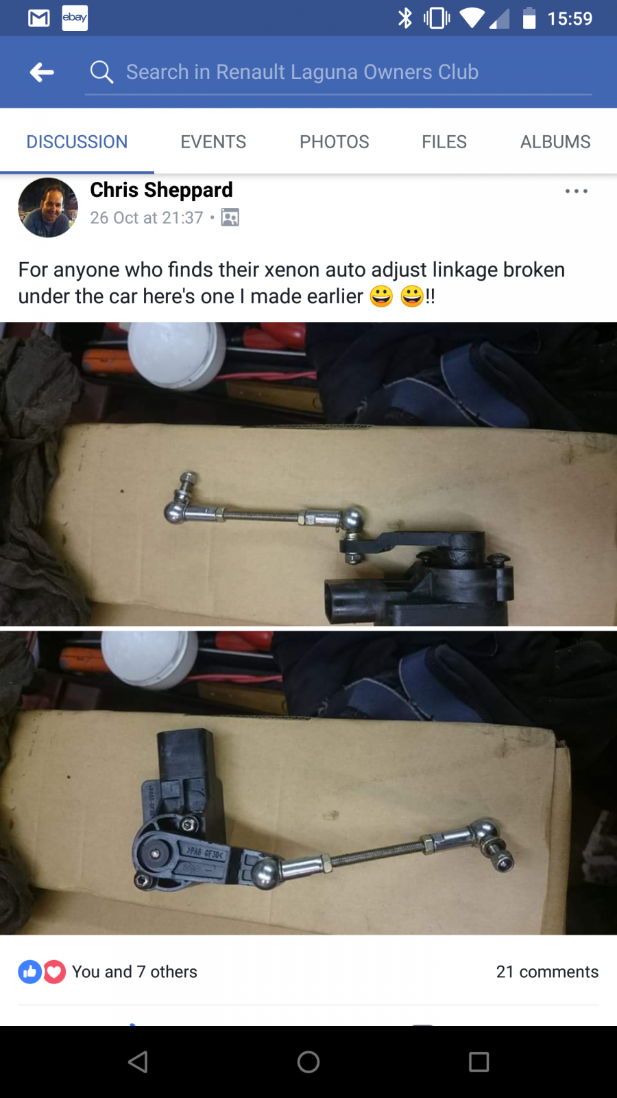

beko1987 Posted November 4, 2017 Author Posted November 4, 2017 So, as part of my moan in the grumpy thread a while ago about the vision at night, some digging revealed that the adjustment arms for the Hid lights can break off, causing them to default to low. Plus it's not running fantastically, the mpg has dropped down a few, and the brakes aren't binding, and when it kicks down on the motorway it blows out a power cloud, although not when gunning it up through the gears (I've tried to fix it the easy way...) So after spending 20 minutes looking for my car clothes, I went out there! And removed the undertray This took another half an hour as one bolt was rusted in place, and helpfully, as I found out it wasn't a nut above it, but a round threaded bit. So fuck it, I tore a hole around the bolt, it's held up fine with the rest. It was also bloody heavy as all the foam was full of oil. I sat under it whilst it was running, wiping stuff off and was none the wiser. If I was a betting man I'd say it's coming from the top and running down, and has been for some years None the wiser! So back on with the undertray and off the ramps, then off with the front wheel, and aha! The clip at the end is snapped. Someone on facebook showed me an amazing repair for this, which looks stronger than the bloody car But I'm not buggaring about with that until I'm sure that's the issue, so I cable tied it on for testing I then had the back wheel off to check, and it was fine I had both plugs out and gave them a blast with switch cleaner, but tbh they were spotless so I can't see that being the issue. I got fucking filthy, mainly because the car looks like this atm I was going to fanny about removing pipes from the engine and having a good old poke about, but it started to rain, and we're off out later, so I sacked it all off and here I am! Will go move the car in a sec and see if the headlights are better, itll be dark in a bit. Got these codes from the engine, will have a look into those later. Haven't cleared them yet These were for the headlights, but ive cleared those now so I can keep an eye on it. Paid the 99p for 14 days of oh no renault, so id best check it in the week after a few trips to work
Kiltox Posted November 4, 2017 Posted November 4, 2017 Blimey is this still working???Course it is - quality car from a kwality dealer innit HH-R 1
HH-R Posted November 4, 2017 Posted November 4, 2017 At least the sump is never going to rust through! chaseracer and beko1987 2
SiC Posted November 4, 2017 Posted November 4, 2017 I fixed the arm on the back of mine by drilling through the middle and put a bolt with nuts and washers through it. Also on the app, on the screen you read the codes, you can reset the light position in the menu. This will centre the lights in the correct location, assuming it's on a level road. beko1987 1
beko1987 Posted November 4, 2017 Author Posted November 4, 2017 I fixed the arm on the back of mine by drilling through the middle and put a bolt with nuts and washers through it. Also on the app, on the screen you read the codes, you can reset the light position in the menu. This will centre the lights in the correct location, assuming it's on a level road.Oooh fantastic, will do that! It's parked on the level now!

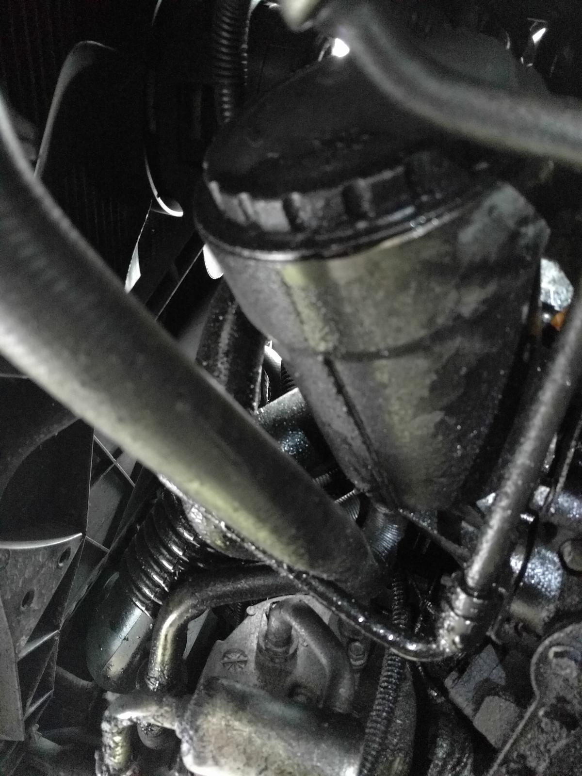

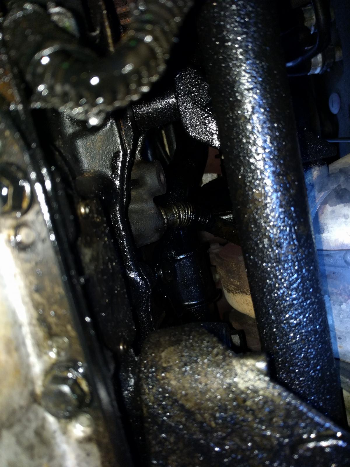

beko1987 Posted November 15, 2017 Author Posted November 15, 2017 It thinks it's a steam train now! Jumped it this morning, and noticed some blueish smoke puffing out from under the engine cover. Gingerly lofted it off and the 2nd (i think their injectors?) thing was puffing out smoke in time with the engine... Drove to work as I couldn't do much else and had another look, and the first one is blowing pretty little oil spurts out! The left 2 in the picture Its deffo oil, I caught some! I'm sure it's just a little seal that needs replacing, don't see it being a difficult job at all... Any thoughts from anyone?
DVee8 Posted November 15, 2017 Posted November 15, 2017 Fire burn it with fire.Not helpful i know. UltraWomble, Fat_Pirate, alf892 and 1 other 4
oldcars Posted November 15, 2017 Posted November 15, 2017 Injector seal? Just a guess don't know much about these engines.
