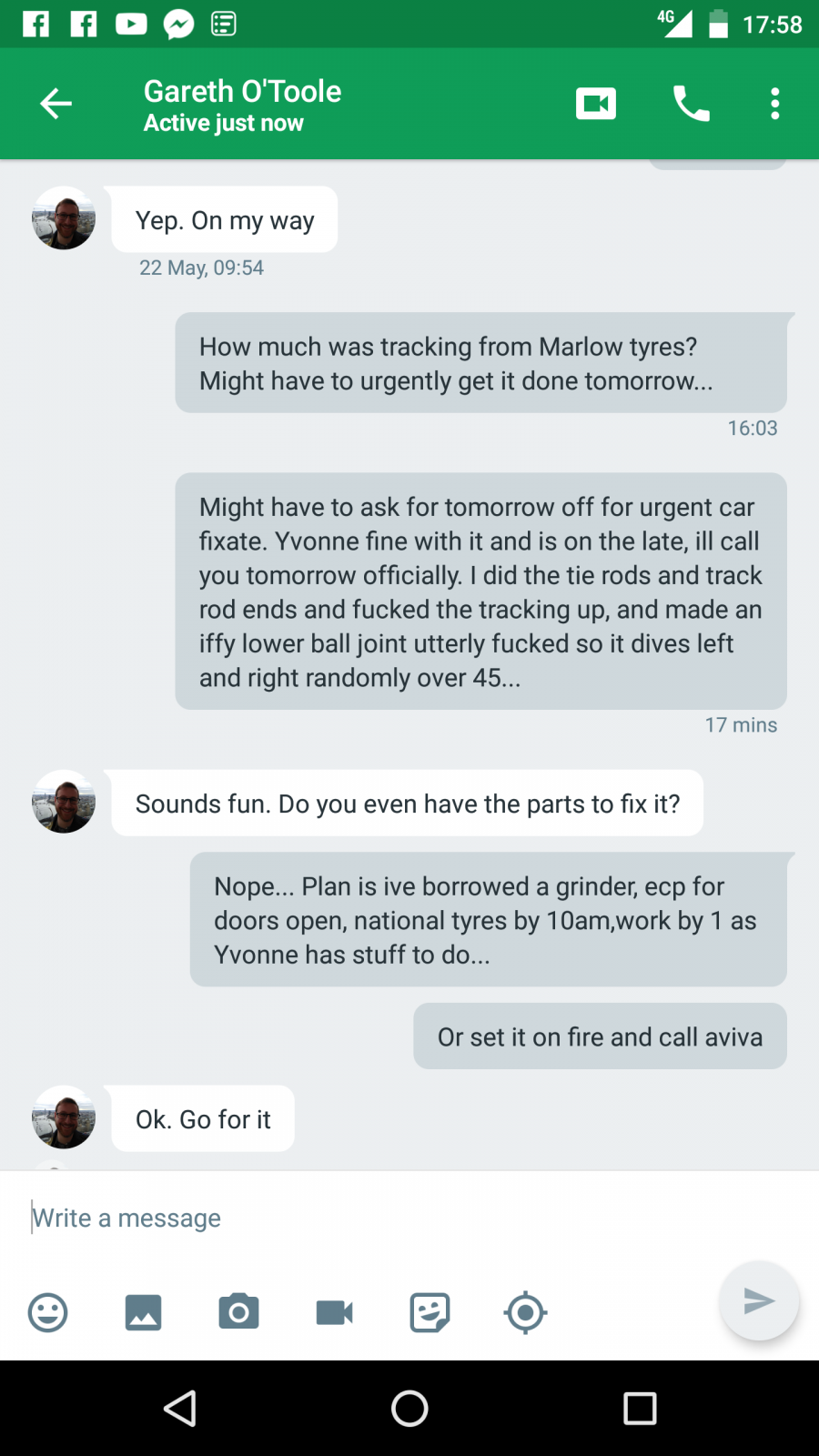

beko1987 Posted May 29, 2017 Author Posted May 29, 2017 Having a boss as a closet shiter is ace! Thanks gnomeotoole. Plan A is go, ball joints reserved oldcars 1

beko1987 Posted May 29, 2017 Author Posted May 29, 2017 I have a 110v bosch grinder and various grinding discs in the boot, euro car parts at 8, hopefully national tyres by 10, in the office by 1.45 at the latest. I do love a deadline! On the plus side on the 8 mile trip I did today the steering no longer crashes over everything, and when it's not pulling me about (which I think is coming from the passenger side) it's nice and precise now! I won't get my hopes up too much yet though, I imagine the big nuts on the ball joint will be a bastard, and ive only got wd40... Picked up my chair and camping bag for shitefest too though, so not all bad
beko1987 Posted May 30, 2017 Author Posted May 30, 2017 Well that was a cunt! Should have drilled the rivets out rather than used a grinder but it's done now. Highlights include whacking the back of my hand with the lump hammer, and when the ball joint came out from the hub the hub sprang out, hit me in the chest and pulled the driveshaft out of the box... It seems ok now, just had a test drive and got up to 60 and no snatchy steering. Going to limp to get some tracking done soon, then off to work. Haven't done the drivers side. I don't have time, especially now I know what a bastard it will be. It'll be fine*. Wish I'd saved myself £12 now, never mind, I'll do it one day The last knock from the front seems to have gone though, which is promising
