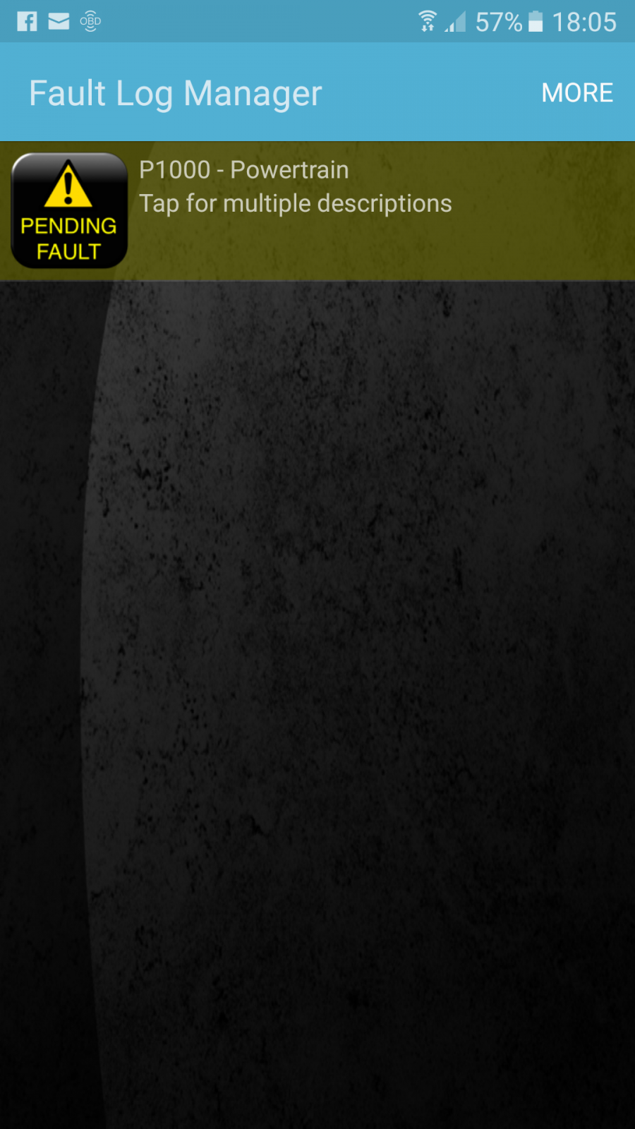

Chucked the widi obd2 dongle on the jag and loaded up torque. Straight away it throws a P1111 code and torque app displayed "powertrain fault pending". Bugger! So i decieed to clear the code and rescan which then displayed p1000 "powertrain fault pending". Bugger again!
However, googling the codes puts mind mind instantly at rest. It transpires that p1111 is displayed when someone scans the ecu to say the scan has taken place. P1000 is displayed to say ecu is ready for scan.
Youtube video in link below explains all

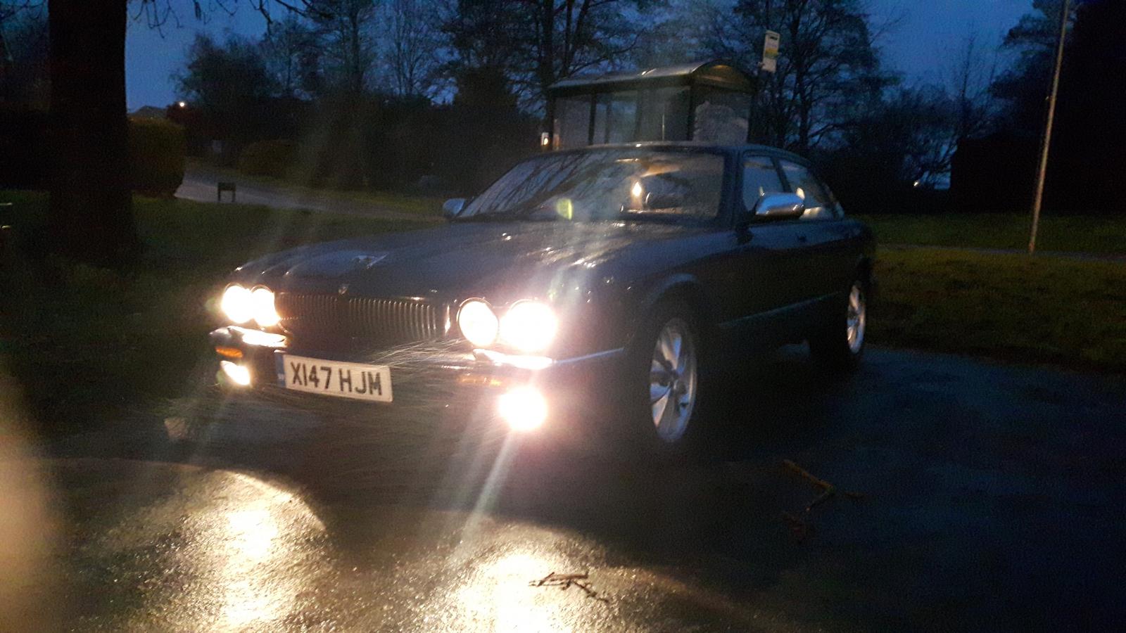

Anyways have some evening growling kitteh pics

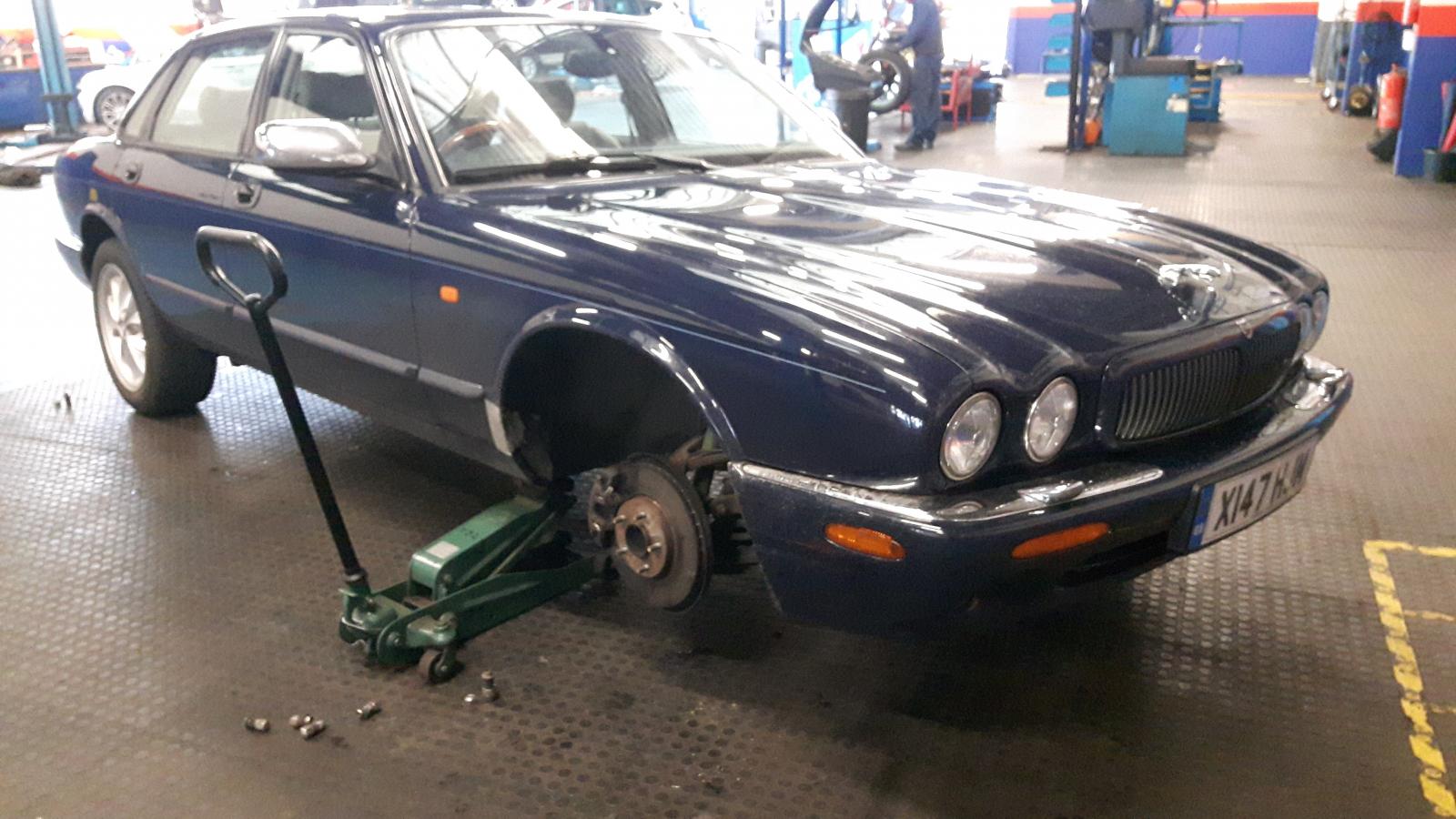

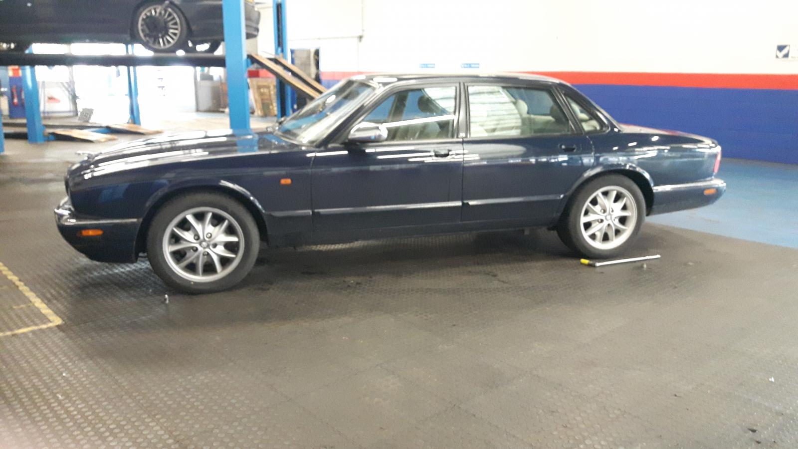

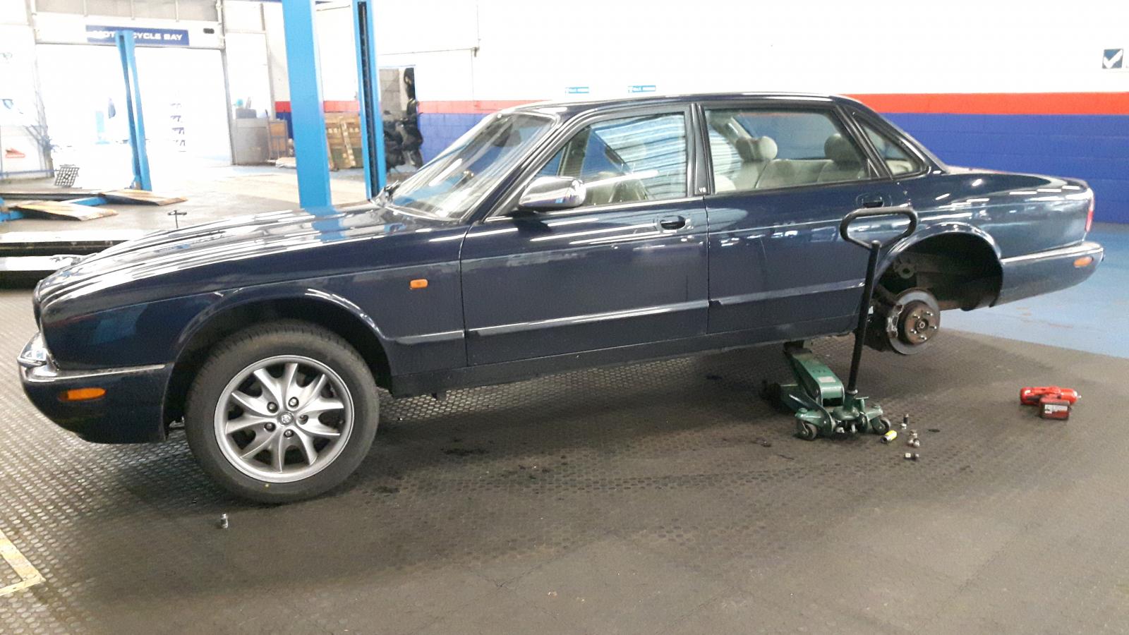

A few things i've tried to ignore since i've had the Jag is the steering wobble between 30-40mph and 75mph+ and a slight self steering sensation from the rear. So last weekend enough was enough and i took it to my local Protyre branch in central Bristol.
Had all four tyres balanced and all were wayyyyyy out. The fronts have got brand new ditch finders on (fitted before i bought the car) and the rears have Pirelli P6000 fitted with good tread. Guy doubg balancing said that the P6000 have a tendancy to develop flat spots if left for any length of time, which i guess is exacerbated by the sheer weight of the car. Both of the Pirelli's on mine were found to have small flat spots. I was advised to see what they were like after having them balanced and if atill bad then get new tyres.
I can report there is definitely a marked improvement in handling although there is still a small amount of shake at 60mph+
They didn't have time to get the Jag up on the ramp to check the bushes on the a-frame on the rear suspension, but judging by the condition of the bushes i could see with rear wheels off, i may be investing in a rear polybush kit soon!
