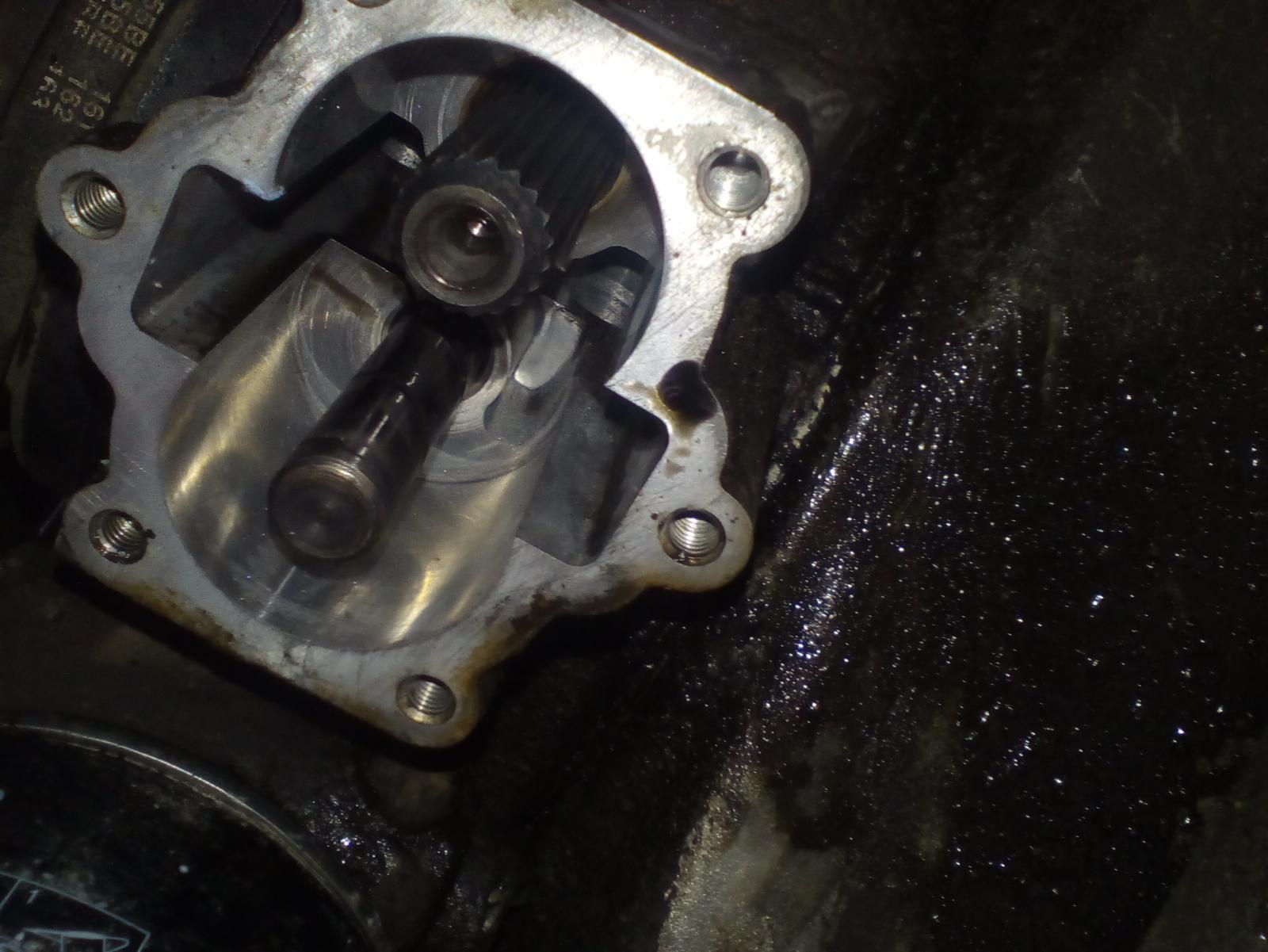

Oil pump end cover - 6 hex screws holding it on to housing.

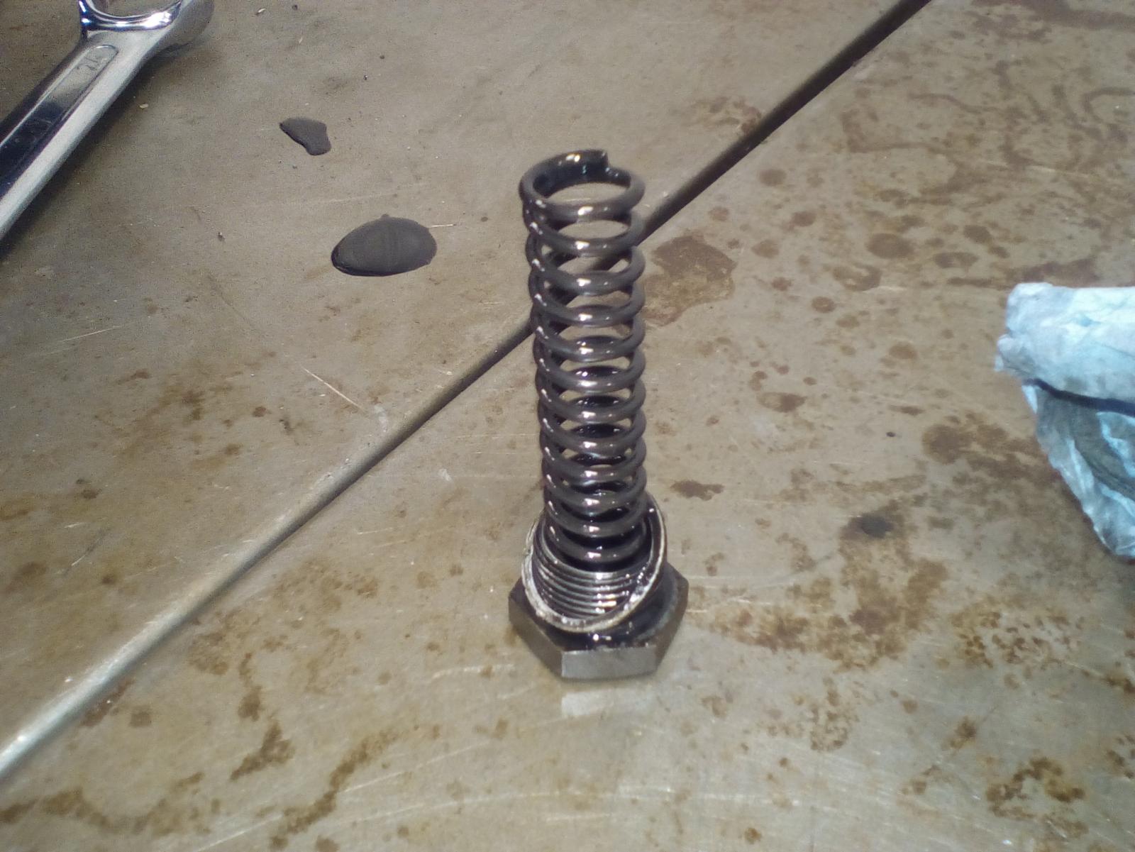

The large 'bolt' is end of oil pressure relief valve.

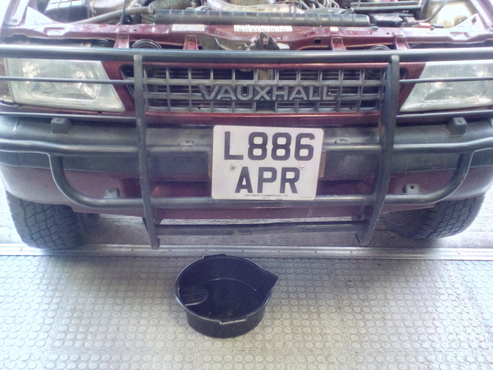

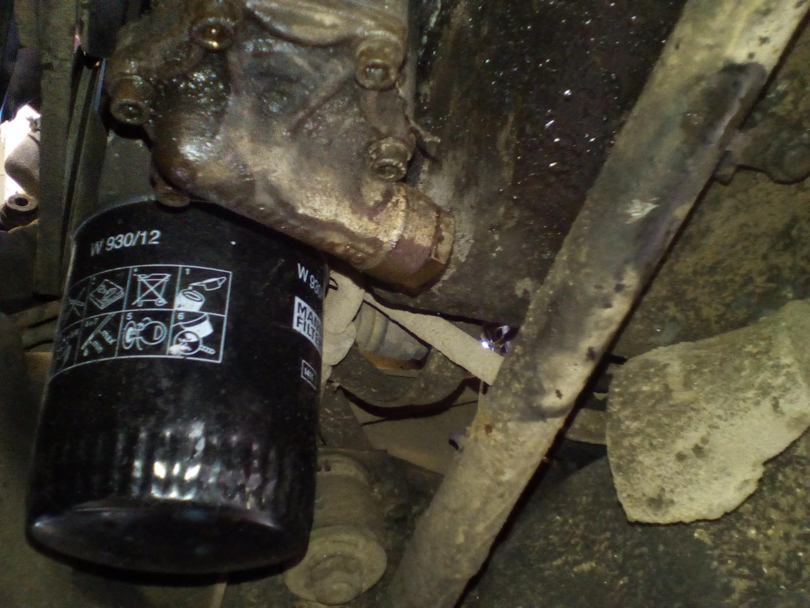

Slacken 6 hex screws and remove  - remember to miss oil drainer and watch  (with slight horror/air of resignation) oil make it's way inexorably up (down) your arm....
Both driver and driven gears will slide down their respective oily shafts as you remove end cover.
Yay.
Splined/toothed shaft is driven via injection pump/crank gear. There is some wear but even I draw the line.

No oily armpit for me today. A little part of me was disappointed...
Some light cleaning of housing before cover/leaking oil prv attended to - not that I didn't resealed it properly before. Honest. :-)
Then on to cover - gently held in vice for old gasket removal, prv remove and reseal.
Yes, it's a long spring that really doesn't want to be compressed whilst attempting to refit retainer with oily hands. At all.
Apply a constant pressure with twisting action and swearage. Retrieve spring. Repeat.

I'm surprised the steel gears wear before the housing , nice to see someone bothering though . Quite a frontera fan on the qt
The end case wears. Gears usually wear due to lack of oil changes. 4500 miles on mineral is the way forward.
