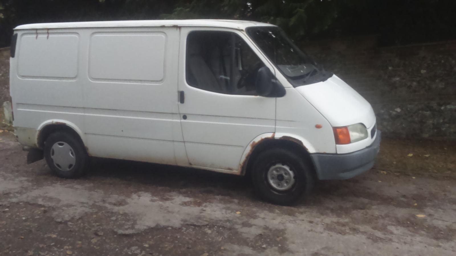

Arthur Foxhake Posted February 7, 2017 Posted February 7, 2017 I wrote loads and lost it somehow, so, briefly. Mk5 Transit, 68K, one owner electricians van. £150.I intend to own this van for as long as I need a van. The Old Bloke Next Door, JayW, worldofceri and 24 others 27

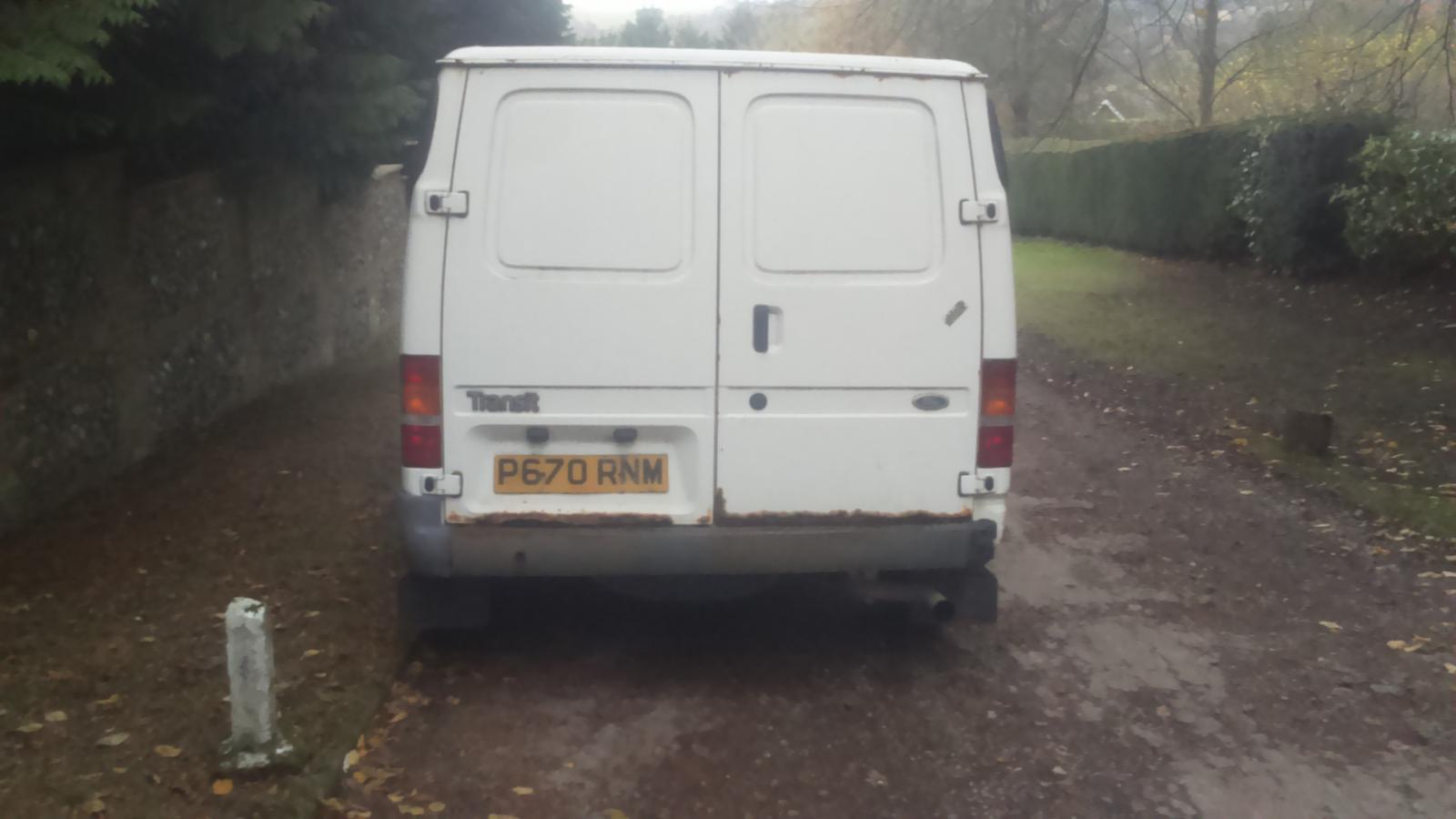

Arthur Foxhake Posted February 7, 2017 Author Posted February 7, 2017 Slight picture taking fail after the trial fit there but more to come soon. Vince70, Asimo, Dirk Diggler and 9 others 12

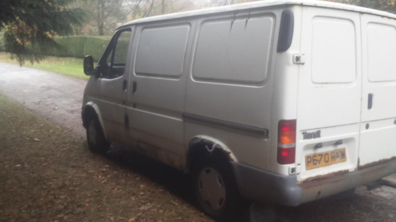

Arthur Foxhake Posted February 7, 2017 Author Posted February 7, 2017 Some more I've missed. Those are the, as collected, unwashed pics. The paint is not that bad underneath. And in case anyone was wondering, I did cut out the inner arch as well. Most new panels, except the wings, are galvanised. 0ldCh0d, Junkman, Vince70 and 7 others 10
Lankytim Posted February 7, 2017 Posted February 7, 2017 I bloody love these smiley face trannies. A cheap one came up for sale on FB after I'd bought my LDV. I haven't seen one that isn't rotten for years though. Arthur Foxhake 1
Arthur Foxhake Posted February 21, 2017 Author Posted February 21, 2017 Lucky escape! Always check above where you are welding kids! Yikes! (pic is sideways for some reason?) Haven't had much time on it recently but some filler, sanding and a bit of primer has occurred. I'm getting towards needing it done so have to make more time for it. Sigmund Fraud, Conrad D. Conelrad, michael1703 and 10 others 13

hairymel Posted February 21, 2017 Posted February 21, 2017 would guess the kit of panels came from the same source as i used http://www.ebay.co.uk/itm/111874650463 lots on ebay
Arthur Foxhake Posted February 21, 2017 Author Posted February 21, 2017 Yeah, that's the same as I bought. The wing looks like OEM quality, but the rest?Not as thick as original and the inner wing is nothing like the original. I've never done anything this involved before and wish I could have bought an original inner wing, would have saved a lot of ballache. Won't be chopping as much off the other side. It's a bit less rusty so I'll use what I need and leave as much original as possible.Did I say original enough? Original.

hairymel Posted February 21, 2017 Posted February 21, 2017 i havent even tried to fit the new panels to my truck and the sharp edges on them have caught me several times already!

Arthur Foxhake Posted March 2, 2017 Author Posted March 2, 2017 That arch is finally done.Only three more to go.If I learned anything from doing it, it was to remove as little as possible, without leaving any rust. I cut away too much and left myself with next to no reference to put it back right. If the inner wings were the same as the old ones I don't think it would have been so hard. Luck was on my side and it tuned out OK in the end. Need to drill a hole in the new inner wing panel to attach the bumper and put the drivers seat back in and that side is done on the front. Opposite side front next. Working my way up to the back one that is the worst, panels available so shouldn't be too hard.I hope. worldofceri, binhoker668, danthecapriman and 15 others 18

Arthur Foxhake Posted March 6, 2017 Author Posted March 6, 2017 Thought I'd make a start on the back arch on the same side as it doesn't look as bad as the others. Is that a spot of rust I see on the chassis? Let's give it a tap and clean it up a bit. Oh dear, I wasn't expecting that. Or that. No matter, found it now so need to deal with it.Luckily it's two thinner sections that were not to bad to sort. That's all for today, plenty more to come. Dirk Diggler, Semi-C, Vince70 and 8 others 11
danthecapriman Posted March 6, 2017 Posted March 6, 2017 Nice job with this AF. Well worth doing and pumping the thing fat with wax afterwards, these old Transits piss all over any modern van. I did this on one of my old ones and a mates camper, on his camper there was a big sponge type thing inside the wing/arch. Presumably sound deadening or something but it soaked up water and was just sat there against the metal inside rotting it all out. Arthur Foxhake 1
Arthur Foxhake Posted March 6, 2017 Author Posted March 6, 2017 Thanks.Yeah I spotted those, when i was cutting it apart they were full of ice it was that cold. They won't be going back on.I do intend to spray all sorts of anti rust concoctions in all the crevices and folds (!). The vehicle i miss most of all I ever owned was my last MK5. I should have done this to it but I had no welder or idea how to use one at the time.I went everywhere in it. It had about 260'000 miles odd when all the suspension went wonky and the mounts were FUBAR. I'm keeping this one.I want to take my motocross bike out again and don't like trailering it, it's an advert to be followed home by land pirates and have it stolen.The sooner I get it done, the sooner I can go out on my bike. Ive only ridden this bike three times since I replaced my last one do to various reasons but i'm itching to go out on it now. Im also itching to be driving a tidy MK5 van with a turbo. Oh wait, did I mention the turbo yet? Lacquer Peel and Vince70 2
