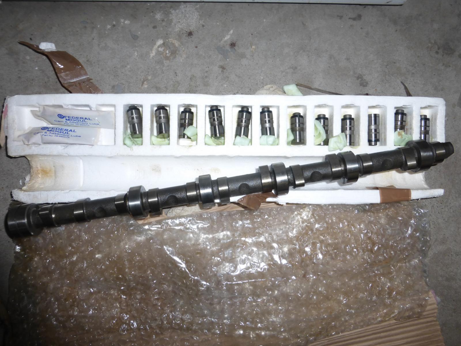

Royale80 Posted January 28, 2017 Author Posted January 28, 2017 I had a look-got the tappet piston freed off-but still not working.Tried to have a look at the cam and cannot feel any lobe on the cam-so now suspecting a cam shaft.Question-how hard to change and if I can get a second hand one-will I have to replace all the tappets? Bren-I've found a supplier on the bay who sells new tappets for £12Regards Steve
Bren Posted January 28, 2017 Posted January 28, 2017 A used cam will destroy a new set of tappets in no time - the whole lot needs to be replaced as a set. Royale80, 3VOM, Banger Kenny and 2 others 5
alf892 Posted January 28, 2017 Posted January 28, 2017 Sounds like you'd best get a cam then........and all new followers. The car seems worth it though Royale80 1
Austin of England Posted January 28, 2017 Posted January 28, 2017 Sounds like you'd best get a cam then........and all new followers. The car seems worth it thoughSteve I have a new cam kit for one of these with 12 followers, I don't know which make it is but is has a part number on it which is R900090581, I paid £80 for it to keep as a you never know item (I have a Senator B 2.5). If it is any good you can have it for what I paid plus postage or pick up from Wakefield West Yorks. Tony Skizzer, Uncle Jimmy, Joey spud and 7 others 10
Bren Posted January 28, 2017 Posted January 28, 2017 There is a difference between the cams on early and later engines - there is an oil feed that can be obstructed by fitting the wrong cam. GM6 spares in cornwall are a good source of parts and knowledge. Magnificent Rustbucket and Royale80 2
Royale80 Posted January 28, 2017 Author Posted January 28, 2017 Thanks Austin-will do a search to find if it fits. Steve
