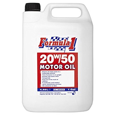

Oil does seem to have got really expensive. I always used to do oil changes at 5k because it was easier to keep track of than 6k, not any more though.
^^ We used to sell a pallet of that stuff a month knocked out for £2.99
Most people would say the car had done 100 000 and burns a bit so this will do.
Then wonder why the engine shat itself about a month later.

Cheap 20/50 isn't cheap any more. I saw 5litres of stuff equal to the Formula 1 ambrosia for £18 in one of those shops that only sells shit- makes Lidl oil look like a bargain. For what it's worth, I don't bother with 20/50 any more even though I have several cars that are said by 'experts' to require it. As long as the oil pressure stays up I sling it in, piss thin synthetic is fine so far. If the B series starts squeaking I'll let you know
