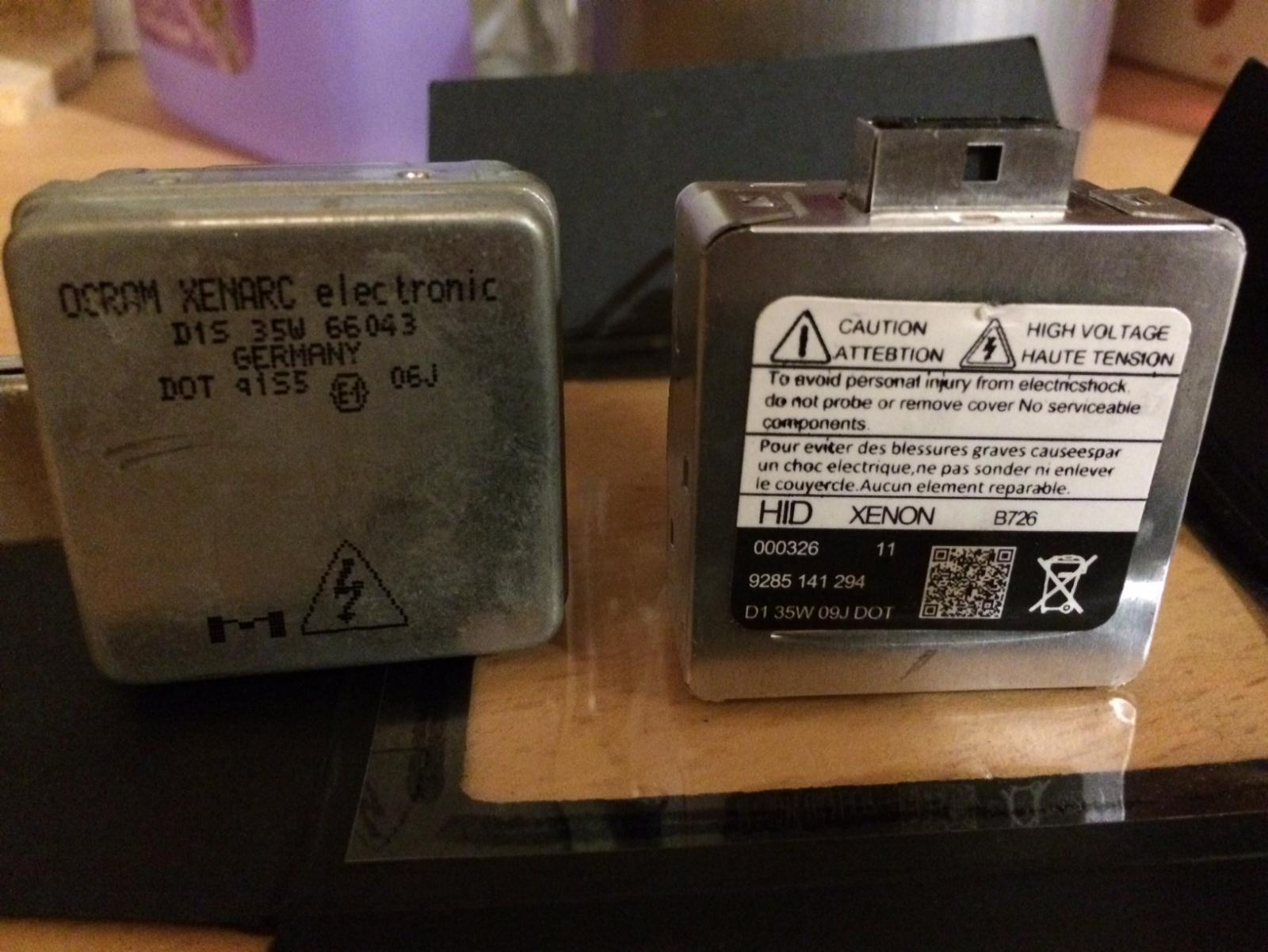

I ordered these 2x xenon bulbs from Amazon. Not the most expensive of the selection available and of course they didn't work. They fitted, plugged in and look generally identical to the old ones but there was no light from either bulbs when I turned the lights on.
Either they're borked or I've somehow managed to buy the wrong thing.
The one on the left is original the one on the right is the new one. Anyone any idea what I did to buy the wrong thing? It seems a but unlucky both bulbs are borked.
The amazon store had a decent rating. I'm sending them back so hopefully i'll get my money back.

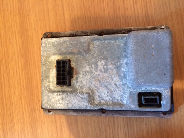

I suspect the problem is with the ballast ignitor on the bottom of the  headlamp (the one with all the high voltage instant death warnings on it).  The braided wire that runs from the lamp to the ignitor also looks to be pinched or damaged.

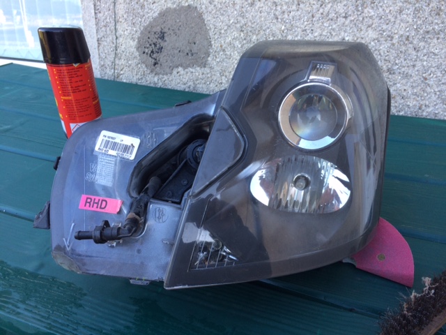

Of course right hand drive ones are made of unobtainium. Can this be fixed the ballast ignitor looks like a generic kind of part? The other thing is there are a couple of tabs burst off the headlamp so is it really worth fixing?
The other option is to buy one from the states where they're dirt cheap. This new one $120 delivered to the UK,  which at the current pity full exchange rate is £98.
Of course the beam will be going in the wrong direction. Cobblers mentioned previously this can be altered and although I read you can rotate the the bulbs but I can't see this working on this xenon setup. I also read something about some yank stuff dipping down and not to the left so it passes the UK mot. Anyone any ideas?

There's not much to go wrong (electrically) apart from the ballast so I'd either buy a replacement ballast (if they are available - they are usually interchangeable across a range of cars) or get the light unit from the US and just swap the ballast over.  All the ballast unit does is generate a stable high voltage for the "burner".
Unlike conventional lights, the HIDs have no filament - they have two electrodes and the current passing between them excites the gas which glows brightly - hence the name High Intensity Discharge.

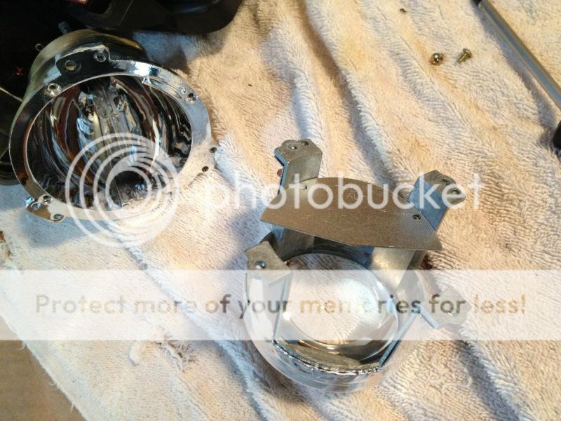

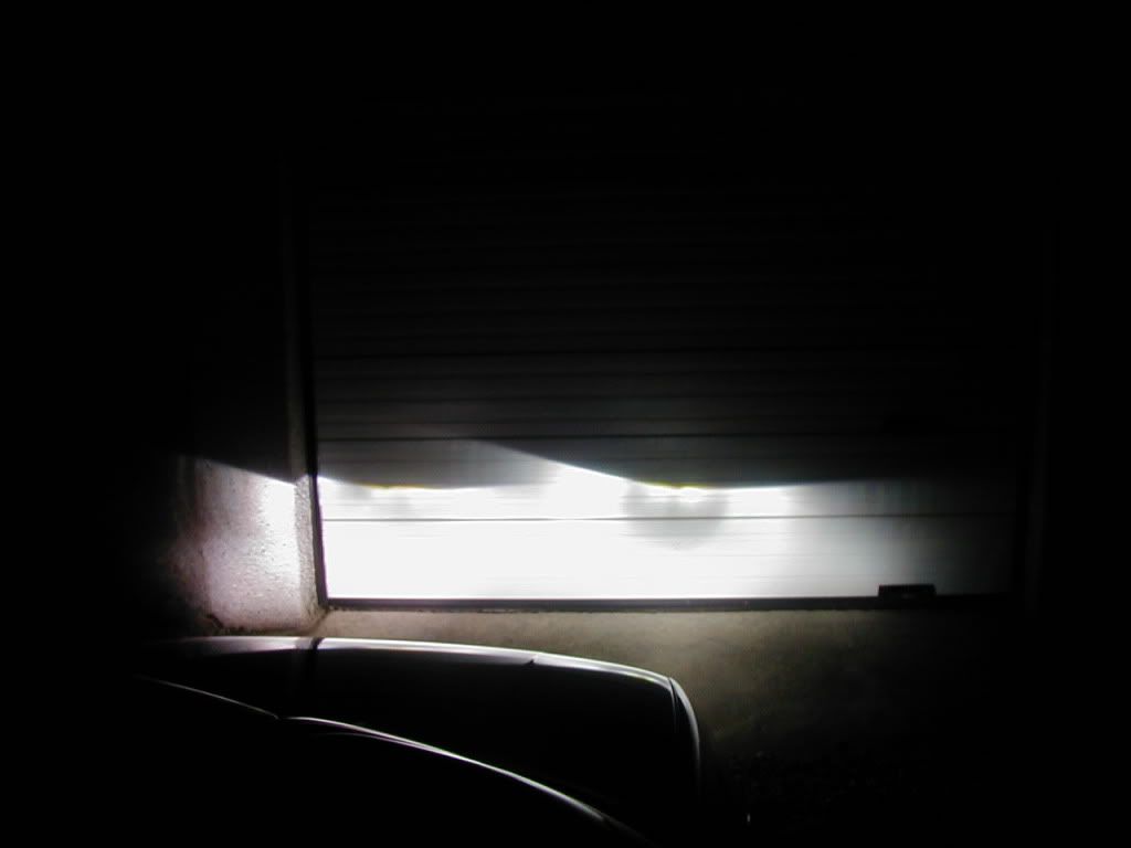

Basically in a projector lamp low beam, if you can get the lamp unit apart and take the projector thingy to pieces, there'll be a cutoff shield infront of the lense which simply shields the bulb and sets the beam pattern very cleanly.
If this is just flat then it's universal "flat" cutoff like old USA specs. If it's angled like in the picture then the beam will kick down at one side and you need to flip it over to turn the LHD lamp into a RHD lamp.
Euro RHD cutoff:
 (RHD is obviously a mirror of this)
Whereas the US spec doesn't have the "kick up" at one side. It's just flat straight across.
It might not be easy to flip it, so maybe you could just take the bits out of the RHD lamp, everything tends to be fairly modular and should swap over if the lamps were made by the same manufacturer.
Alternatively, take the wiring gubbins out of the LHD lamp and swap em into the RHD one.

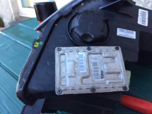

Thanks chaps, AMC that looks like the one on it. I guess I could swap the ballast resistor from the good lamp onto the bad one to prove if it is this at fault?
It's a pity the current light is damaged, I suspect changing the internals into the use one would be the way to go but I bet it's all glued together.
Yeah I suppose you could swap the ballasts side to side and see if the problem follows.
The lenses are usually mostly clipped on, with a bead of non setting butyl stuff to seal them.
If you warm the whole unit in an oven to 80c or thereabouts, you can gently pry the lenses off, do what you've gotta do then warm them back up and clip back together.
Yep, this is the way forward. I've an intermittent fault with the xenon's on the e46 and this is the way to rule out the ballast. Mine are an arse to get out apparently so I've not bothered...
I'm going to try it tomorrow. The cheapest ballast resistor on eBay is 80 quid so I want to make sure it works before I buy one!

I swapped them over and the broken light works with the good lights flux capacitor. I Think some water might have got in.
