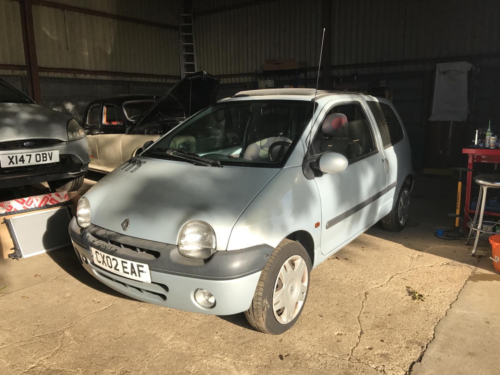

Bear Posted October 31, 2016 Posted October 31, 2016 I really, really need to sort the Twingo out. It's either going to be a faily driver to take over what the Smart should have done, or sold to get something more to my usual tastes (though I maintain I have a Twingo because I really like the idea of it - even if it has taken a year to get around to seriously thinking about doing the headgasket. Hope I can remember how the bits I took off go back on). Amazon headgaskets are around £60.eBay has sets for under £20 http://www.ebay.co.uk/itm/PAYEN-HEAD-GASKET-SET-RENAULT-CLIO-TWINGO-D7F730-D7F700-D7F701-D7F702-DX630-/122076911029?hash=item1c6c59d5b5:g:JasAAOSw0UdXqGrJ This is the set I was thinking of buying - it has valve stem seals (I don't have a spring compressor though) and head bolts for under £40. http://www.ebay.co.uk/itm/HEAD-GASKET-SET-BOLTS-RENAULT-CLIO-KANGOO-TWINGO-1-2-8V-2001-06-D7F-DIET-/130745837972?hash=item1e710f2994:m:mZTINFmgmGwnTZk6BZ0ZT5w I'll also need to get a timing belt kit and since I'm replacing the radiator I figured I'd do the water pump too. That combo seems to be about £100. The gasket blew between 2-3 causing a misfire, no excessive smoke or oil/water contamination, so I'm hoping for a relatively straightforward repair once I've sussed out how to stop petrol pissing out of the rigid fuel line to the fuel rail - the only reason the inlet manifold is still on the car! Have a picture of the Twingo. And the engine... (specifically the bit where I went "Oh bollocks it's not OHV this won't be as simple as I hoped"). And the glorious sunroofy interior. New and old parts! Mr Lobster 1

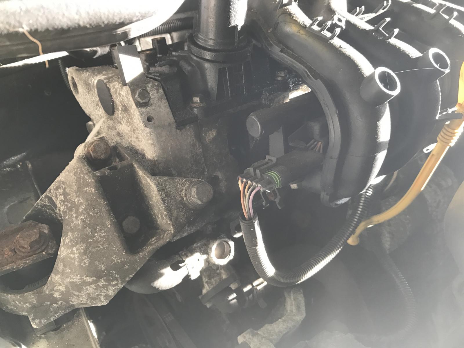

Bear Posted October 31, 2016 Author Posted October 31, 2016 Everything is in Sussex It looks like MOST of what matters is pretty straightforward - I get the kit with the rubber gasket for the later cam cover and we're rolling. I have two new engine mounts, but not the one it looks like I have to undo to do the belt-end of the engine, too. It'll probably need new tyres it's been standing (under pressure and rolled around a bit) so long. But it has been under cover the whole time, and dry. It's gotta be worth the effort.

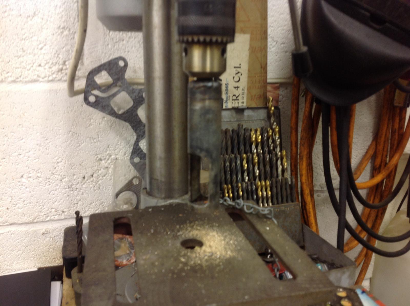

alf892 Posted November 1, 2016 Posted November 1, 2016 Valve spring compressor available in Northamptonshire if required. Also got a home made attachment so you can use a pillar drill.......I could post that. Mind you easy to make....... It is just a piece of pipe with the sides ground through and a bolt welded in the top....then you just need a piece of wood to level the head up.
