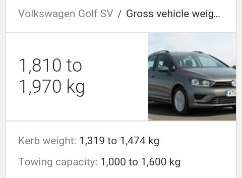

Captain Furious Posted October 26, 2016 Posted October 26, 2016 So, let me have one last go at getting this straight.. If you have a pre-97 licence with B+E, as I do You can tow a trailer even if the MAM plated weight exceeds the train weight of the vehicle, providing the actual weight is less. eg if the cars train weight allows for 1800 KG and the trailer is plated at 2200KG it is OK as long as the actual weight on the trailer doesn't exceed 1800 If you have a new(er) licence - 97-2013 with just B entitlement You can tow a trailer as long as the PLATED MAM of the trailer and car don't exceed 3500KG combined - eg if you had a car with a MAM of 1800KG and a trailer with a MAM of 2000KG then you couldn't tow it, even if it was only loaded with balloons and the actual combined weight was less than 3500KG If you have a really new licence, 2013 onwards I have no fucking idea... Faker 1
Faker Posted October 26, 2016 Posted October 26, 2016 So, let me have one last go at getting this straight.. If you have a pre-97 licence with B+E, as I do You can tow a trailer even if the MAM plated weight exceeds the train weight of the vehicle, providing the actual weight is less. eg if the cars train weight allows for 1800 KG and the trailer is plated at 2200KG it is OK as long as the actual weight on the trailer doesn't exceed 1800 If you have a new(er) licence - 97-2013 with just B entitlement You can tow a trailer as long as the PLATED MAM of the trailer and car don't exceed 3500KG combined - eg if you had a car with a MAM of 1800KG and a trailer with a MAM of 2000KG then you couldn't tow it, even if it was only loaded with balloons and the actual combined weight was less than 3500KG If you have a really new licence, 2013 onwards I have no fucking idea...Correct!
Faker Posted October 26, 2016 Posted October 26, 2016 Post 2013 tested require C1+E to exceed 3.5ton gross. Pre 2013 only require B+E.
Captain Furious Posted October 26, 2016 Posted October 26, 2016 So basically, without B+E, you aint towing a car trailer legally. The lightest ones they hired near me were MAM 1800KG and even if you had a car light enough to keep you below 3500KG its train weight won't be high enough to tow it. Faker and Nicola H 2
Faker Posted October 26, 2016 Posted October 26, 2016 There are lightweight transporters out there. Single axle Brian James and Woodford with mam of 1300 / 1400kg. They usually weigh about 300 - 400kg, which give a payload around a ton. Correctly positioned and loaded on the bed with a suitable tow car would keep you legal. Eg. Find a suitable vehicle with 2ton gross vehicle weight, that has a train weight of 1400kg. It's near the knuckle though.
