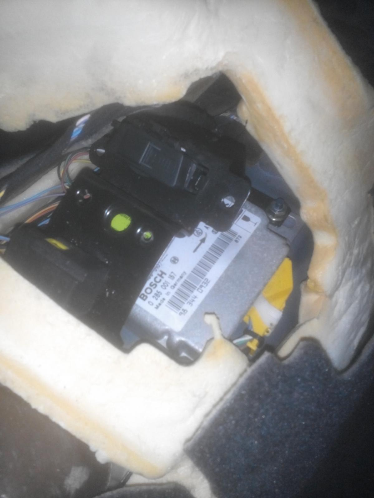

​I assume this is the airbag ecu..

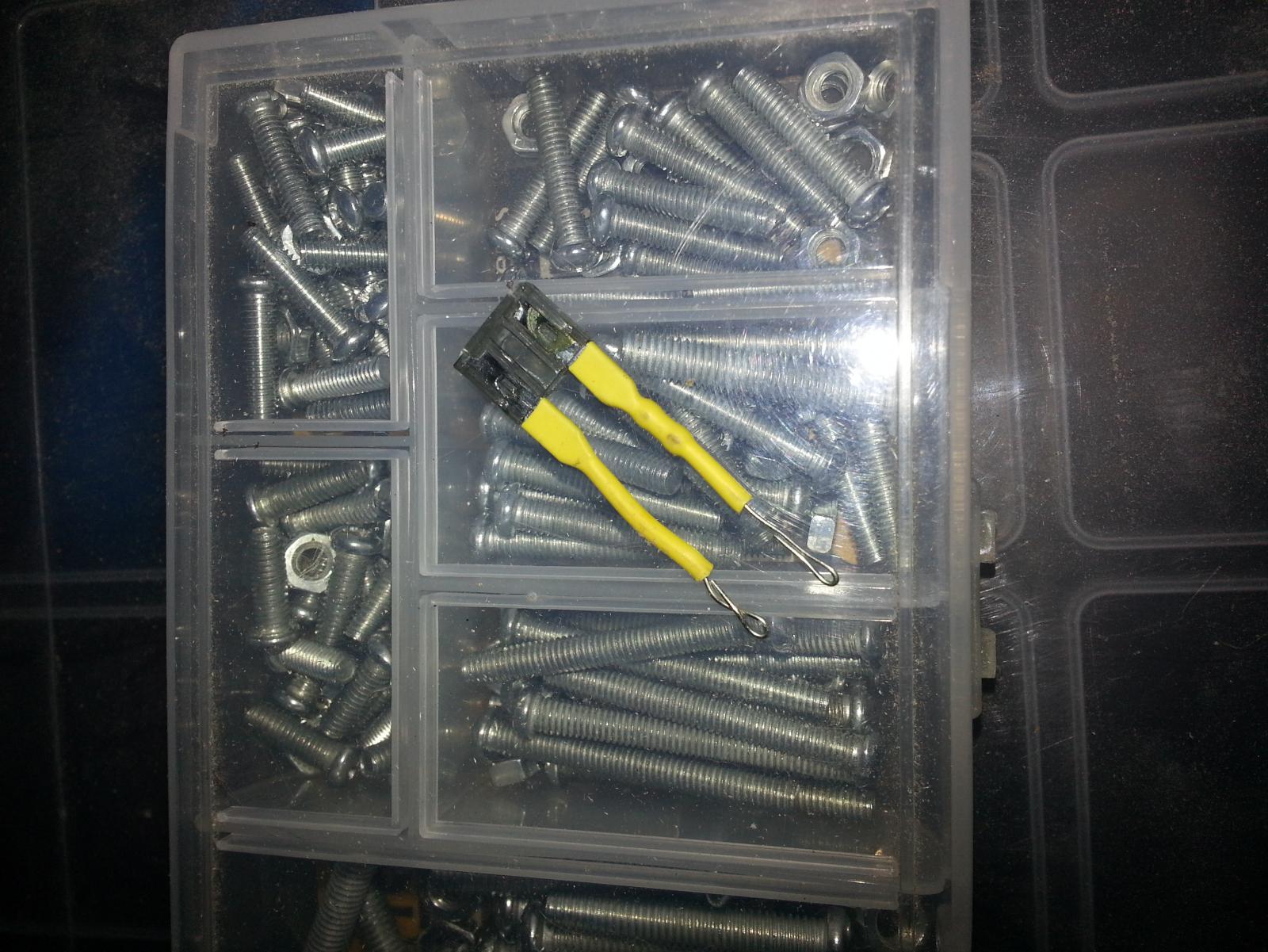

Resistor on the airbag connector F T W.
Look like dis:
Used on my MG ZArse

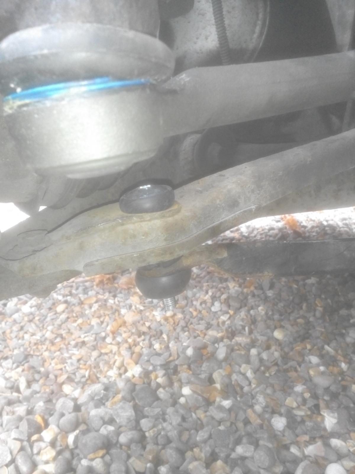

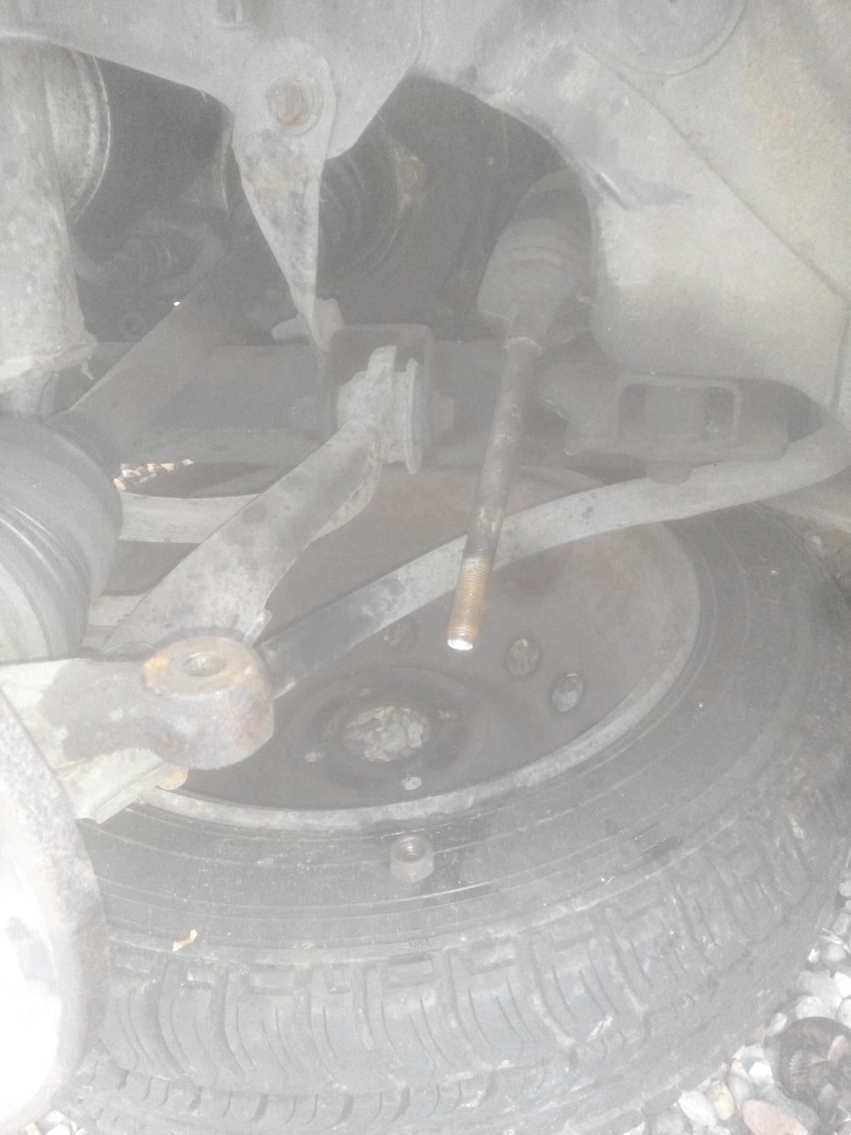

Started on this today working on the fail list,  Main points are the drivers side track rod and anti roll bar linkage, decided to do both sides as parts were cheap.

The airbag brain from memory is under the cup holder in the centre console (was in mine). Drips and spills can take their toll on the brain... You'd be as well taking it to a dodgy spark. Diagnostic device to show which tensioner, detonator, contact is at fault. Then said dodgy spark can wire in a transistor to replicate dodgy part. Has been done in the past for mot and worked.

I've located the airbag ecu, this clio is nice and basic, no fancy cup holders and the ecu looks fresh, which was a disappointment  as I'd hoped for an easier fix..
