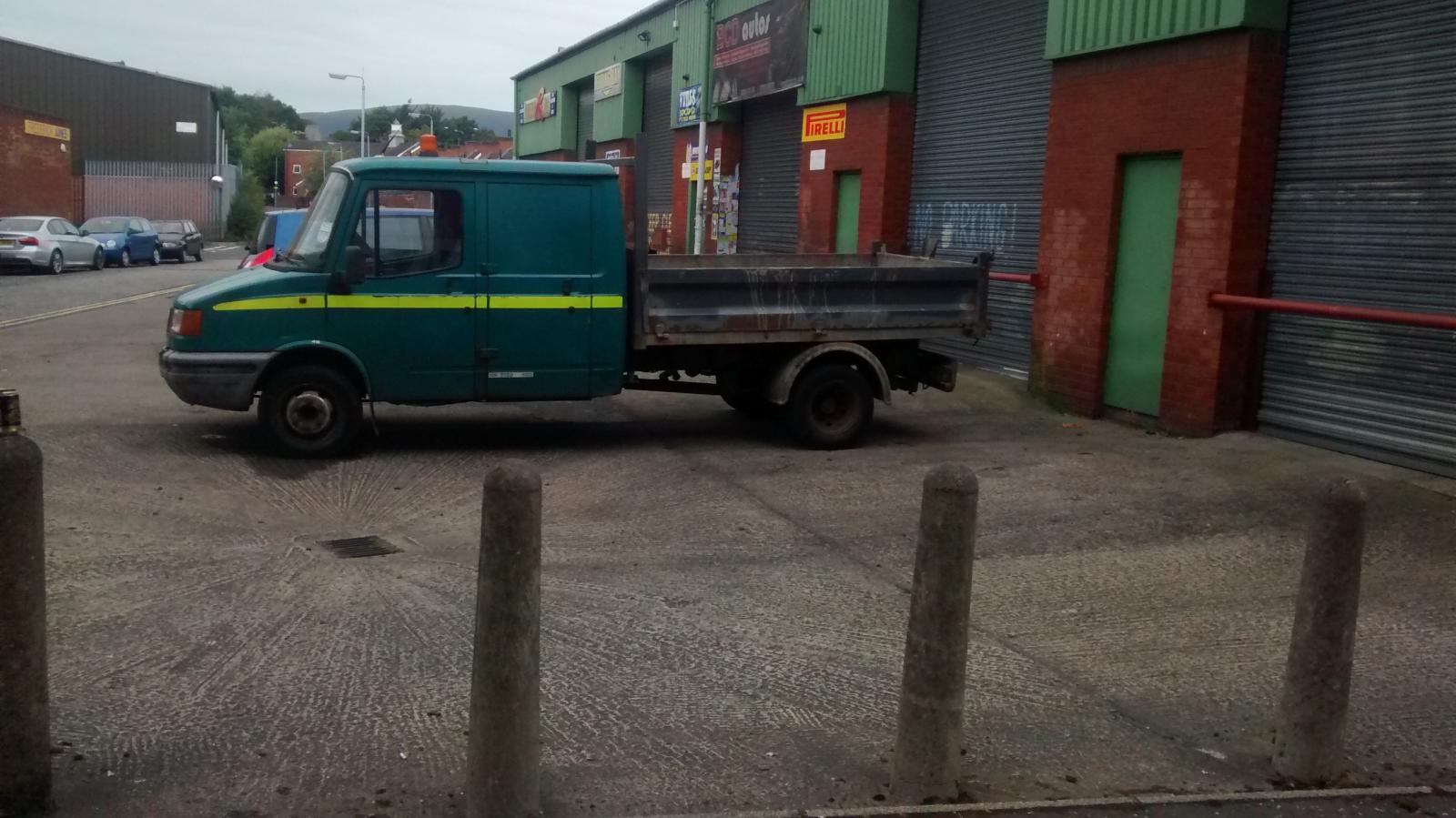

hairnet Posted September 18, 2016 Posted September 18, 2016 Well done, that ramp looks fun*. My 75s handbrake is poor remind me to never topdeck a ferry Had one of those on the French ferry Visa coped fine Was here this morning - didn't see any xms just a shonky ldv They_all_do_that_sir 1
