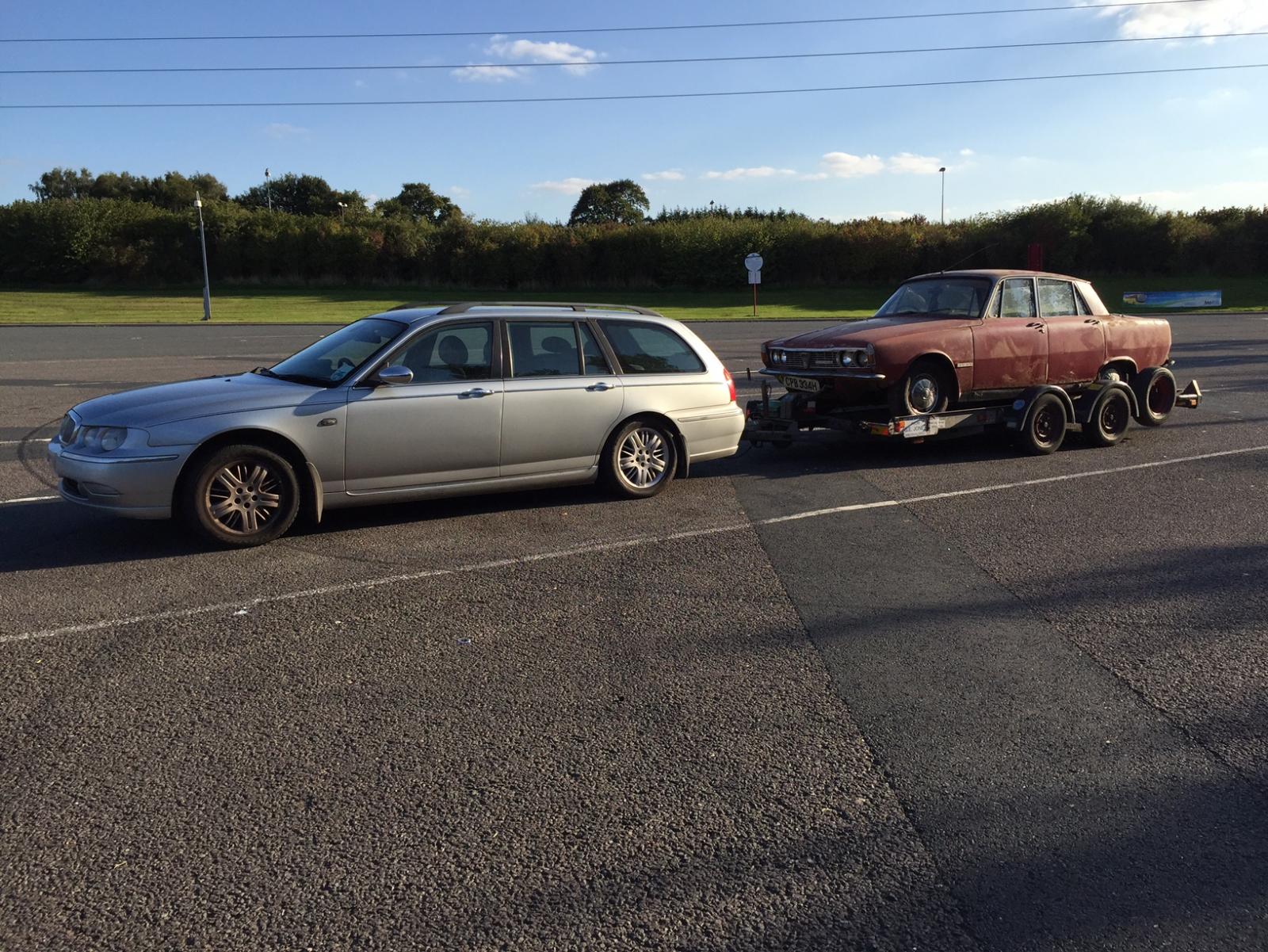

Too much work for my long suffering 75 really but here she is with my rescue p6 having hauled it 200 miles up hill and down dale. She earned her keep that weekend!
