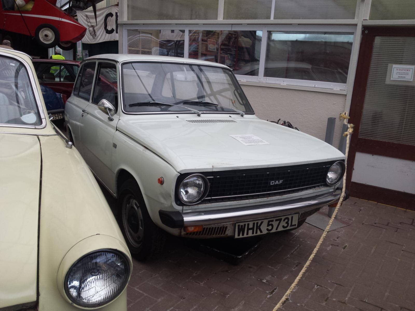

Popular Post wuvvum Posted August 27, 2016 Popular Post Posted August 27, 2016 I am at Kings Lynn auction. It is the day after pay day. Whoops. michael1703, Jim Bergerac, The Moog and 54 others 57

wuvvum Posted August 27, 2016 Author Posted August 27, 2016 55 saloon wouldn't start though. Trabby was rough and 1500 had no test so the white Daf was the one to go for I reckon.

wuvvum Posted August 27, 2016 Author Posted August 27, 2016 Further jottings: it won't change gear. Bollocks. Any ideas? The hill hold light is going off as expected but the ratio isn't changing.
