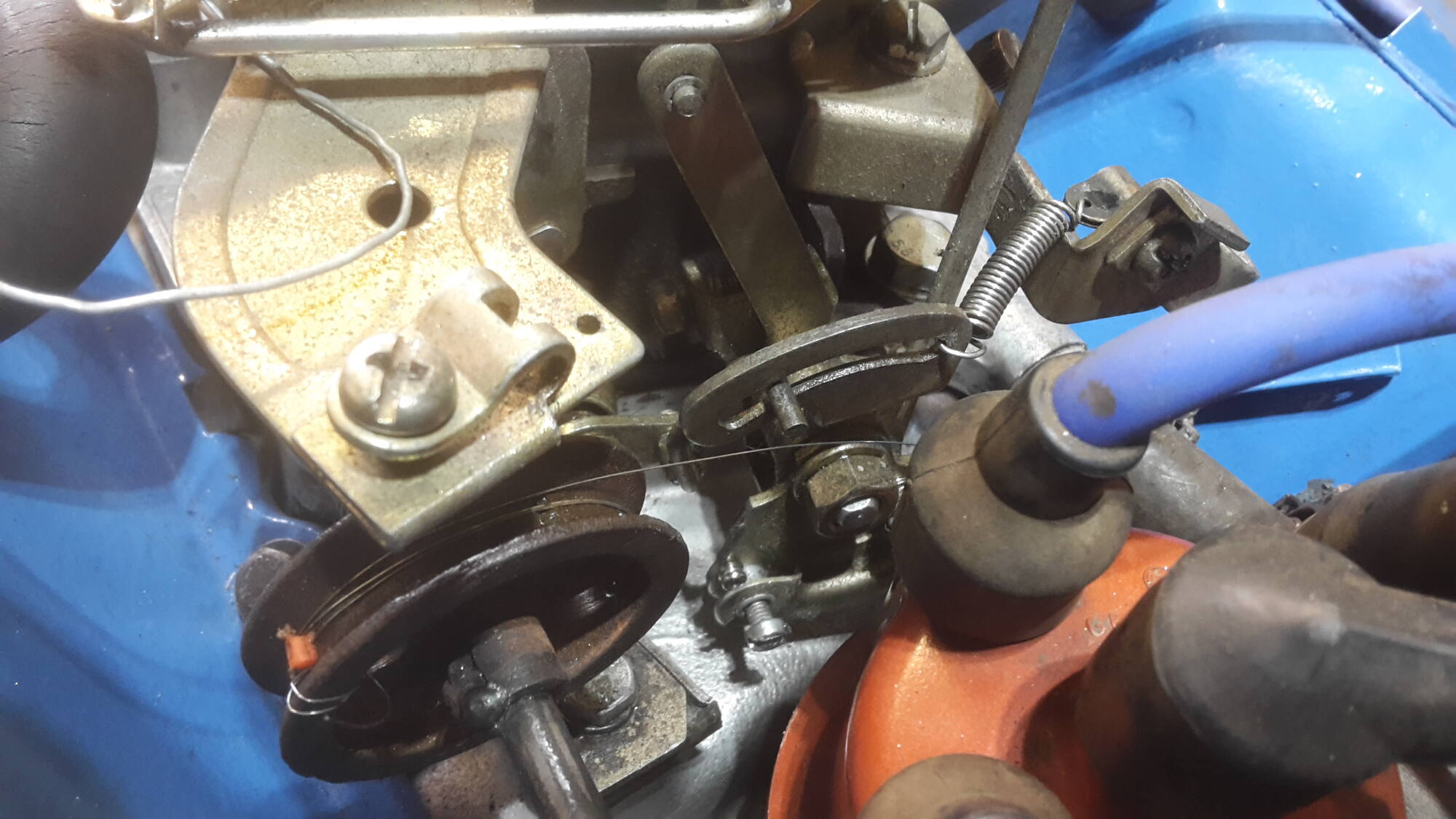

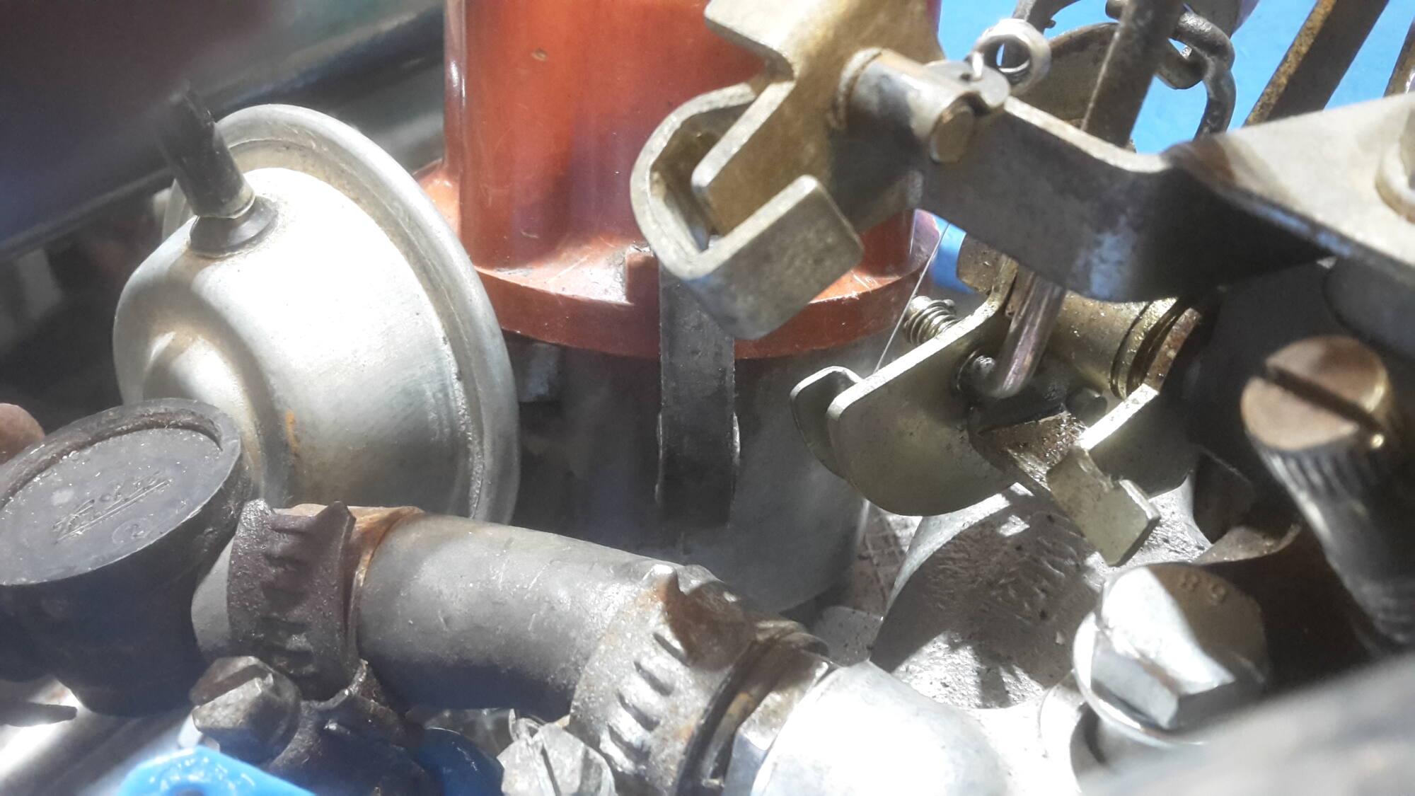

My plan to use a meccano wheel as part of the throttle linkage came go nought, darned things are pressed out of three pieces of brass and quickly fell apart, so used a wheel from a sash pulley instead. Then I had a lot of bother with the bit of bike cable I was using, far too stiff and heavy.
The throttle linkage is very lightly sprung on these Nikki carbs, especially the primary, I guess that helps get a nice progressive pedal. So I used a guitar string instead...a top E to be precise, I've also added another throttle return spring to get the throttle to snap shut against the idle screw.
Piccy shows sash pulley, E string and nylon peg holding string in place.
You can see a shiny little screw at the bottom middle of the pic, that's the one that would normally tighten onto the cable, no chance in that position, so I threaded the guitar string the opposite direction. It's quite safe now as the guitar string is very light and if it breaks the engine will just idle.
You can just see the string at the end of the throttle linkage quadrant here, at the right hand base of the rotor cap.

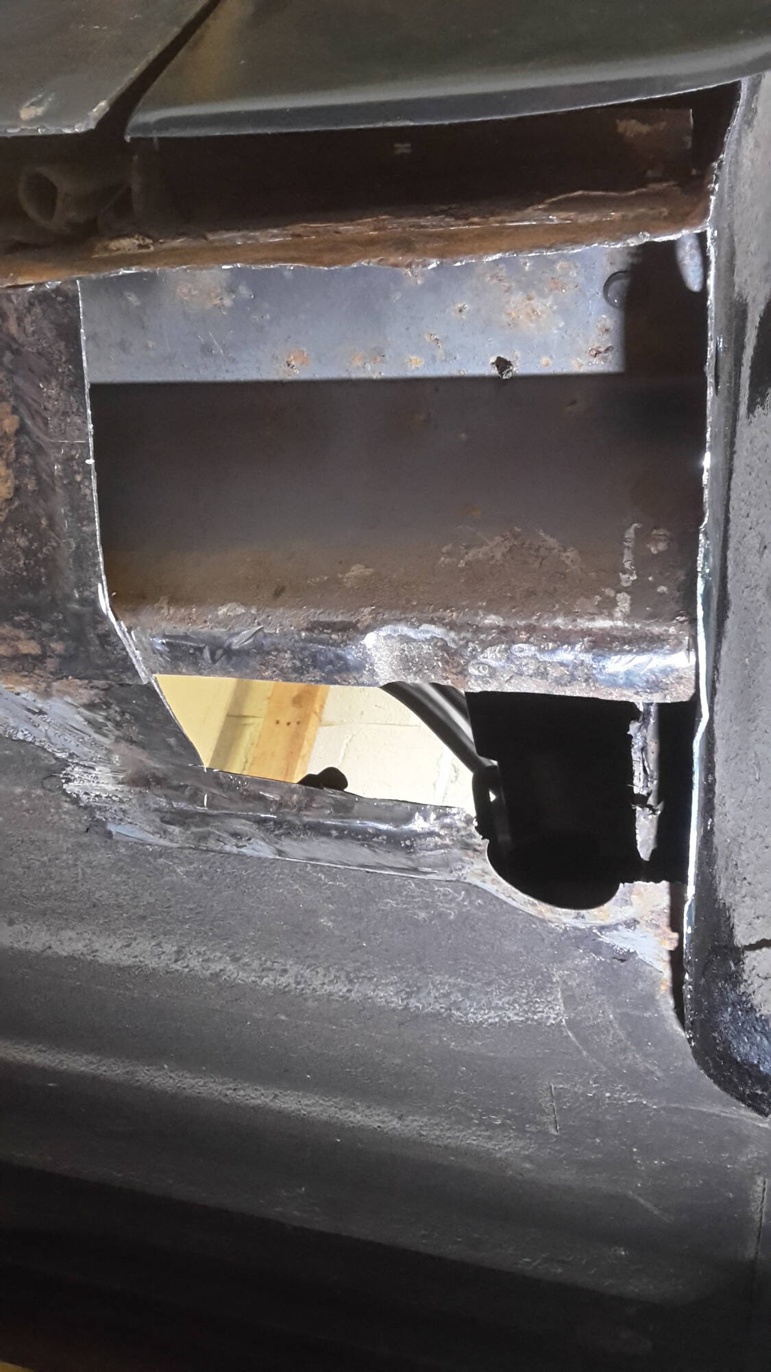

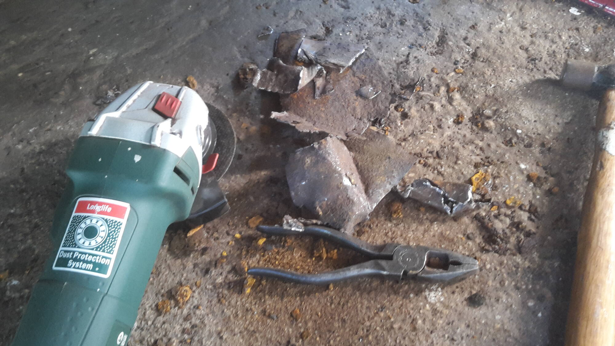

OK, back onto the Saab again the last couple of days. The holes in the floor were worse than thought- funny that.
However, reserves of enthusiasm and a pair of scissor ramps brought in and work done.
As always fabrication was classy but weldage, especially in the upside down position a bit snotty.
A crusty hole becomes a squarish sort of bigger hole.
First patch,  welding especially crud on the bottom. Welding slightly better from topside.
These Saabs are strong, some of that floor is 1.2mm, 18 swage? They will take having large chunks ripped out without any sagging. Most 70s tin wouldn't allow for that, the Austin 1800 was a strong bugger and other Swedes.

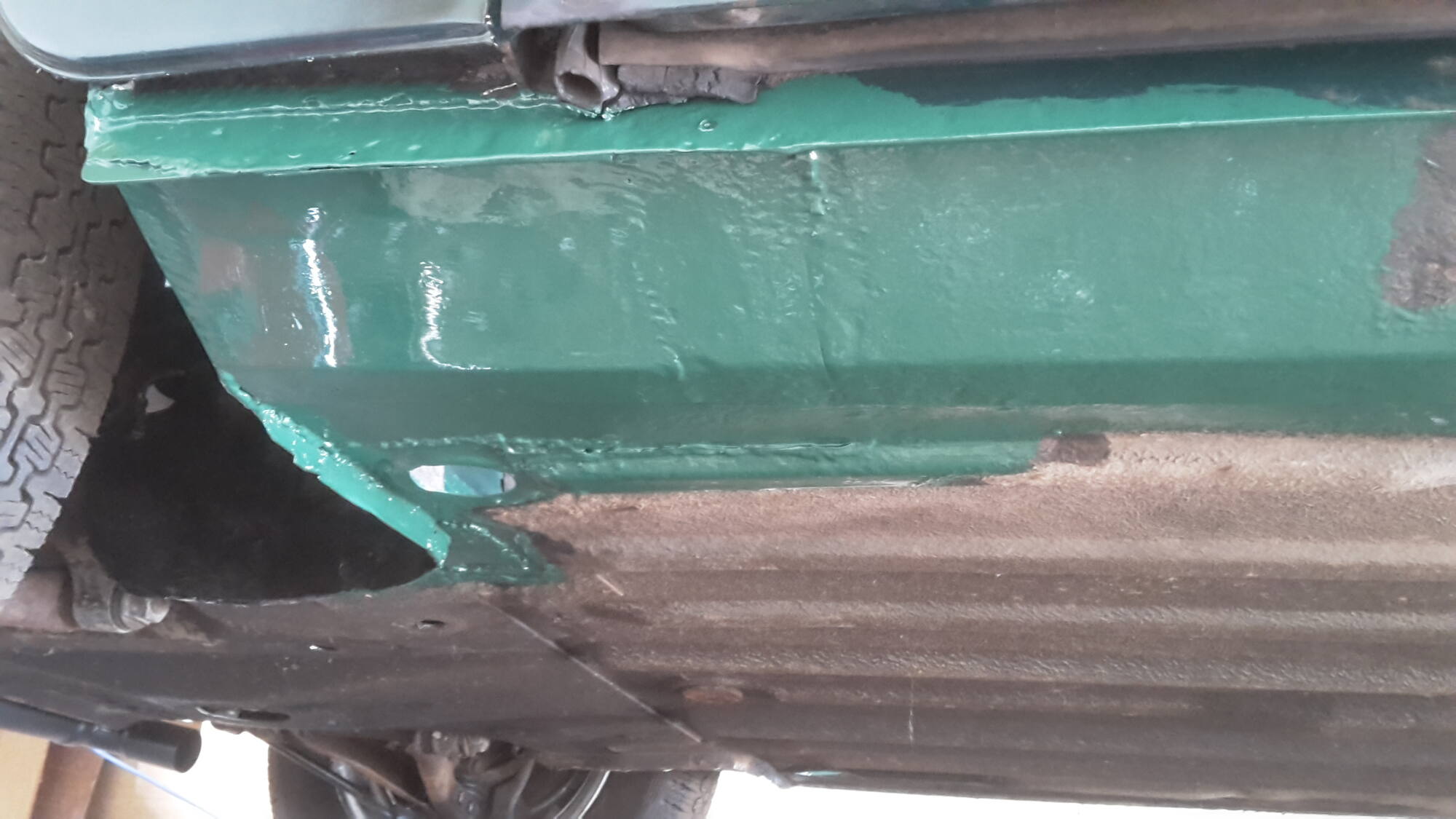

Welding done- for now. Will get inside and tidy up the plug hole with a die grinder. I have lots of different bungs. The hole at the front of the sill will be pumped with cavity wax before it's plugged.

Welded up passenger side footwell. The hole was big, much bigger than it was supposed to be, nonetheless some high-end fabrication  happened, followed by some less expert welding and all was made good.
When plates are welded straight over the top of rusty holes it just accelerates the corrosion process- just say no folks. Get it done right. Condensation forms in the cracks and even if cavity wax or similar is used it struggles to get in there. Any type of lap joint is a bad idea really.
