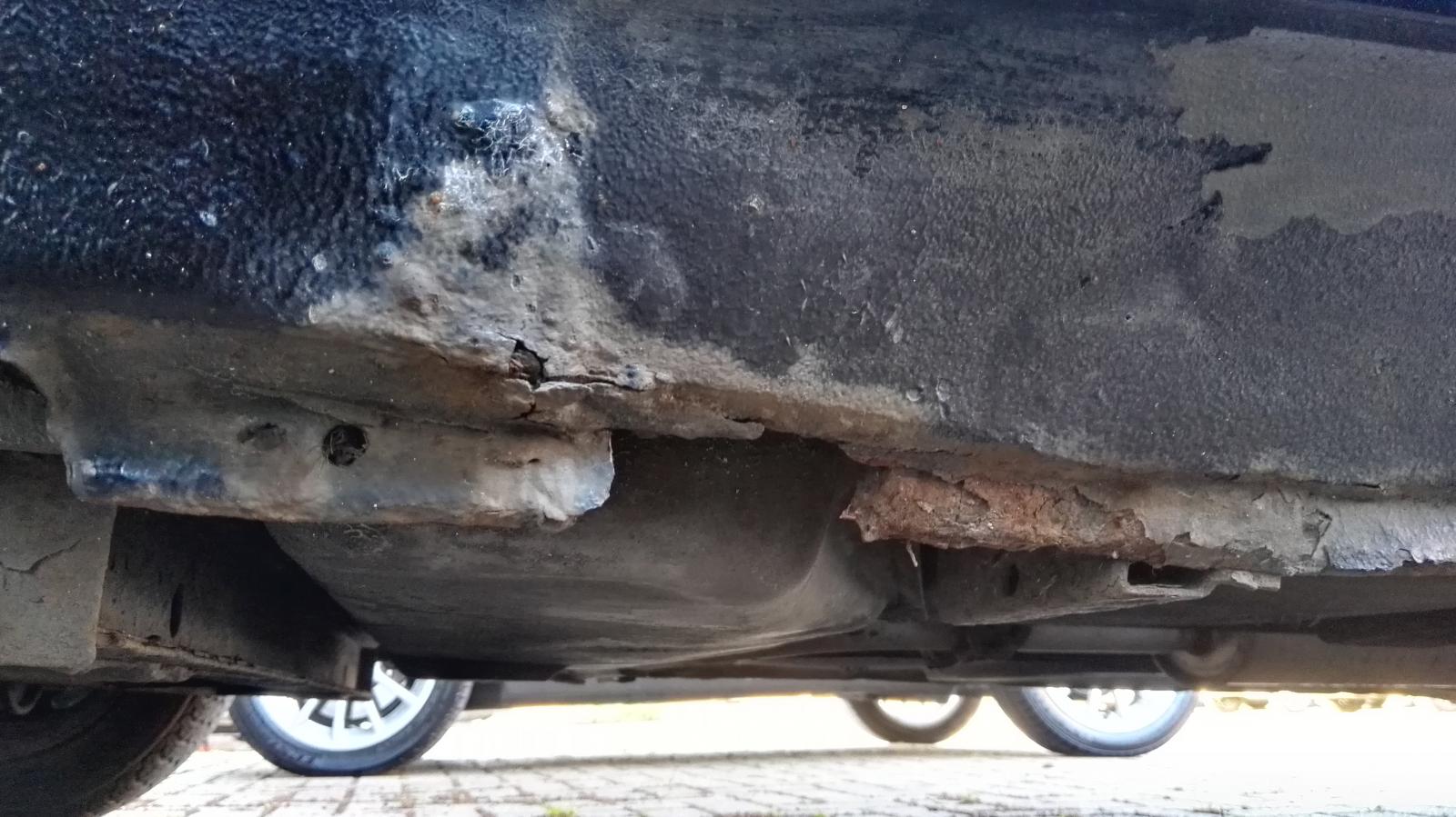

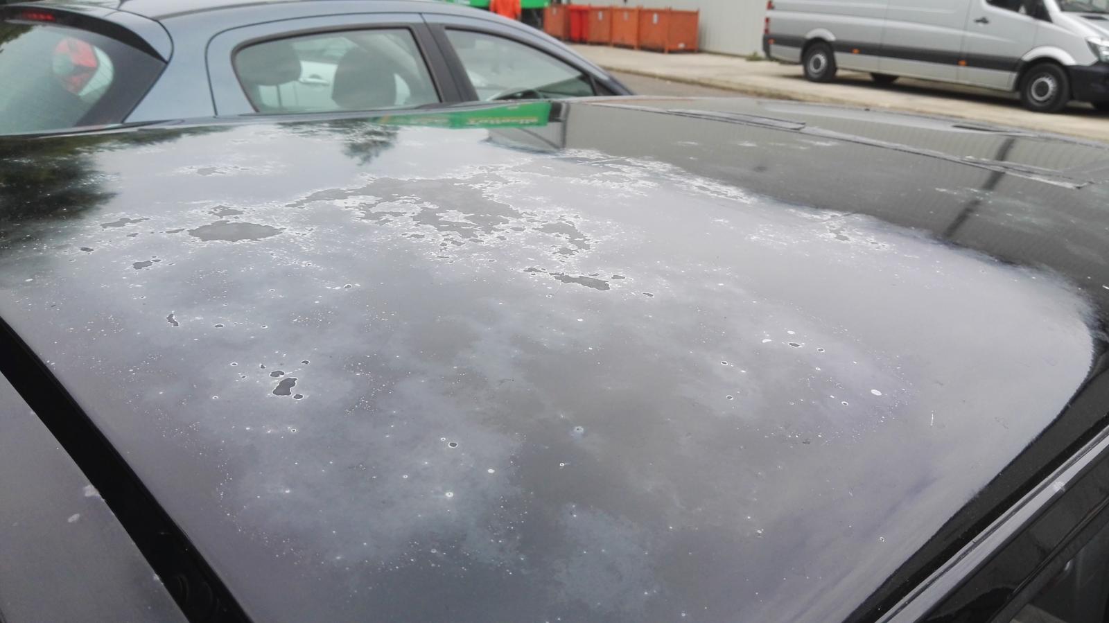

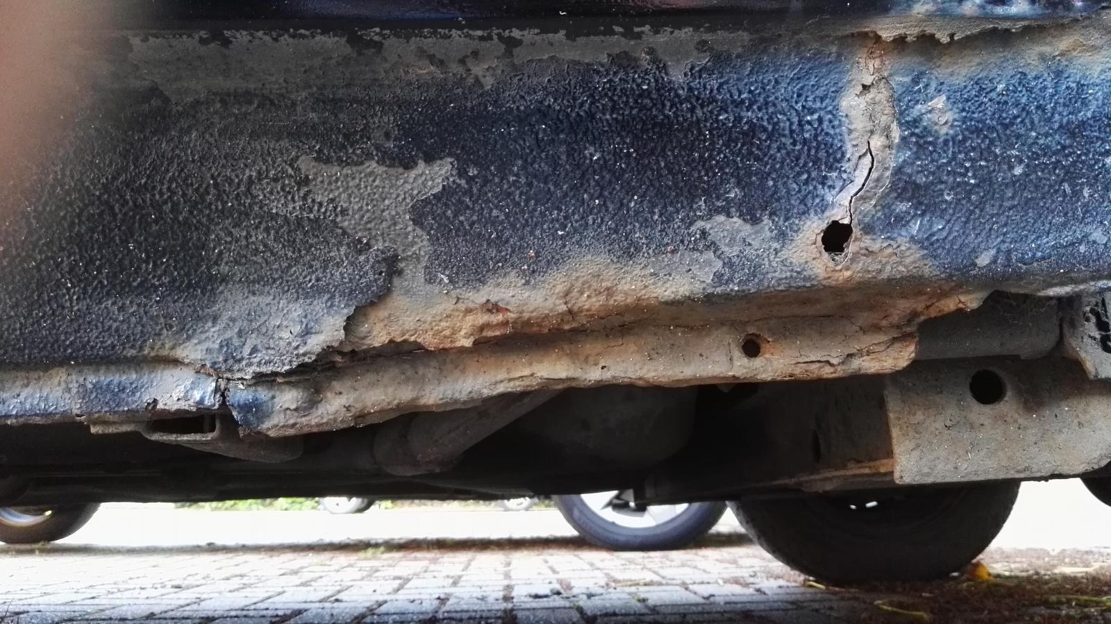

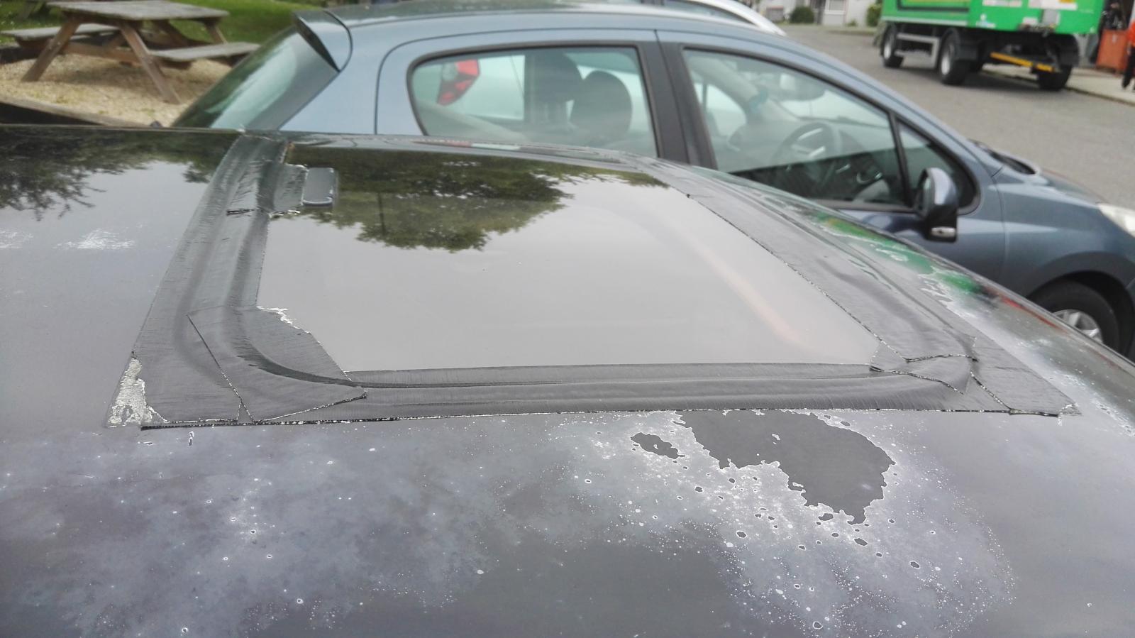

This is why you view a car before buying....
Anyone want a metro / welding project?
Crispy, and there will be more where that came from you can bet your bottom - but if its a keeper then its worth doing properly and breaking out the grinder.
