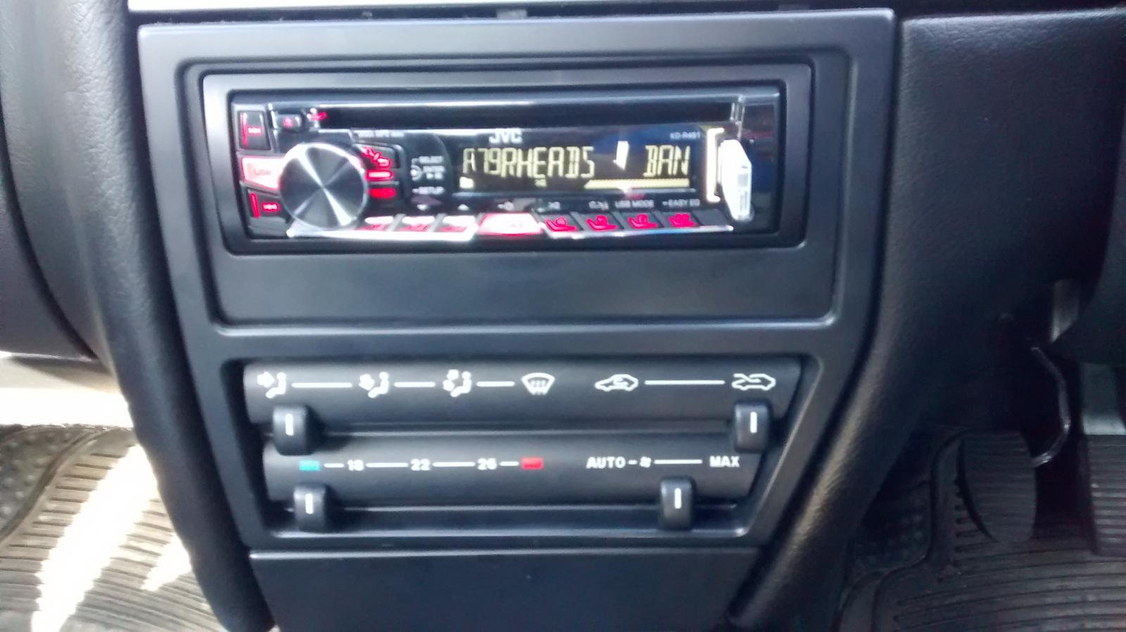

Looks almost professional...
No, I don't leave it intact, I take the faceplate into the house when I'm not in the car.
So scene it's obscene.

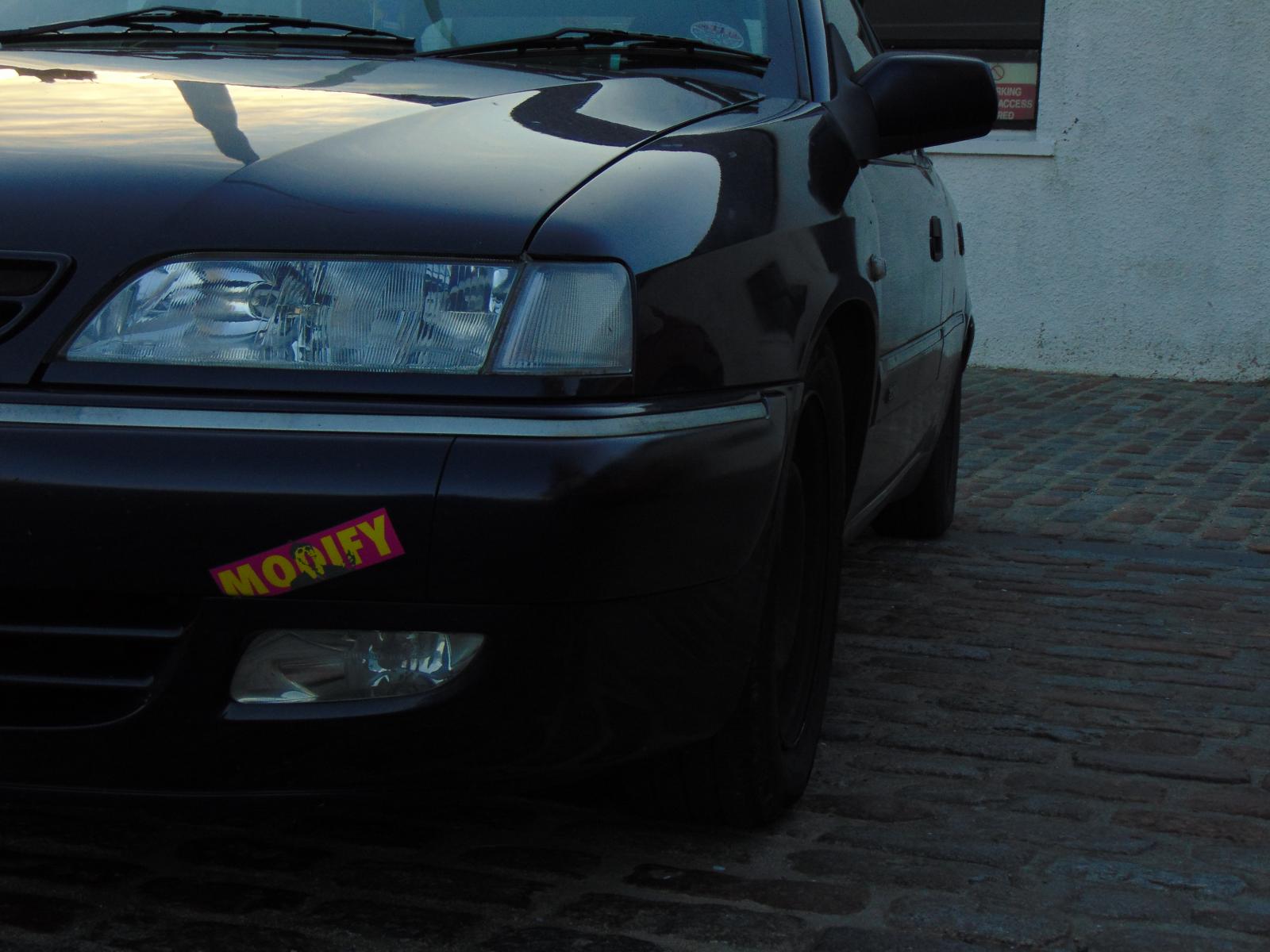

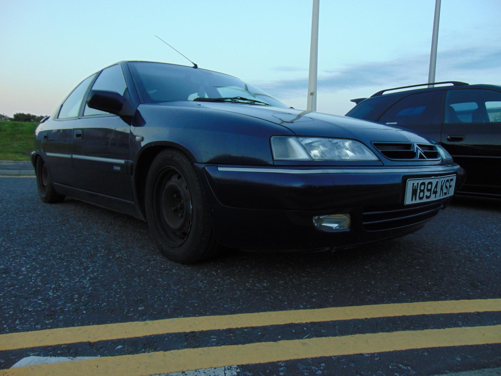

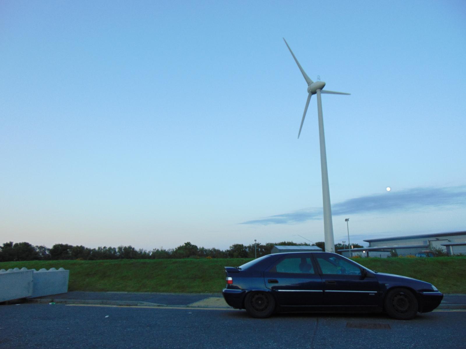

Arty farty photos of shite.

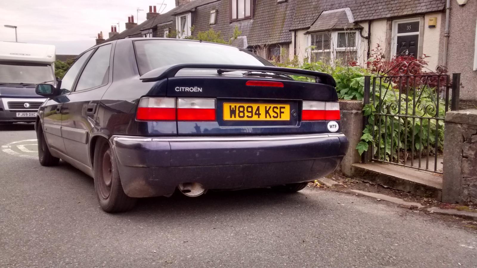

I've decided I shall try to restore this to a presentable condition now. I was underneath it on Saturday and it's fucking MINT on the underside. Not a spot of rust anywhere, and the exhaust system is very fresh looking too.
Ideally, I need both bumpers (although the front could be salvagable with just a bit of trim, the rear is a priority) and a left-rear door, plus a whole fuckload of t-cut!
Also on the lookout for a steering wheel and a driver's seat, but I could always fit parts from other Citroens of a similar age.
I think I'd like to do something with the wheels too. Any suggestions for nice wheel trims? I'm thinking something retro looking, or even metal... 15" in size.
My main question is - where could I source these parts from? I've put a wanted thread up on the French Car Forum, but I'm also thinking that surely there must be a Citroen breaker somewhere between Aberdeen and Buckinghamshire that I could swing past on the way to/from shitefest?
For those concerned, it's an SX model with purple / blue velour interior, and the paint colour is apparently Mauritius Blue.
