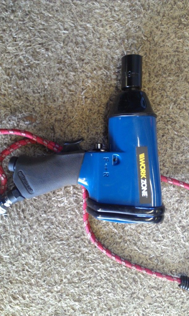

Royale80 Posted April 16, 2016 Posted April 16, 2016 Afternoon all, Popped into local Aldi's this morning and picked up this impact wrench for £19.99-came with an inline oiler and quite a few impact sockets all nicely packaged in a handy case- Gun is quite heavy. I was a little sceptical as I only have a small compressor that I bought from Aldi' years ago for £60. I connected it up using my big hose-I added this years ago-its the right hand one.-It easily removes wheelnuts from my Royale. So for £20 - quite impressed! Steve Tam and DeeJay 2

sierraman Posted April 16, 2016 Posted April 16, 2016 I've recently invested in an impact wrench, I'm not going to say its changed my life but it's certainly made jobs like strut swaps and exhausts a realistic possibility at home. Something I'd use probably every couple of months but in those occasions it's very useful. I'd restrict its use to high tensile stuff like crank bolts and suspension bolts, with 450nm it's likely to shear lesser bolts clean off.

Dead_E23 Posted April 16, 2016 Posted April 16, 2016 I had a cheapo impact wrench and found that over time it lost the ability to undo tight nuts despite me putting a fair amount of oil through it. Anyone else had a similar experience? I think mine was a Clarke, from one of those 'bumper air tool starter kit' sets that they sell in Machine Mart with useless shit like a paraffin gun and a coily extension pipe made of stiff plastic. I've since bought a huge box of O-rings, and next time I find it I intend pulling it to bits to see if it has been chewing them up. I'll probably still buy one of these ones from Aldi if I'm passing. At that price it would be rude not to!

Royale80 Posted April 17, 2016 Author Posted April 17, 2016 Used the wrench in anger today. I'm replacing the insert on the front strut of my Royale-the shocker is seizing.. Tried removing the two ball joint nuts-they wouldn't budge-so gave the wrench a go. Easily undid them so well impressed. Stuck at the moment though as my screw type ball joint remover is too small for the ball joint holding the strut to the lower control arm. Will get a fork type splitter in the week. Steve

sal Posted April 17, 2016 Posted April 17, 2016 I bought one about a year ago. Was ok to begin with and undid wheel nuts easily but after a bit of use its shite. I'm running it off a 100 litre compressor with 1/2 inch hose and fittings and I oil the gun before every use. I got it for £10 towards end of the offer when they were clearing stock so no big loss. I've read many folks are happy with theirs but mine isn't great.
