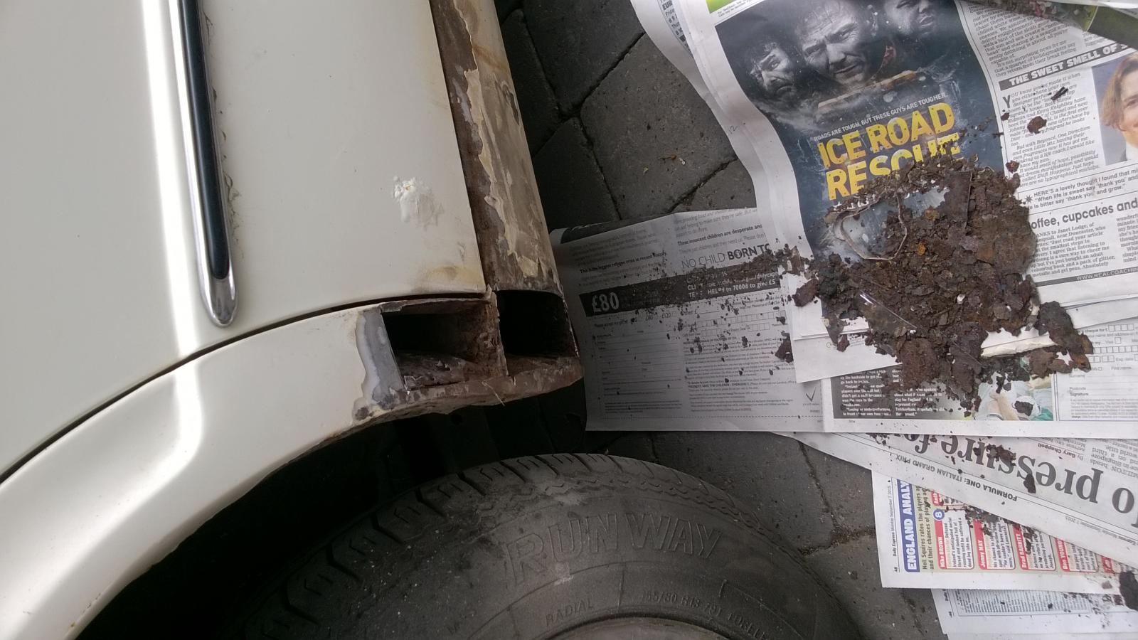

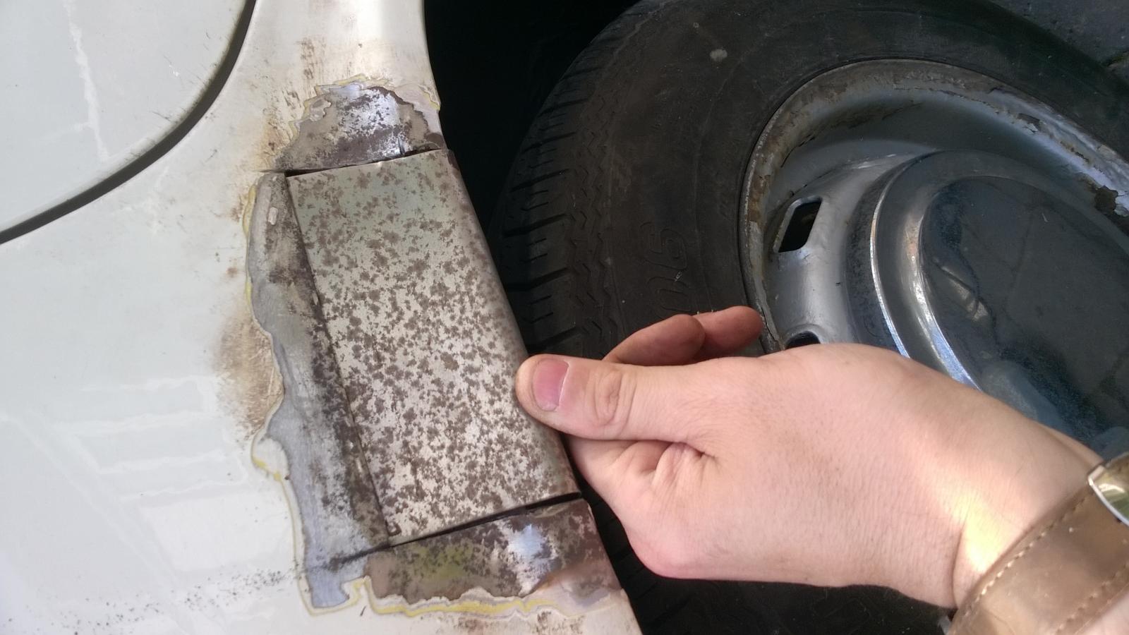

Had a go at the rear arch/ sill area this morning. There was a large area where the paint had lifted but after a clean back it just needed two sections letting in. I got it all cleaned back and cut some new metal and welded in, well started to but it began peeing it down so had to stop. Filled the sill with dynax as well, all looks good inside when I stuck the inspection camera down. Before I started on that I had replaced the small hose that goes between the thermostat and inlet manifold and replaced the pinto gasket for a dolomite one so should be water tight now. I also fitted the 'new' clutch master cylinder cap I got. It's battered but in one piece. I would have taken more pics but was too busy rushing to get everything in and out the wet. Will have a play at dropping the steering column out later if the rain stops.

That looks pretty reasonable. I have seen/had/sorted MUCH worse than that.
Good progress mate.
Great work

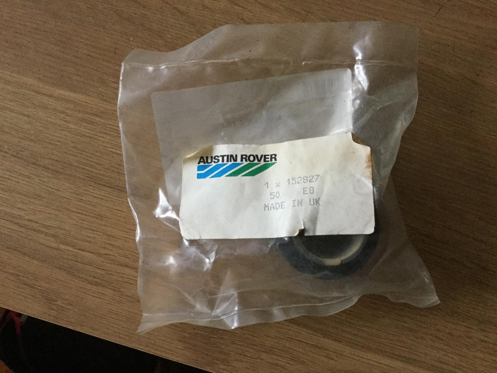

post-19712-0-14156300-1462128407_thumb.jpegpost-19712-0-00640800-1462128429_thumb.jpeg Working between family commitments and stupid arthritis I have done some more tonight. The steering column came out reasonably easily. As suspected the column has an extra lower bush just sitting on the column, presumably in some weird idea that it would replace the lower bearing. The bushes on the column were worn on the nylon insert but fine on the metal and rubber bits so I just swapped over the inserts. There might be a reason this is a bad idea but I can't see one. All is good now. And what about the NOS Austin rover bush? Bought from Rimmers last week.

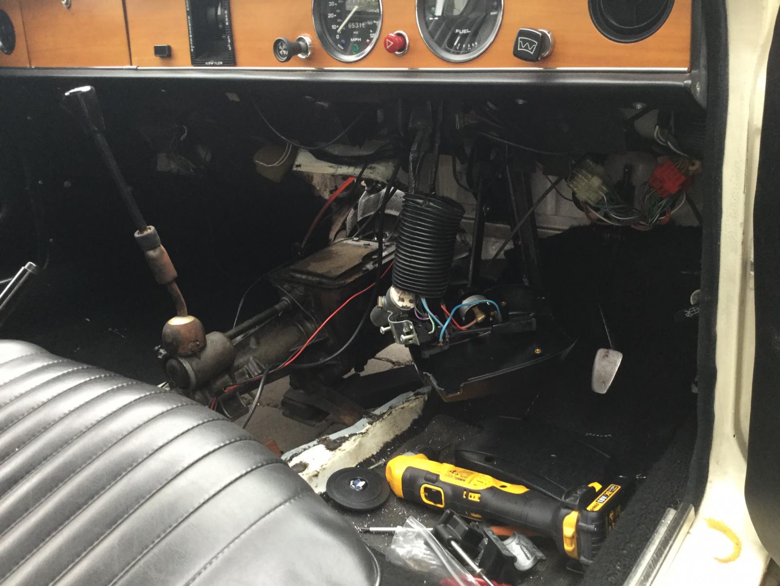

Went to put the tunnel back in only to realise that I had run a cable UNDER the clutch cylinder pipe instead of OVER so will have to drop the slave out again. Just had a bath so decided to switch to a couple of cleaner jobs. The awful rear speakers are now out, after fiddling about for fifteen minutes to get the rear parcel shelf out I found that the speakers were securely attached with...... Double sided sticky tape! Just wondering what's best to get the sticky residue off with that won't eat the vinyl. Then tried to remove a couple of the window trim clips. Little bastards are well stuck and needed drilling out. Then looked at the wobbly drivers side mirror, it has been fitted with the favourite structural adhesive of all BL owners - silicon sealant! I can find my rivnut tool but not the rivnuts, so have called it a day and tidied up my workbench instead.
Moved the cable and got the tunnel back in easy enough. Had to stop there as my arthritis in my neck is giving me hell today :-( will refit some more stuff tomorrow. The tunnel is enormous, presumably to allow the bell housing to come through as I can't see how the box could come out underneath with the subframe in place. E lad, they don't make em like that anymore.

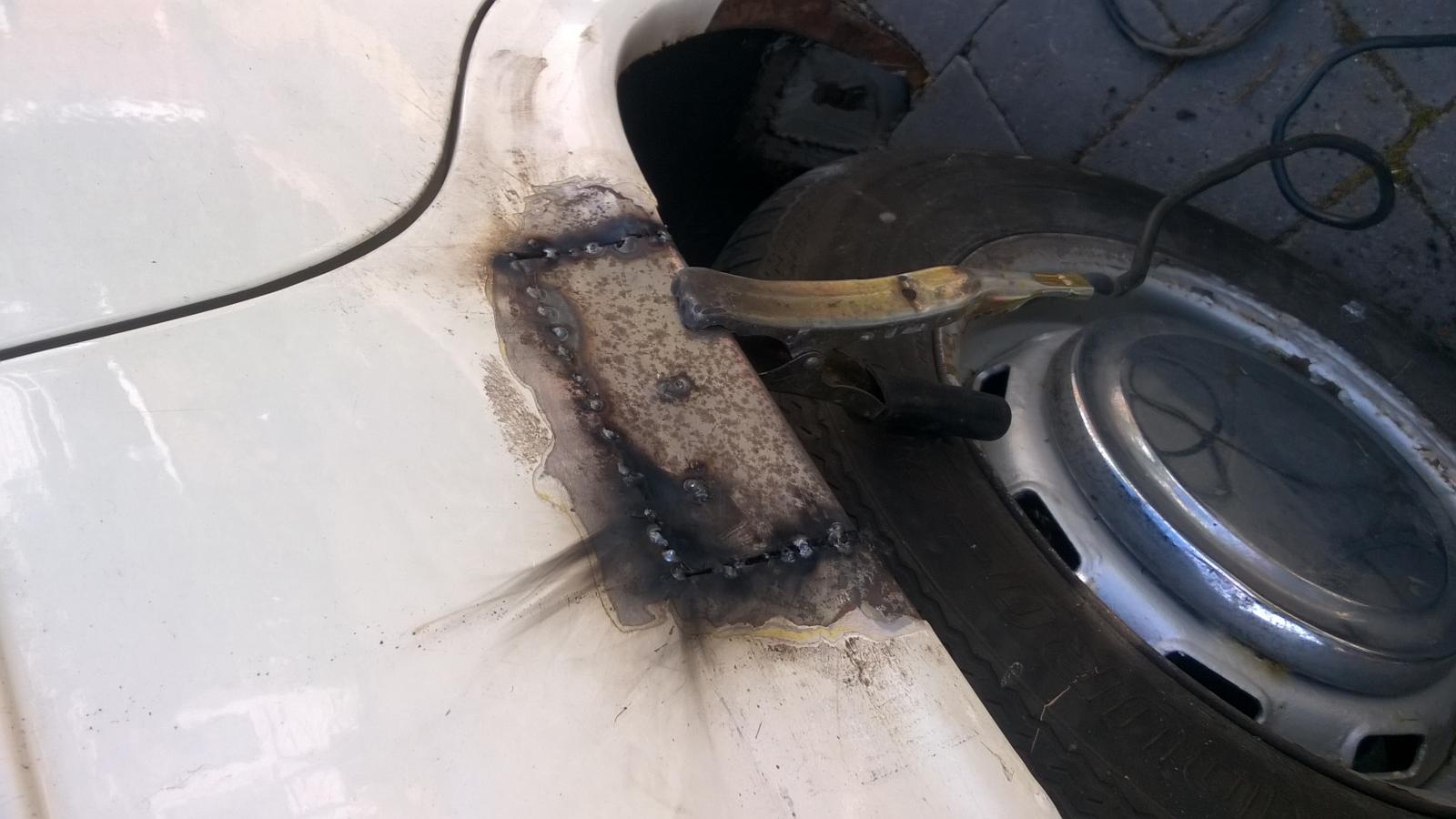

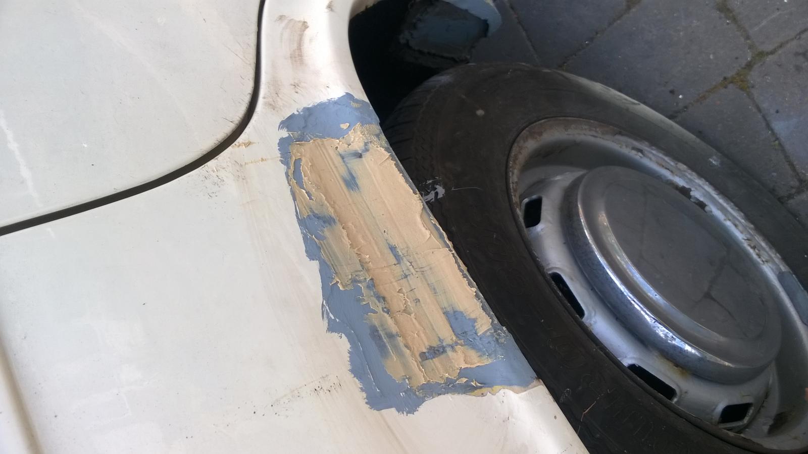

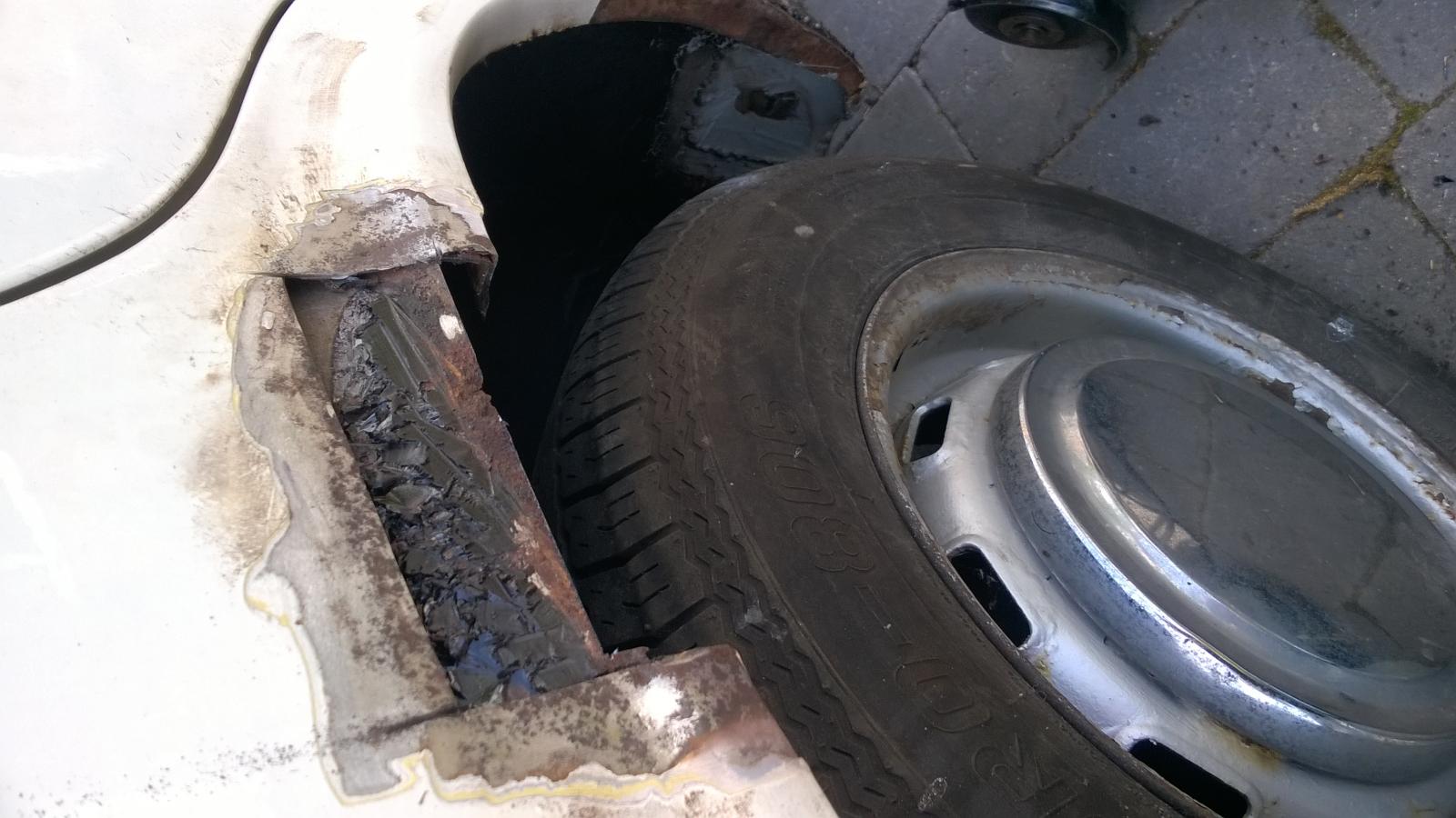

So moved on to the hole in the rear arch. Sun was shining and welder was playing ball so fairly swift progress was made, even still it takes longer than you would think. I ran out of time after the first very rough skim of filler but will keep tickling it over the coming days until I get it looking nice.
