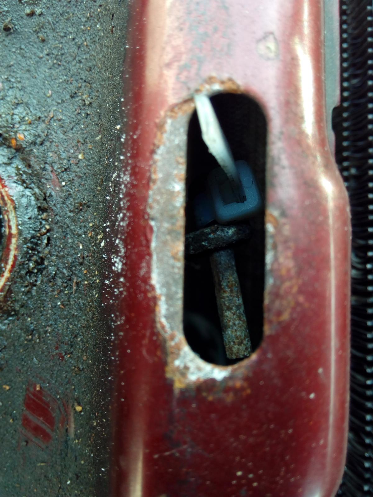

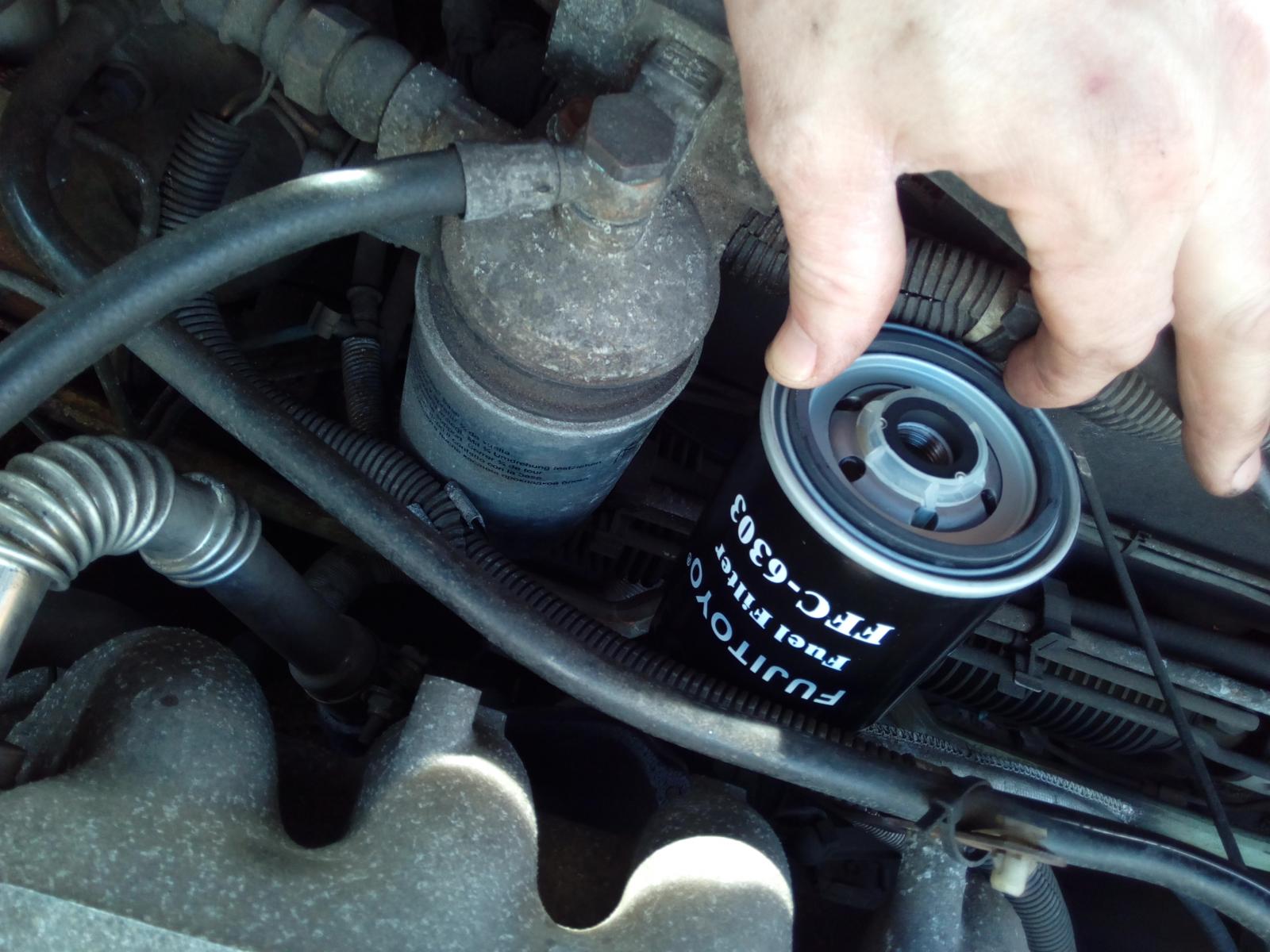

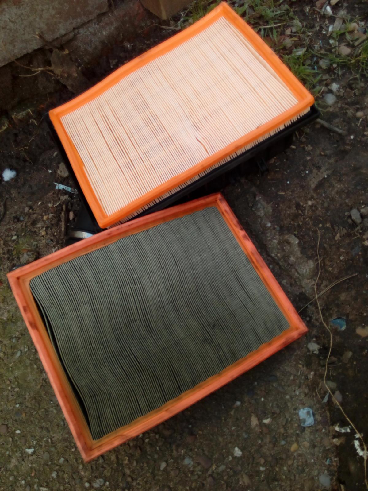

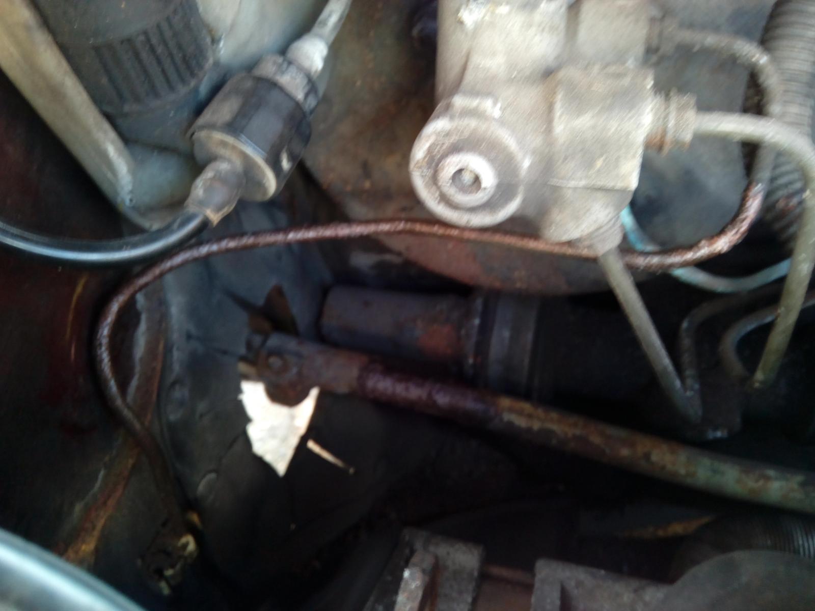

Had a rewarding day carrying out some maintenance on this. First problem was the battery didn't have enough juice to turn it over but not surprising after being unused for 3 months. Jump started it off my 406 and got it on the drive where it ran out of diesel. Put another gallon in it and and then found the bonnet release wouldn't work. Finally got the bonnet open using some pliers on the cable and used a cable tie at the bonnet end to effectively shorten the cable which worked. I was pretty chuffed with my bodge. Another jump start and I was away. Changed the thermostat and ran it up to temperature and the fan didn't cut in so that brings me up to diagnosis of the faulty fan switch with the help of the hbol and you lot. I also rubbed down and greased the brake pipes and power steering pipes. Changed the oil and filters too and tightened the fan belt which was squeeling now and again. It was a satisfying day. This car is so easy to work on with everything accessible. It's a shame I no longer really need it anymore. I'm going to run it for a bit and see but will probably offer it on here. Being a shiter though I want to fix a couple of things first mainly get some waxoyl under its back end!
