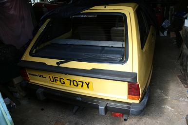

Christine Posted March 4, 2016 Posted March 4, 2016 I know blue and red cars are buggers for fading , how about yellow? Number of Broom yellow? Fiats with mismatched panels or bumpers is amazing . Wanting some A77AG 19K512 Jasmine yellow for my fiesta , i've bought 3 , 1 litre cans ,non of which match... Even matched a swatch but it seems miles out . Should i use white primer instead of grey ? Front wing see...
Rocket88 Posted March 4, 2016 Posted March 4, 2016 Early water based paints of any colour were prone to fading, I'd use white primer with yellow..................not that I've got any idea why.
danthecapriman Posted March 4, 2016 Posted March 4, 2016 I think the coverage is weak with yellow paint, so if you use dark primers (red, grey, black) it takes a lot more paint to cover it, the edges of panels, corners etc don't cover well, and the colour of the primer/base coat tends to alter the top coat yellow shade.White primer I would think will work best as it's a lighter colour than the yellow top coat.

vulgalour Posted March 5, 2016 Posted March 5, 2016 Yellow is notoriously bad for matching and, in some cases, prone to fading. Primer type does make a difference, yellow is almost always quite an opaque colour no matter if you're using car paint or acrylic artist paints or whatever. The big bonus to yellow is that it hides a multitude of bodywork sins.
steveo3002 Posted March 5, 2016 Posted March 5, 2016 yellow is a complete pig to match on a brand new car let alone one thats 30 years old and probably seen its fair share of action and sun over the years as said mix all the 3 cans together and use white primer , if you want it spot on then you will either need to be awesome at tinting or blend it , so for example if youre painting the wing then grey scotch pad the door and waft some fresh paint into the door edge then clear coat over the whole door Christine 1
Christine Posted March 5, 2016 Author Posted March 5, 2016 I've used all the tins ,none left .. but having seen the youtubes on blending silvers with mixing laquer with paint , and spraying into adjacent panels ,I will give this a go. Not sure it works with solid colours though?
steveo3002 Posted March 5, 2016 Posted March 5, 2016 i didnt say mix it and yes it will work , ive been a painter sinse leaving school obviously the clear coat needs to be the same type as the yellow or for future jobs order basecoat and clear
