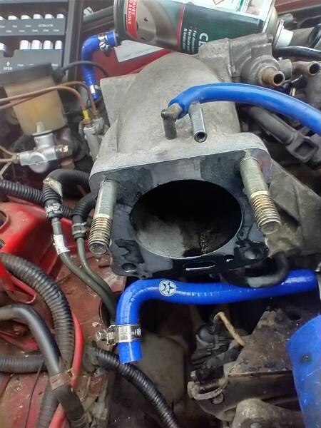

Whizzed off the throttle body and I can see the gasket is not great
It has gone hard and stuck to the inlet. Throttle body facing is relatively clean
Scraping off the old gasket took ages. It was solidly stuck to the inlet. IMG_20200405_143606291_HDR.thumb.jpg.584a24efb3a8560c99c650b92b106739.jpg
New gasket has been ordered for the princely sum of £5.  If this doesn't work I am going to strip it all off and start again.

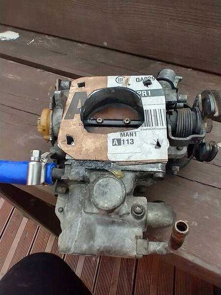

Just make one out of cereal box and fit it to see if it sorts it..
No need to wait:)
No need to wait:)
This was a top to but I decided to use a new modern medium - Amazon packaging
Light skin of grease the pushed on cardboard to get the outlineIMG_20200405_154606497.thumb.jpg.909dc3fc4c4caa997e59760b02fd10c2.jpg
Quick whizz with the sharpy stabby thing
Not perfect but it will do for a proof of concept.
And back together
Idle is miles better although still showing a bit lean.

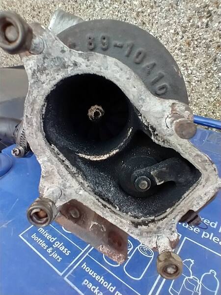

Fast forward to this morning and as I started the car I noticed a puff of smoke from the turbo area
Closer squint revealed a sooty mark
Nothing for it but to whip off the turbo
A bit fiddly but not too bad to do. Turbo off and first glance it looks ok

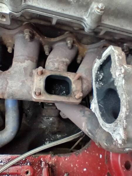

AHH that will be the badger.  Gases have been exiting out either side.  This would also explain why I thought the engine was cutting out.  It must have been hitting the AFR threshold due to being lean which then cuts the fuel.
The engine isnt running lean, the wideband just thinks it is, hence massive fluctuating idle.
Put nuts back on for now so I don't lose them

i could get a set of gaskets delivered from Taiwan but instead have found them in two different kits.
Question - is this a crack or just a weld on top runner? IMG_20200406_093813381_HDR.thumb.jpg.22c6749a93e6c78175c0f49e35037228.jpg
And of course Mr F Pirate suggested i fit Inconel studs for the turbo ... Which seeing as it is off is perhaps something I should do now.. but is more £££ .... Hmm

I ordered some td04 gaskets for the turbo, in my half arse state I just looked at scooby ones and ordered those.
Warm
No
The manifold to turbo one from a Saab 9000 fits
I consulted the Scottish oracles.... After answers that included Moah Cardboard, a fast van owner suggested some exhaust paste might make current gaskets work.
Clean it up first
Wee smidge of sticky stuff
Gasket on
At this point I realise I was avoiding all PPE. Call was put in to Safety Dog v.2 33402481ab52e288c090a9ae9ff93f0a.jpg
He was busy
Hmmm
The oil return had also been leaking so gasket swapped26b99ee14deb2bd74eb890d2b90dc92f.jpg
This was very crunchy
New gasket
The air filter was missing it ls filter so a new one was stuffed in
All filtered up
New gasket on manifold
Slapped the turbo on
