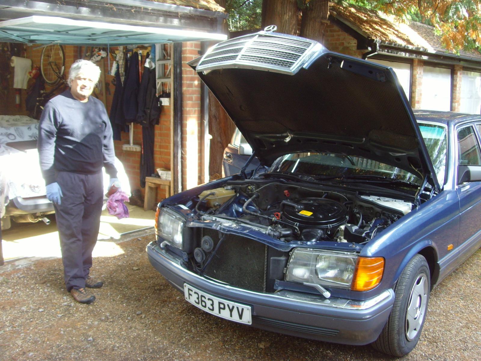

doesn't help any, but here are some photos of it.
