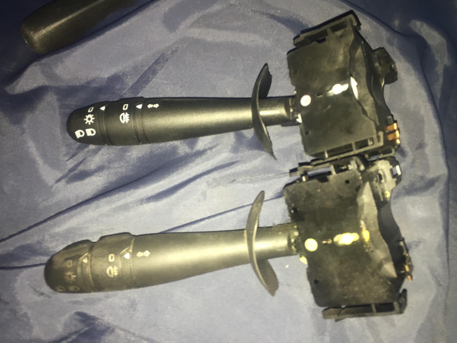

Van instrument lights and sidelights turn themselves off when I indicate left with dipped beam on. Think the indicator stalk is bolloxed because jiggling it puts them back on
Mine had a similar problem, albeit just the dash lights not the beams. Strangely it went away after a while. Very disconcerting when it started happening driving through an unfamiliar city at night the day I picked it up - I had no idea if it was just the dash lights or if the headlight were going too.

It's just the sidelights - the headlights stay on
I've ordered a new stalk which should sort it out :)

203k versus new indicator stalk
Dead easy to change - people saying the steering wheel needs to be removed are wrong
Getting the column trim back on is not so easy!
