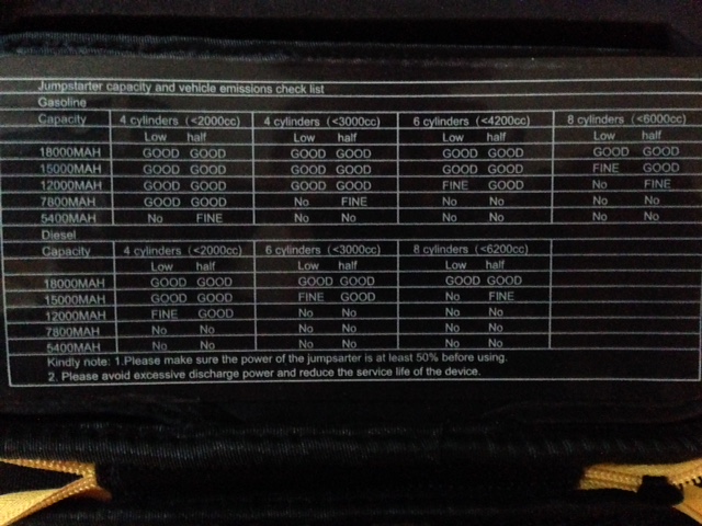

It comes with a guide to how much capacity (in mAh) you need for what size of car.  Overstretching them is apparently a rather bad idea.
So your 8000mAh one will be fine up to 2.0litre petrol but no good for anything bigger, nor for almost any diesels.  I got the biggest I could find (18k), because 5.3litre V12; the cheaper 15k version (£50) would do pretty much anything else.
Skizzer summary/verdict:  These work really well.  You get the capacity you pay for.  A cheap one will do for small petrol engines, but buy as big as you're likely to need as more capacity doesn't cost that much more.
