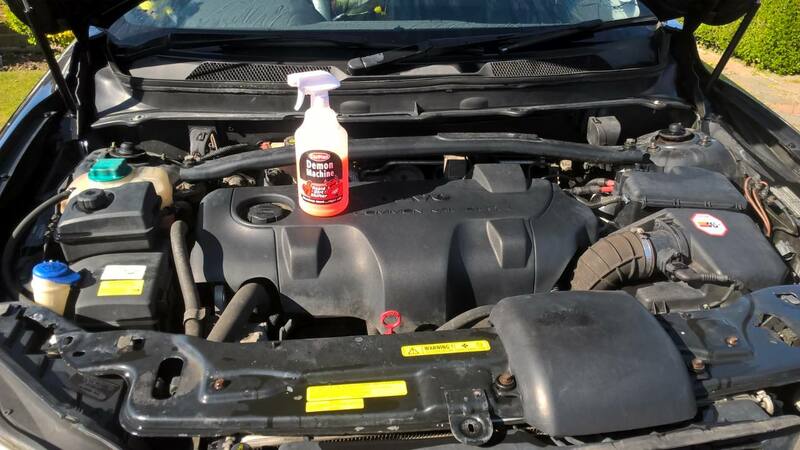

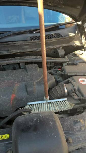

It's the cap off the back of the headlight that I'd forgotten to replace when I bunged a new bulb in about 2 months ago. Anyhoo, this really will be a piece of cake. Releasing the headlight unit is sooooo easy on these, see the two metal tag things on top? Pull them out and the headlight is released. Screw cap thing back on, bung headlight back in place, replace metal rod things. Sorted.
I then got my jet washer out and treated the engine bay to a quick blast. Much better.

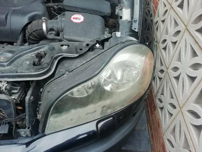

The headlights are misty - I've polished them but the crud/mist seems to be on the inside of the lens. I've investigated getting new ones - circa £225 per side on eBay, but Grandma_Outlaw was quite generous with her birthday gift, so technically they won't cost me anything.  What a PITA this is turning into. I messaged a seller with 100% feedback with the reg and he came back saying there's a choice of 4 and he'll need some reference number or other off the back. Fair enough. Plan was to do that this morning, but a subsequent email from him says Valeo can't confirm that they're available anyway. So the search goes on.

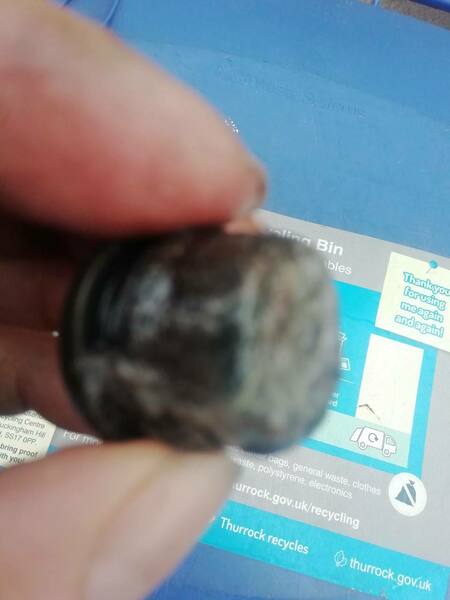

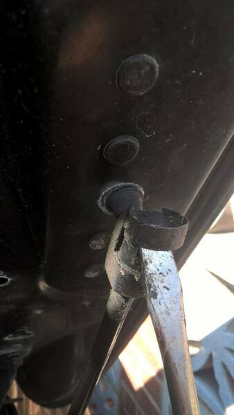

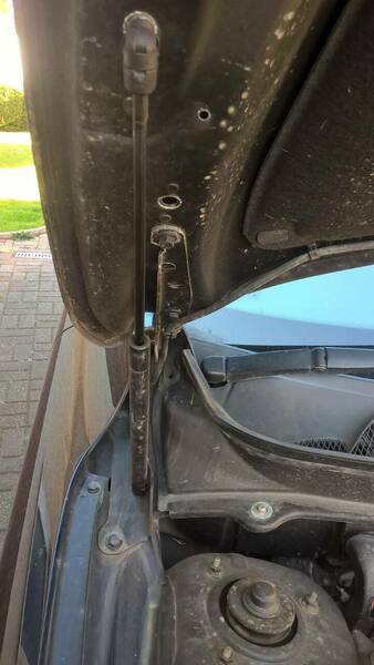

IMG_20211106_144242.thumb.jpg.93ce033aa698efdac0e4b240c1f2ac3f.jpgI pulled the rubber dubrey out of the bottom of the bottle,  which incorporates a filter - the end is perforated - as you can see was ganky. Fully cleaned out, slippery soapy stinky goo, and popped back in, everything connected up, and, I CAN HAZ SKWIRTY. I celebrated by twatting my head on the corner of the door and saying FUCK a lot.
TL:DR Fat man has trouble with idiots then does simple job.

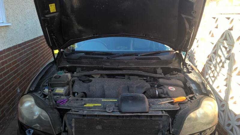

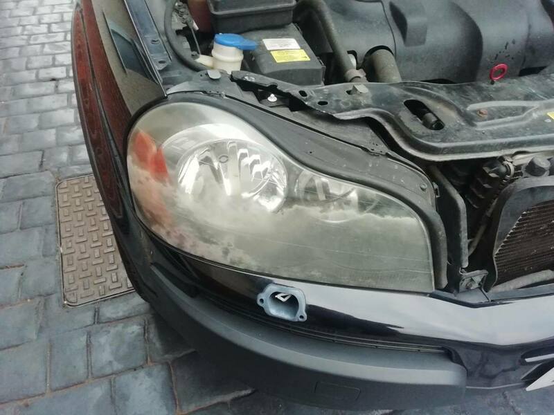

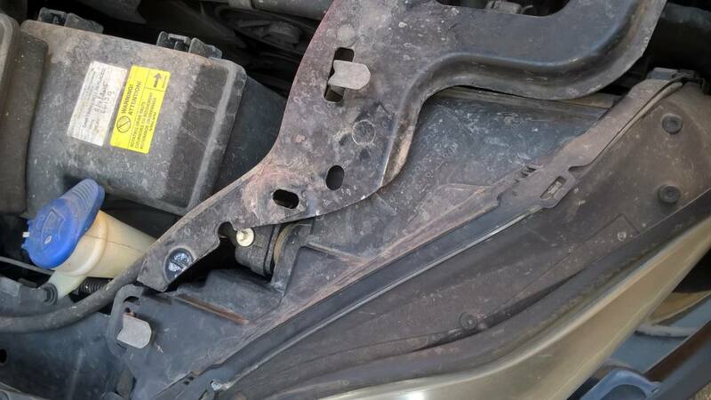

So, as described above, Moose has cataracs.IMG_20211114_153912.thumb.jpg.0ae70c74c6f6d39215700532ec08a634.jpgIMG_20211114_153920.thumb.jpg.0d1a7e6554c7416e0113879640b799a1.jpgI've polished the shit out of the outer lens but whist there was an improvement, it appeared that the mist was on the inside of the lens. There is some discussion on one of the Volvo forums about dismantling and removing the lens, then refitting is the reverse of removal etc, but I have fingers of butter and fists of ham, so I put my big boy pants on and waved my credit card ay eBay, and had a new pair of Valeos delivered for £400.
Really is a piss easy job on these, tabs on top pull out, unplug from loom - this bit took the longest as it was a bit stiff, then get new one, plug in, stuff back in the hole, then slide tabs back in.
New units came with bulbs too, so it really was a faff free job.
Both units replaced in under 20 minutes, which included a fag break.
