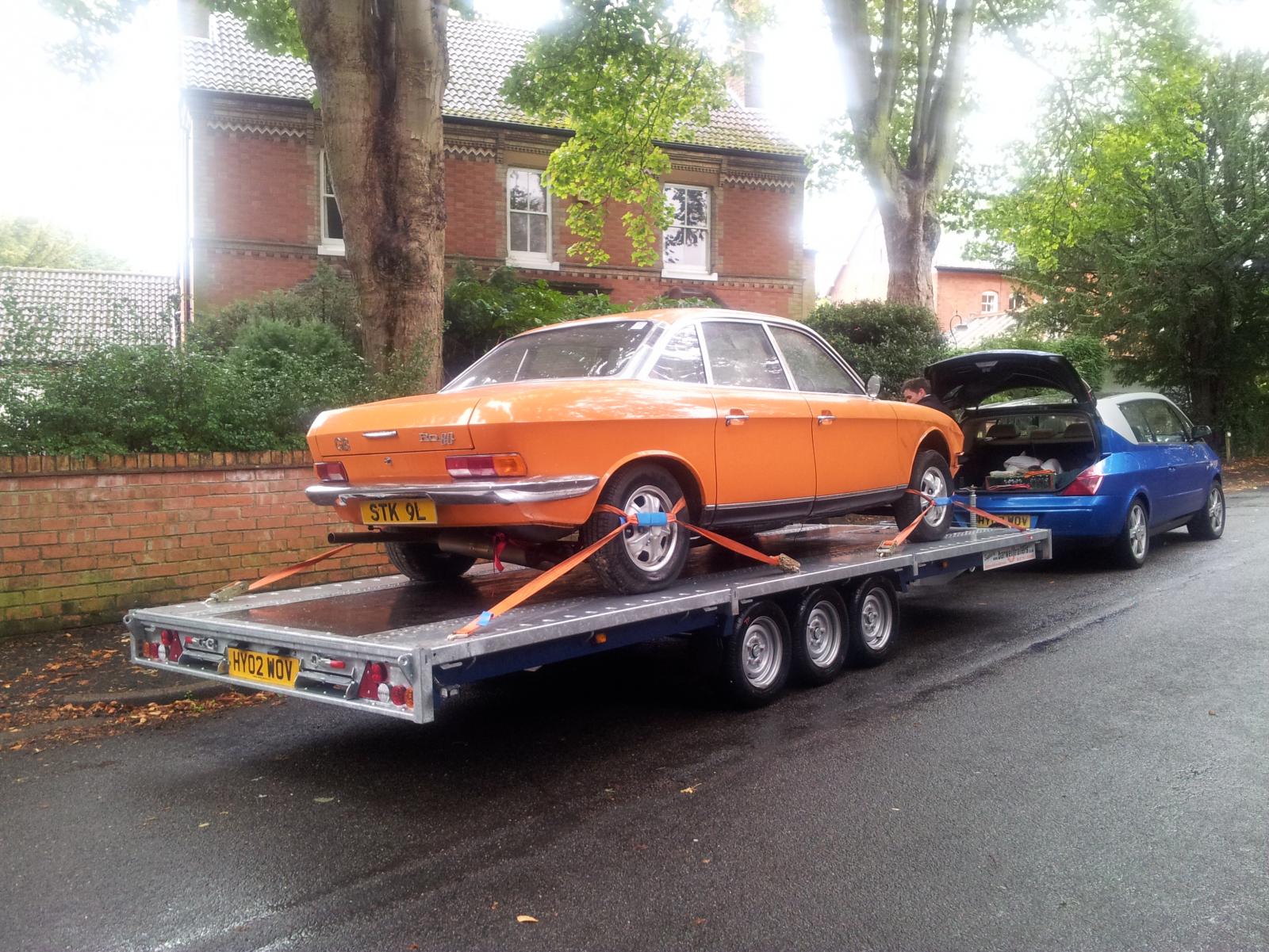

Hopefully the one in the boot of my Avantime will make a comeback, into the engine bay of the recently purchased Ro80.
Wish me luck!
