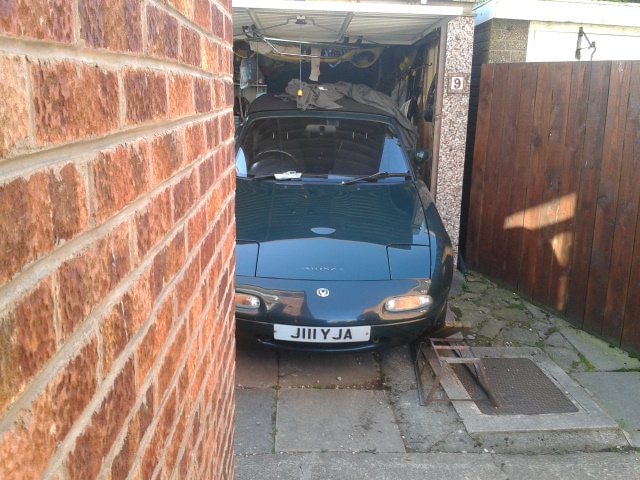

New POD Posted September 1, 2015 Posted September 1, 2015 MX5s, built by those slitty-eyed japs who bombed my grans chippy. probably) Oh come now, I think that unless your gran's chippy was in Pearl harbour, it was probably NOT the slitty eyed japs, unless, you have mistaken them for Chinese, and she's upset another Competitor. I raise the arse of an Mx5 to you.

Taff Posted September 1, 2015 Posted September 1, 2015 Oh come now, I think that unless your gran's chippy was in Pearl harbour, it was probably NOT the slitty eyed japs, unless, you have mistaken them for Chinese, and she's upset another Competitor. I raise the arse of an Mx5 to you. 2015-08-28 08.15.29.jpg ha! that made me chuckle. There is a lad near me who has an MX5 in a similar state to my F (tatty) and we have developed a friendly banter about each others cars. He has never been rude enough to lift his arse at me though, that's NBAG, mate
