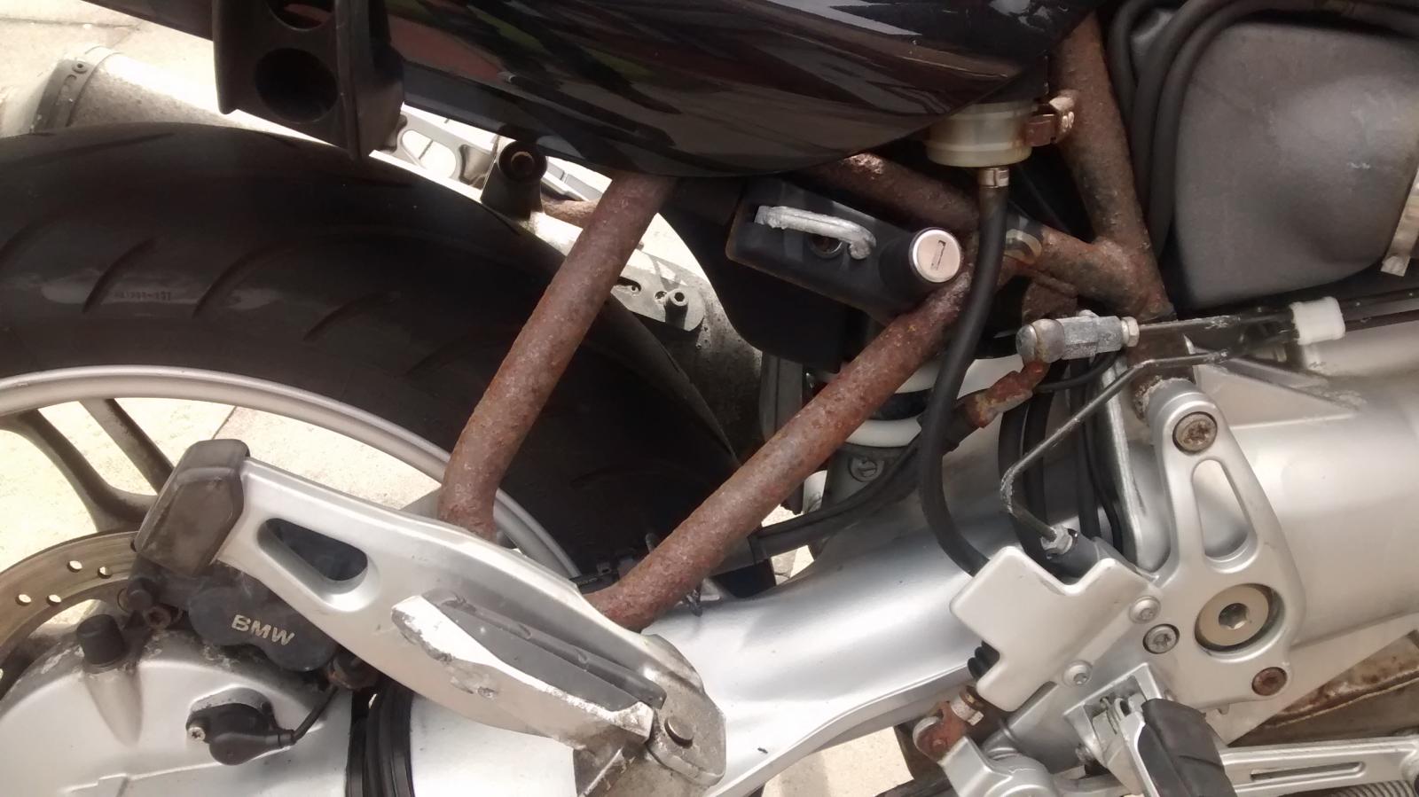

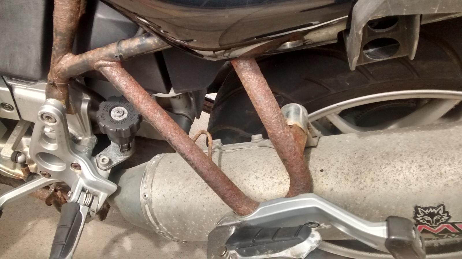

hairnet Posted August 7, 2015 Posted August 7, 2015 you remember the black and decker one with the aardvarks nose?? do they or someone else do a shorter one?? or just buy a shit load of 100 grit and 600 grit and start pounding?? the footrest hangers are the worst and above the front pegs under the seat is patchy but not as bad............ willswitchengage 1
billyboy406v6 Posted August 7, 2015 Posted August 7, 2015 Would a small wire brush do the job ? Or strips of emery cloth ?
dave21478 Posted August 7, 2015 Posted August 7, 2015 you can get sandpaper on a roll rather than sheets.....
hairnet Posted August 7, 2015 Author Posted August 7, 2015 thats what i was thinking but they seem a bit long.......
cort16 Posted August 7, 2015 Posted August 7, 2015 I just bought an Aldi power file for 20 quid and it's flippin brilliant. I use it all the time for the stuff the grinder can't get to.However, that looks pretty grim how hard is it to get off? It looks like a candidate for shot blasting and powder coating,
cobblers Posted August 7, 2015 Posted August 7, 2015 Nah, a powerfile would be shite for that, they don't have enough of a "soft" section so you might as well use a flap disk on a grinder. I'm ready to sing the praises of a powerfile all day long but they aren't for tube. You're best off getting something like that blasted. Phone round a few places and I bet you'll be surprised by how cheap you can get it done. We send stuff off at work for blasting and powdercoating and pay less than you could do the job yourself for once you'd paid for abrasives and a can of matt black. If you really want to DIY it then knock the worst off with a wire wheel on a grinder to start with.If it's mega crusty and you think a flap wheel on a grinder would make holes then you should just replace it really.If there's a decent amount of steel left then go at the easy to access bits with a flap wheel. If you are careful you shouldn't leave too many digs or corners. paint strip disks are good, soft and barely touch the metal itself, but they are fairly dear and don't last all that long - you'll kill one in no time if you catch it on a corner. http://www.ebay.co.uk/itm/Strip-Paint-and-Rust-Quick-Angle-Grinder-Disc-115-mm-diameter-x-22-mm-bore-/261979142359?pt=LH_DefaultDomain_3&hash=item3cff2c78d7 To get into awkward corners long strips of emery cloth are the way to go - if you can get a good stroke with them you can actually do a lot of work quite quickly.
cort16 Posted August 7, 2015 Posted August 7, 2015 It has got that puffed out look, which is probably not a good sign.
daveb47 Posted August 8, 2015 Posted August 8, 2015 I usually use a belt from a power file turned inside out round a drill chuck......... Allegedly. ShiteRider 1
twosmoke300 Posted August 8, 2015 Posted August 8, 2015 Dave-numbers is on the right track , get a roll of emery cloth and get stuck in
brickwall Posted August 8, 2015 Posted August 8, 2015 Power files are awesome, but can be a bit aggressive. Use a light band and don't use much down force.
hairnet Posted August 8, 2015 Author Posted August 8, 2015 toolstation do 3 inch wide 5 and 10 meter lengths gonna give that a go first theres subframes on teh bay but its a faff stripping and putting it all back and need bike for stuff and its only transport this way can do a bit then paint do a bit then paint fanks ya crazy muthas
willswitchengage Posted August 8, 2015 Posted August 8, 2015 you can get sandpaper on a roll rather than sheets..... Practical joke opportunity: swap out the bog roll dispenser at a club for one of these and listen to the drunk people scream
willswitchengage Posted August 8, 2015 Posted August 8, 2015 Also SotchBrite works really well, especially the mauve one. Awesome BMW build quality anyway
hairnet Posted August 8, 2015 Author Posted August 8, 2015 apparently they all do that if its not alloy - something to do with not using undercoat in berlin at the time living on brighton marina for 9 years - his berth sticker is stuck to the screen - doesnt help
