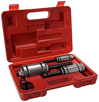

oldcars Posted August 24, 2017 Author Posted August 24, 2017 Bolts came out ok. Back box bolts hard going, but new exhaust system is fitted. Bit of waxoyl spray underneath car as well. There is a small blow where the backbox fits the pipe. How's it best to sort that?
Mally Posted August 24, 2017 Posted August 24, 2017 Holts Gum Gum.Can remove the box and coat the joint then replace, or try just squeezing a bit in the leak.Read the instructions, it's a while since I used it, but you may have to dampen the area first. oldcars 1
Eddie Honda Posted August 24, 2017 Posted August 24, 2017 Make sure the backbox is fully home? For all the bother it sounds like you need to borrow one of these (I've got a set, but miles away) Helps, especially when putting used bits of pipe back on to "unpinch" them. Also as above, assembly paste. oldcars 1
oldcars Posted August 24, 2017 Author Posted August 24, 2017 Make sure the backbox is fully home? For all the bother it sounds like you need to borrow one of these (I've got a set, but miles away) Helps, especially when putting used bits of pipe back on to "unpinch" them. Also as above, assembly paste.I think the back box in fully home, its hard to try and do it on your own, but i'm sure it is. Popping to a mates tonight as he has a ramp, doing it on axle stands was hard work.
oldcars Posted August 25, 2017 Author Posted August 25, 2017 Make sure the backbox is fully home? For all the bother it sounds like you need to borrow one of these (I've got a set, but miles away) Helps, especially when putting used bits of pipe back on to "unpinch" them. Also as above, assembly paste.You were spot on, back box not seated properly on the pipe. Bit of paste and seated it correctly and its all sorted. Mate said stick to my day job, kwik fit won't want me Tickman, Eddie Honda and UltraWomble 3
