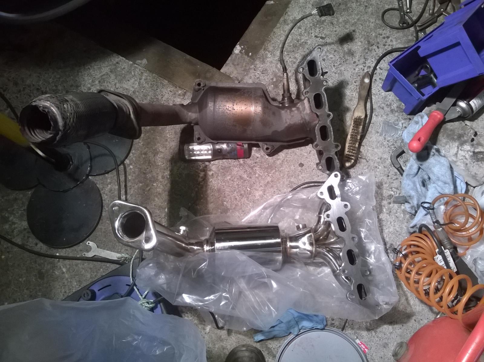

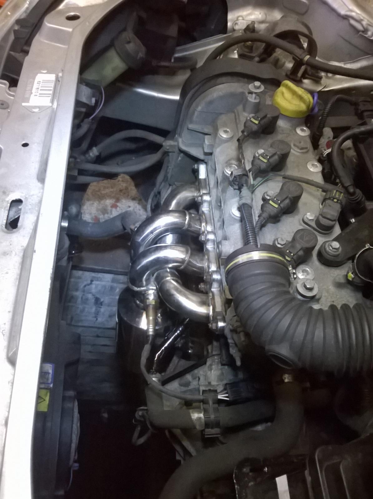

As you can imagine as it didn't have a CAT in it, it brought up the P0420 code. I read on the Fiat forum the advice I gave above about removing the secondary probe and leaving it tie wrapped out of the way. However I could only remove the secondary probe if I removed the manifold due to the lack of clearance as you can see below. As it was such a ball ache to fit I didn't fancy doing it a second time.

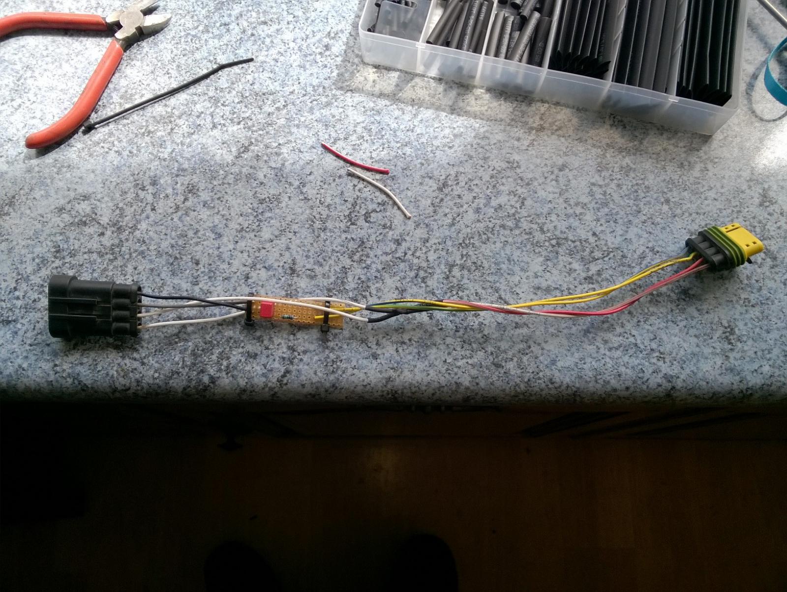

So I did a bit of digging and found this site: http://www.newcelica.org/forums/showthread.php?t=216641
I don't like the idea of hacking about the lambda probe wiring so I nipped down the scrappies and chopped of the plug and socket in the lambda wiring. I then made up the low pass circuit suggested in the above website and fitted it to a small piece of veroboard  I then had a nice low pass filter I could insert into the secondary lambda probe wiring
I potted the veroboard in epoxy to protect it, taped up the wiring before slipping over some protective sleeving I also nabbed at the scrappies, I then inserted it into the lambda wiring and viola no more P0420 :)
