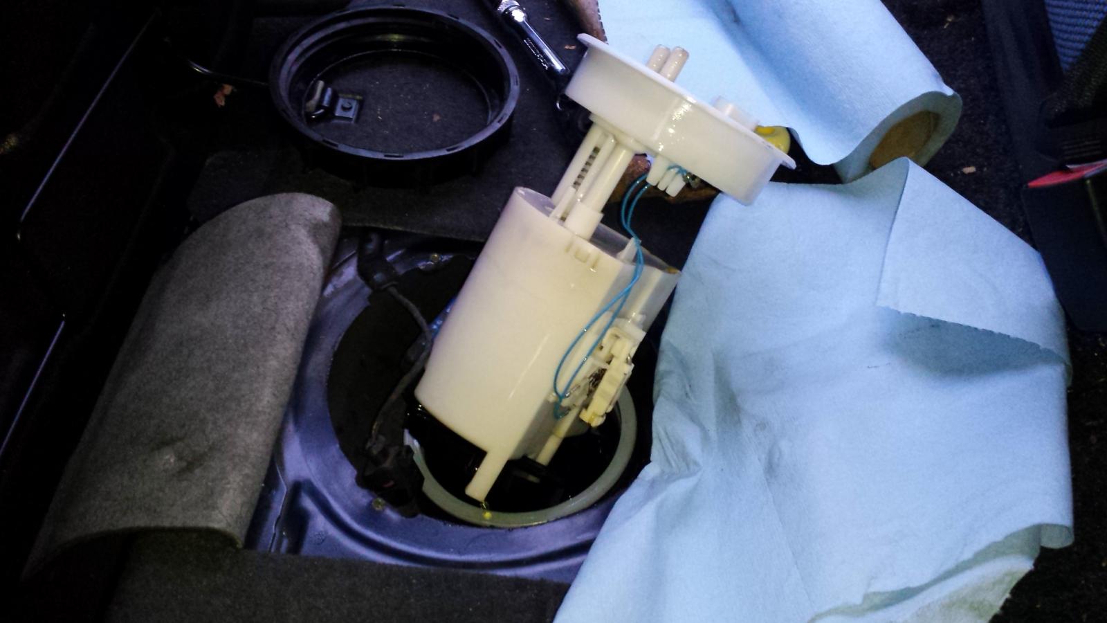

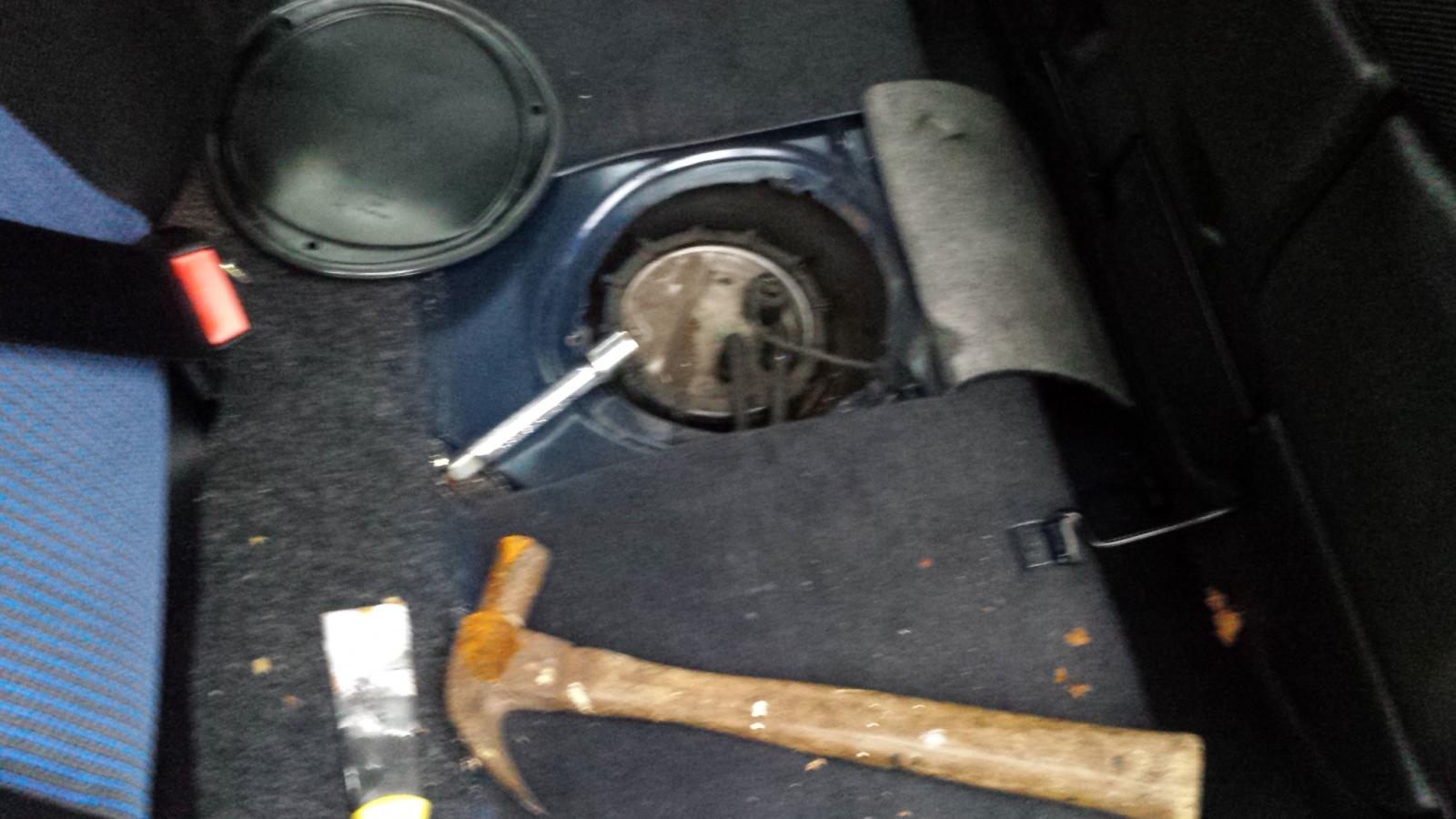

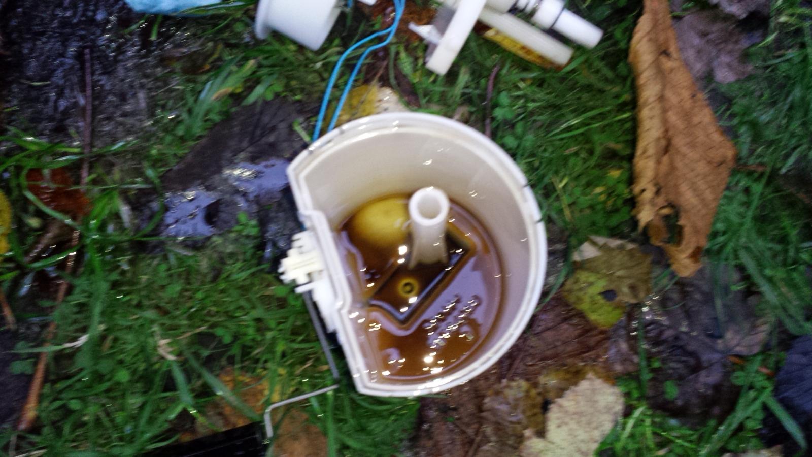

I managed to get bothered enough to have a look at this bugger today.
Managed to get the sender unit/feed from the tank strpped out and cleaned up.
I put it back together and had no bubbles in the line.
Will try a 50/50 mix tank to see if it is ok

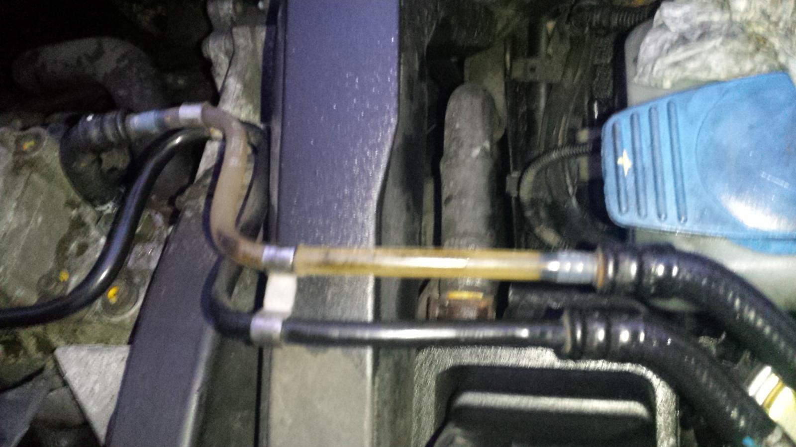

I used to have a Pajero and they are known for rotting out the fuel lines underneath causing air etc.
Approved repair* is to get a massive length of rubber hose in the right size and replace, cable-tying to the existing pipes under the car.
Possibly worth a go as fault-finding / sanity check if nothing else?
Pipe on tank - go through car, out window, onto filter head, see how it drives.

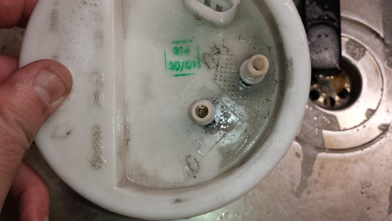

But did you put a few bigger holes in the pickup's fine strainer mesh, and remove the hugely restrictive check valve in the supply connection (small spring and other gubbins in the path of the fuel)? Use of 5mm drill bit needed.
Known to cause probs even running on diesel in colder countries, VW modified the part on later cars to prevent the problem.
Although fella on the vid doesn't drill out the problem (just replaces the entire unit with a new revised one), he separates the parts of the assembly, which is necessary to clear out swarf etc. About 6mins in. www.youtube.com/watch?v=yRMTEAKsScE
No I didnt- as detailed above several times it was removed and cleaned.
I didnt have the means to pynch it out/widen filter mesh so just cleaned it out.
it wasnt even that dirty, and the chamber was full when I pulled it out.
As is, it has about 2 weeks mot left, and I've lost 3 days fucking about with it.
I'm not pulling it out again. I may try the fresh pipe from pickup to filter if I can get some easily
Do you not know any truck mechanics or haulage yards,
I have stripped a few trailers now and kept the plastic airline's which run the full length, I deal for fuel lines if you use the thicker ones.
Alarmingly not unfortunately.
Wonder what I could use? outlet on the sender is pretty small bore

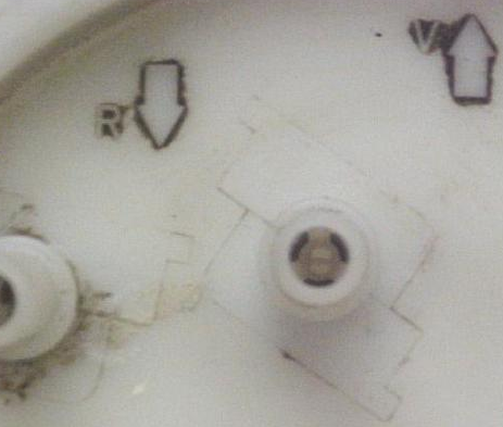

Bet my bottom dollar it's that huge restriction in the supply tube in the sender unit as pictured, along with the fine strainer mesh. Well-documented on TDi forums, VW changed the design to prevent exactly the probs you're experiencing.
Half an hour's work to prevent all the ballache you've had would be well worth it, shirley?
