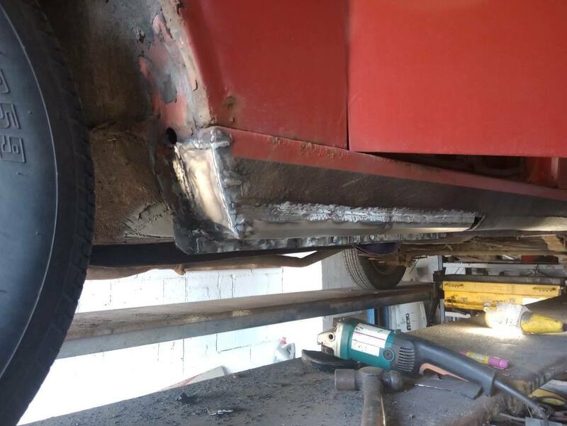

DodgyBastard Posted May 25, 2022 Author Posted May 25, 2022 Made a small amount of progress on the 504 welding, one bit of floor and an inner sill all welded up. I ran out of gas at the end so switched to gasless wire but it was absolute dog shit so have stopped until I get more gas tomorrow. I had a look at the Cortina, it just looks like the seal where the prop joins the box has given up. Wishful thinking is remove the prop, fish out the old seal, fit a new one and top up the oil and hope for the best. I should be picking up another gearbox tonight anyway so no drama if the simple fix doesn't work. LightBulbFun, mercedade, cbowditch and 5 others 8

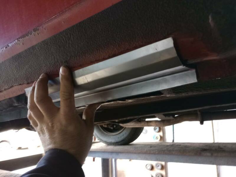

DodgyBastard Posted May 26, 2022 Author Posted May 26, 2022 Gas purchased this morning so I set about making a sill panel. Annoyingly the metal folder wasn't long enough for the complete section so I had to chop it in half. Welded it together. And done. Just 3 small sections to make an weld in then I can change the slave cylinder. Dick Cheeseburger, mercedade, BeEP and 14 others 17

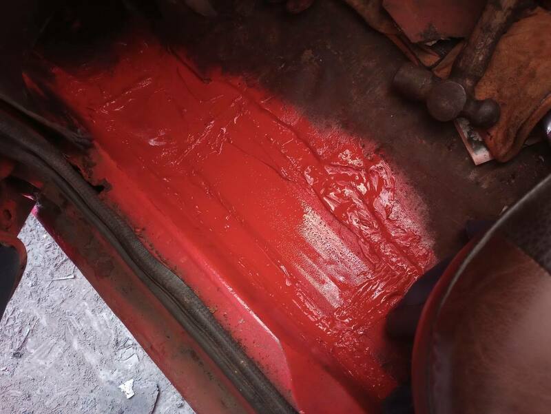

DodgyBastard Posted June 14, 2022 Author Posted June 14, 2022 Some more progress made on the old LDV Pilot. The passenger side step was in much better shape than the other side with only a couple of patches required. It's a pity the rest of the sill on this side is full of holes. Bear, Shite Ron, artdjones and 14 others 17
