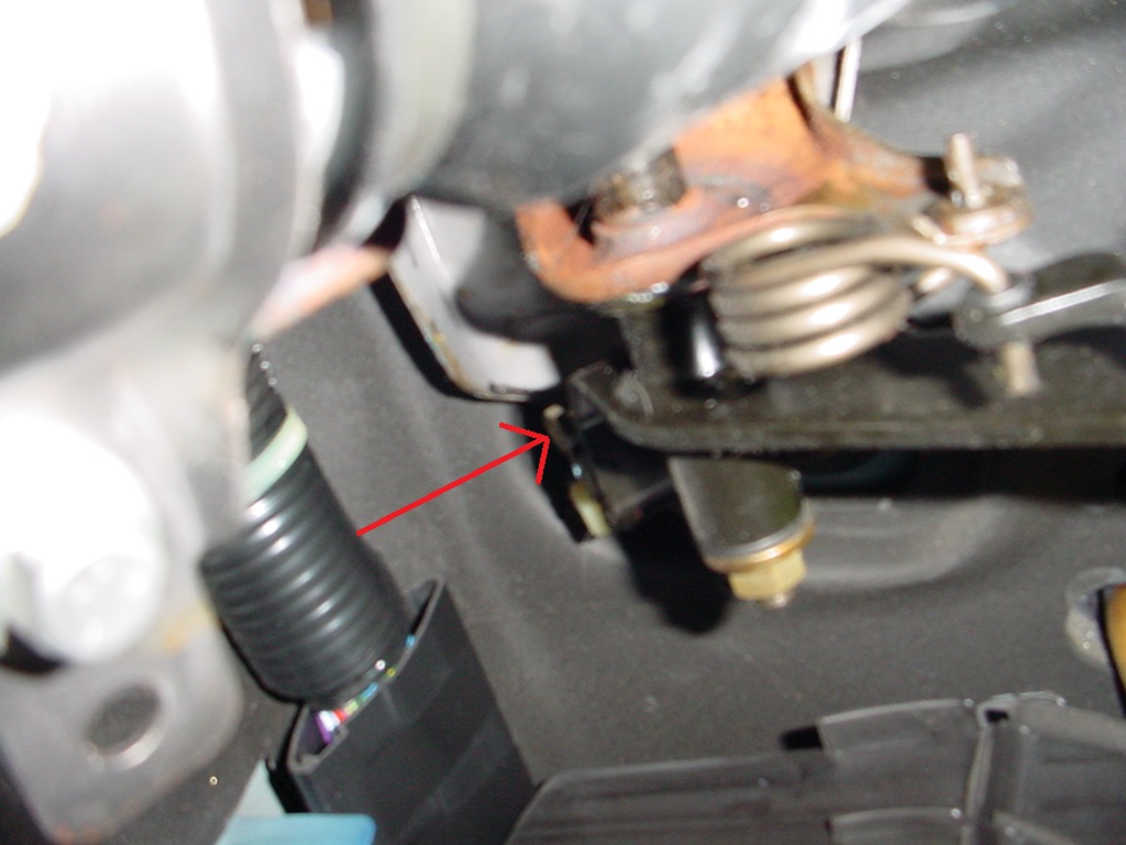

saucedoctor Posted August 6, 2015 Posted August 6, 2015 There a bolt on the back/top of the clutch pedal, and they wind out. Wind it in a bit. TADT,S. Should lower the pedal a bit. Check the nut on the end of the pedal bar, too: the one on my 25, and my mate's ZedArse weren't tight. With regard to the hunting idle, considering that it's a ZR and has seen some engin-bay Barrying, it's worth checking that someone hasn't removed the airbox resonator to give MOAR INDUCTIONROAR YO. eddyramrod 1

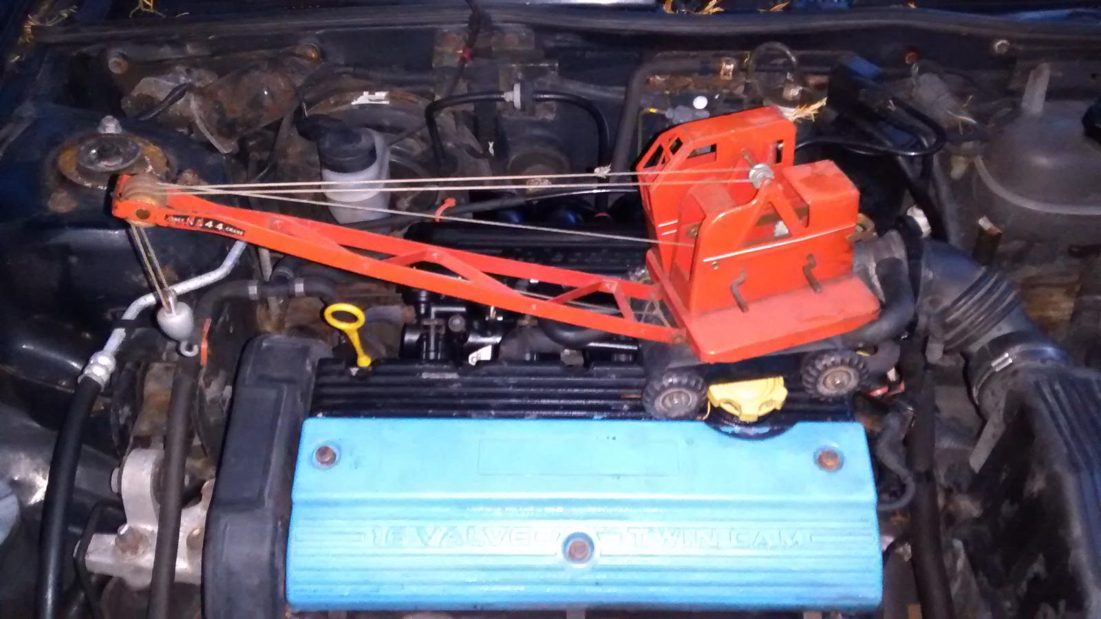

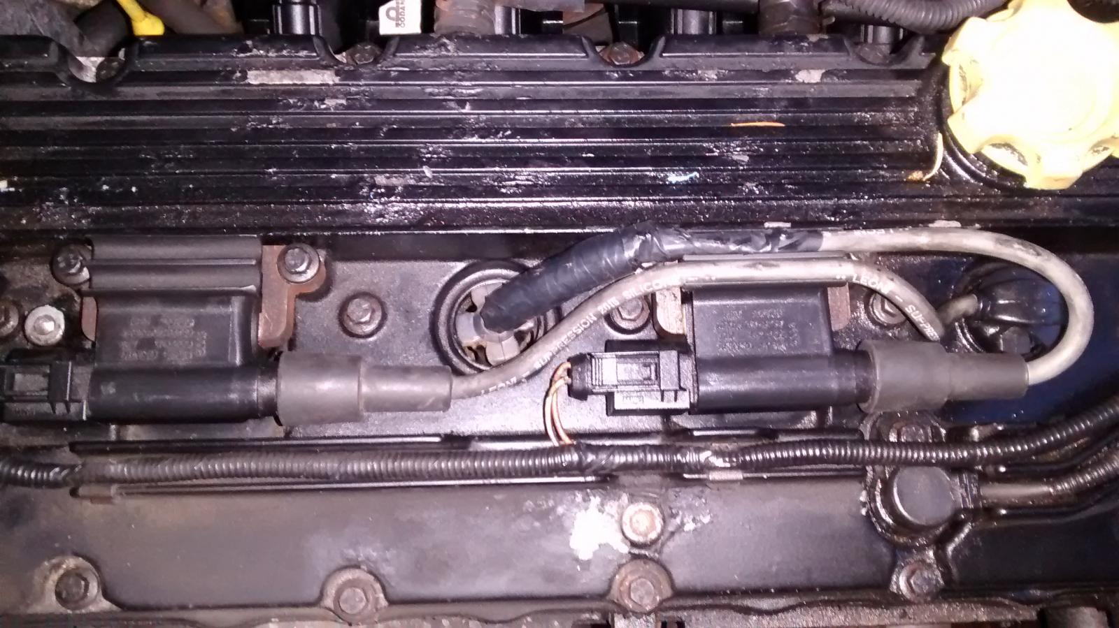

garbaldy Posted August 10, 2015 Author Posted August 10, 2015 I decided to have a quick look so fired up the old crane and removed the cover,It looks like someone has put a bit of hose pipe and a load of insulating tape around the plug lead, could this cause the running issues? DeeJay, Cavcraft, Dave_Q and 1 other 4

Pillock Posted August 11, 2015 Posted August 11, 2015 Could be, it doesn't look like MGRover Hosepipe and Insulating Tape. Theirs was thinner and cheaper. Ben_O 1
Forty-two Posted August 11, 2015 Posted August 11, 2015 If you can run the car somewhere dark, no street lights, you should see electricity escaping up the lead. Worked to diagnose shite leads on a Nova back in the 1990's... eddyramrod 1

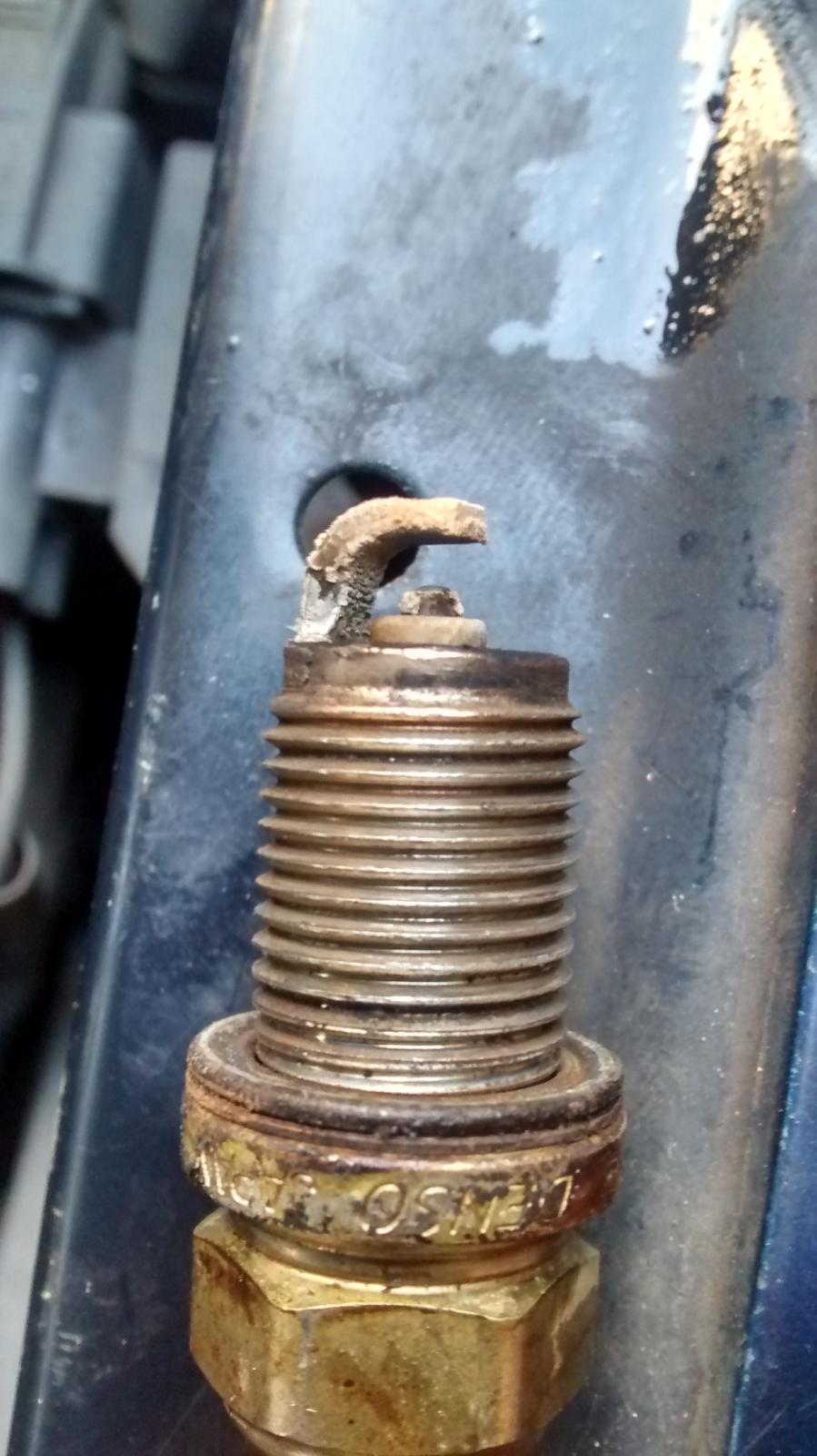

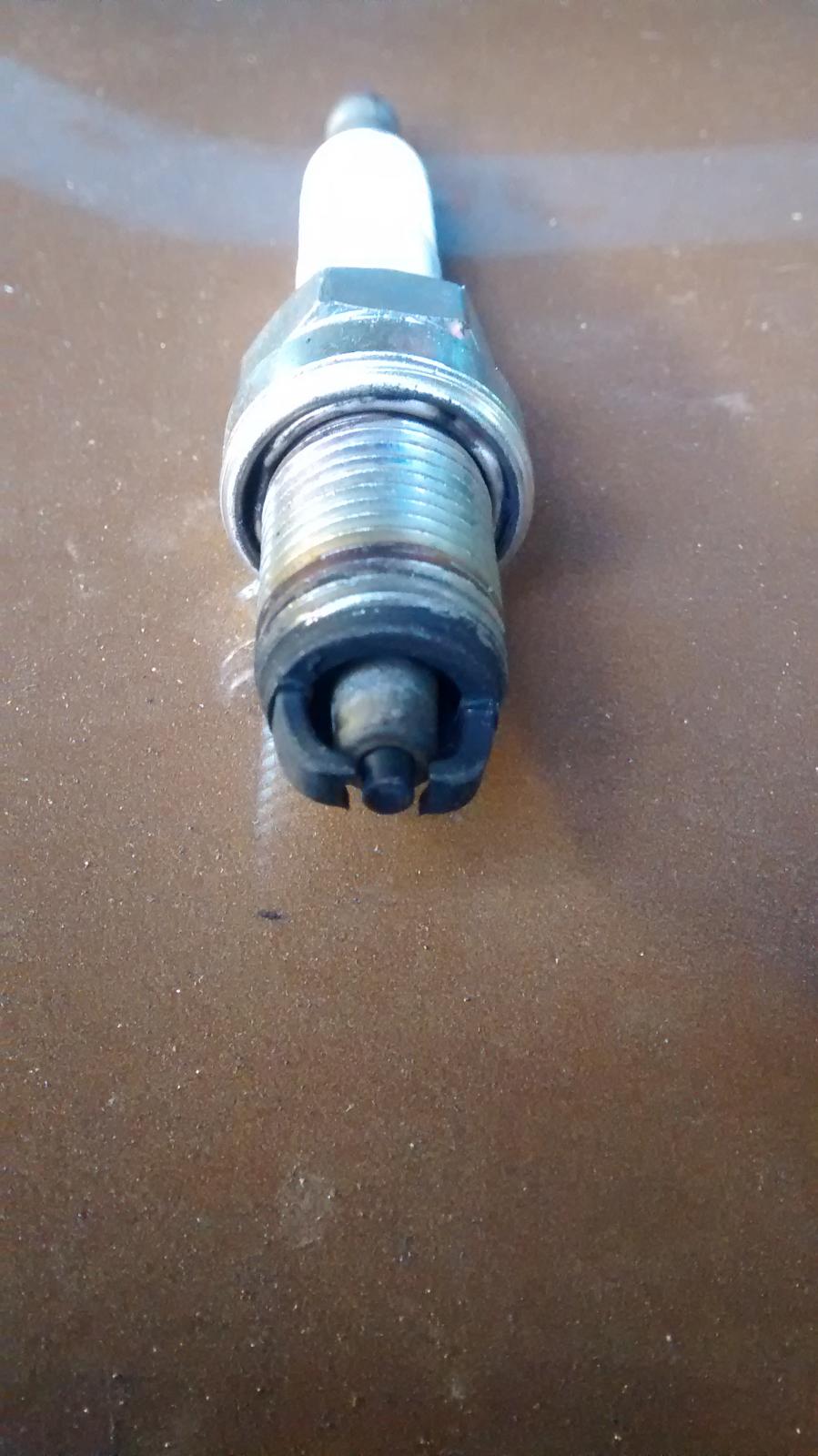

garbaldy Posted August 11, 2015 Author Posted August 11, 2015 If you can run the car somewhere dark, no street lights, you should see electricity escaping up the lead. Worked to diagnose shite leads on a Nova back in the 1990's...you haven't seen where I live, nearest street light 2 miles away, anyhoo I decided to pull plugs out to have a laugh at them, this is what I discovered. After much laughing and pointing i found a set of these in the stores so bunged them in and it still does it. fiddlesticks

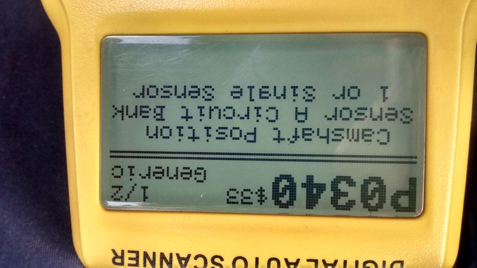

garbaldy Posted August 15, 2015 Author Posted August 15, 2015 Well the guy rained of.I decided to chuck my cheepy £2.99 code reader onto the car and this is what popped upStrange that my friends sooper dooper snap on code reader showed up no faults Soz for the PIC I blame the code reader Lacquer Peel, mouseflakes, Vince70 and 1 other 4
