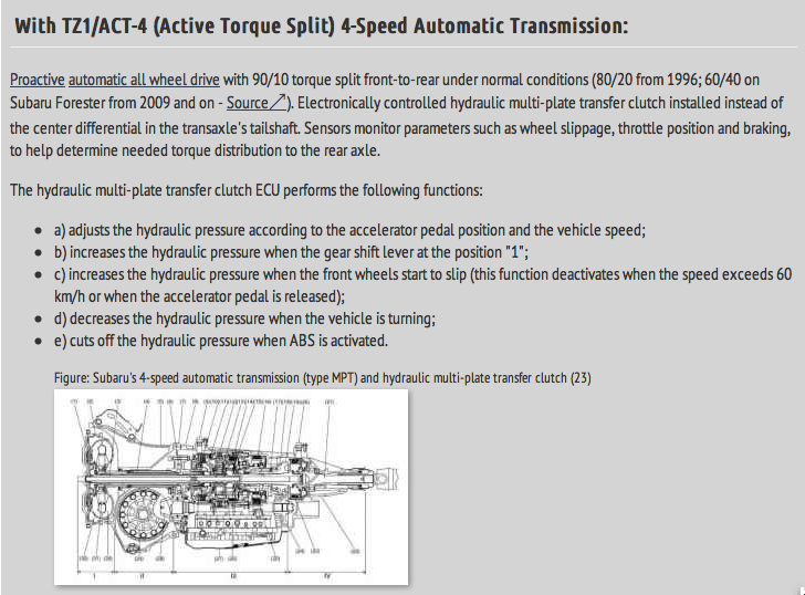

Re the auto - does that mean its basically FWD most of the time, until it senses the front wheels spinning then sending torque to the rear to compensate? Have I understood that right? Can it be overridden to force it to be 4wd all the time? Do they have 'low range' or equivalent?
I don't think the auto has a low range like the manuals. Only some manual Subarus have the dual range manual box, the turbos and three litres do without, as do Legacy saloons.
Yes, the autos are basically front drive, with rear drive "added as required". I don't know if they have a force-4wd mode.
