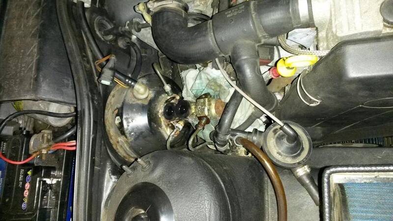

Brake fixery happened last week - just got round to updating the thread!
First, the entire braking system was emptied of juice via the bleed nips
The standard master cylinder always had a little too much pedal travel due to the MK2 Golf 16v discs and calipers used, so I thought this would be a good time to upgrade it.
Old M/C just before being jettisoned.
Alloy Golf spec item installed.
The replacement of the load compensator valve would have been a lot easier if the previous owner hadn't spaffed the whole thing with grease. It was a very messy job, and as a result of not wanting to besmirch my phone, there are no pics of the job in progress! I did take this shot of my gypsy style method of safely suspending the rear end of the car at a height that allowed the operation to take place. :)
And this is the failed valve with 99% of the grease and shite removed so you can almost see what you're looking at.
Once bled up with the help of my nephew's right foot, I now have a nice short pedal travel. It still needs to be stood on pretty hard to effect the rapid shedding of speed compared to a modern braking set up, this being down to the teeny tiny servo fitted to the RHD cars - there's simply no room for a bigger one without some bulkhead surgery. :( I might* have a go at that next time it's all in bits! :)

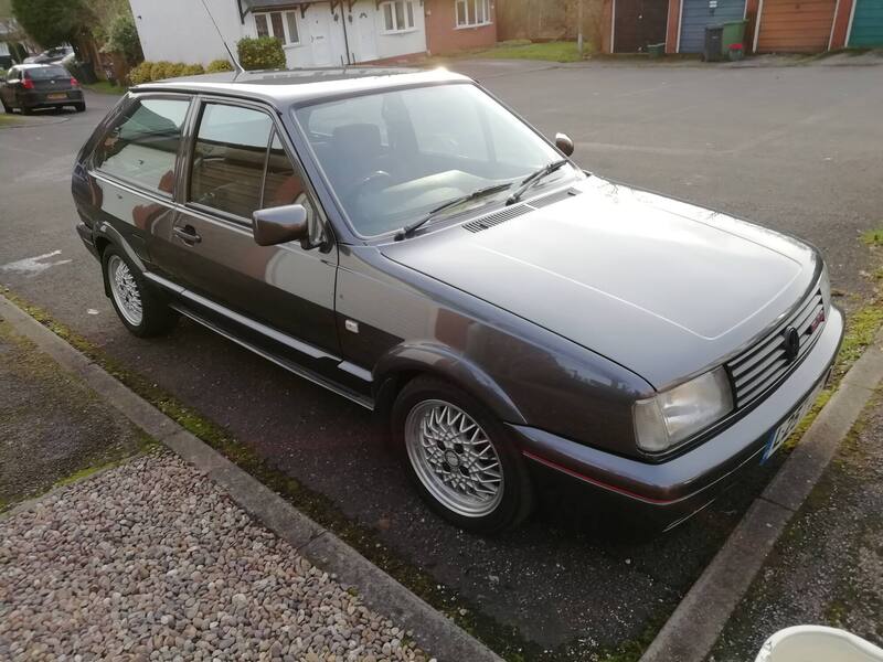

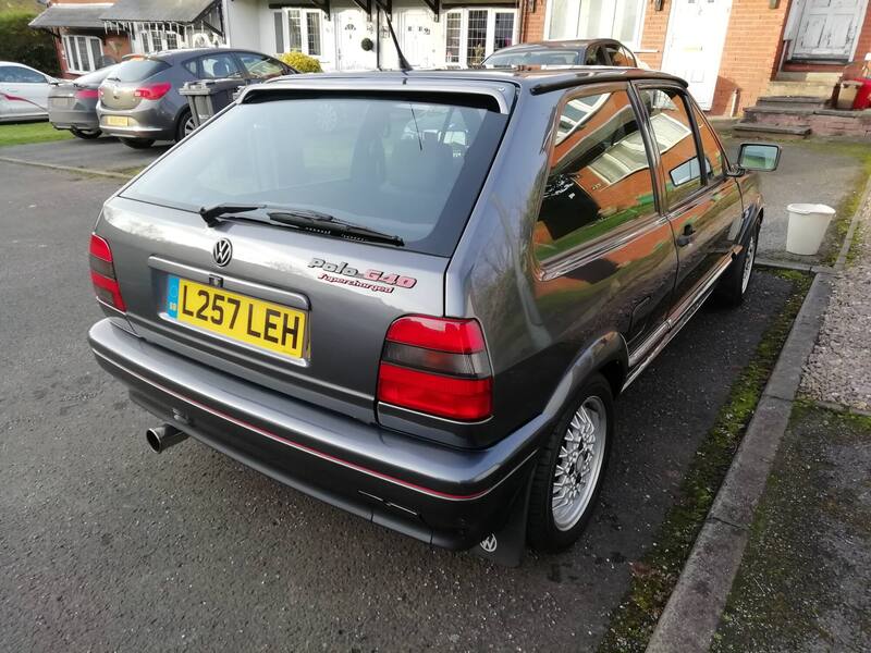

Spare time over Christmas means that this gets a bit of attention for a change.
Fettlings to begin at the weekend. 👍

Barely had the time to drive this, let alone give it "the treatment" .
Plans are being made to make a start on it, hopefully in the next few months.
