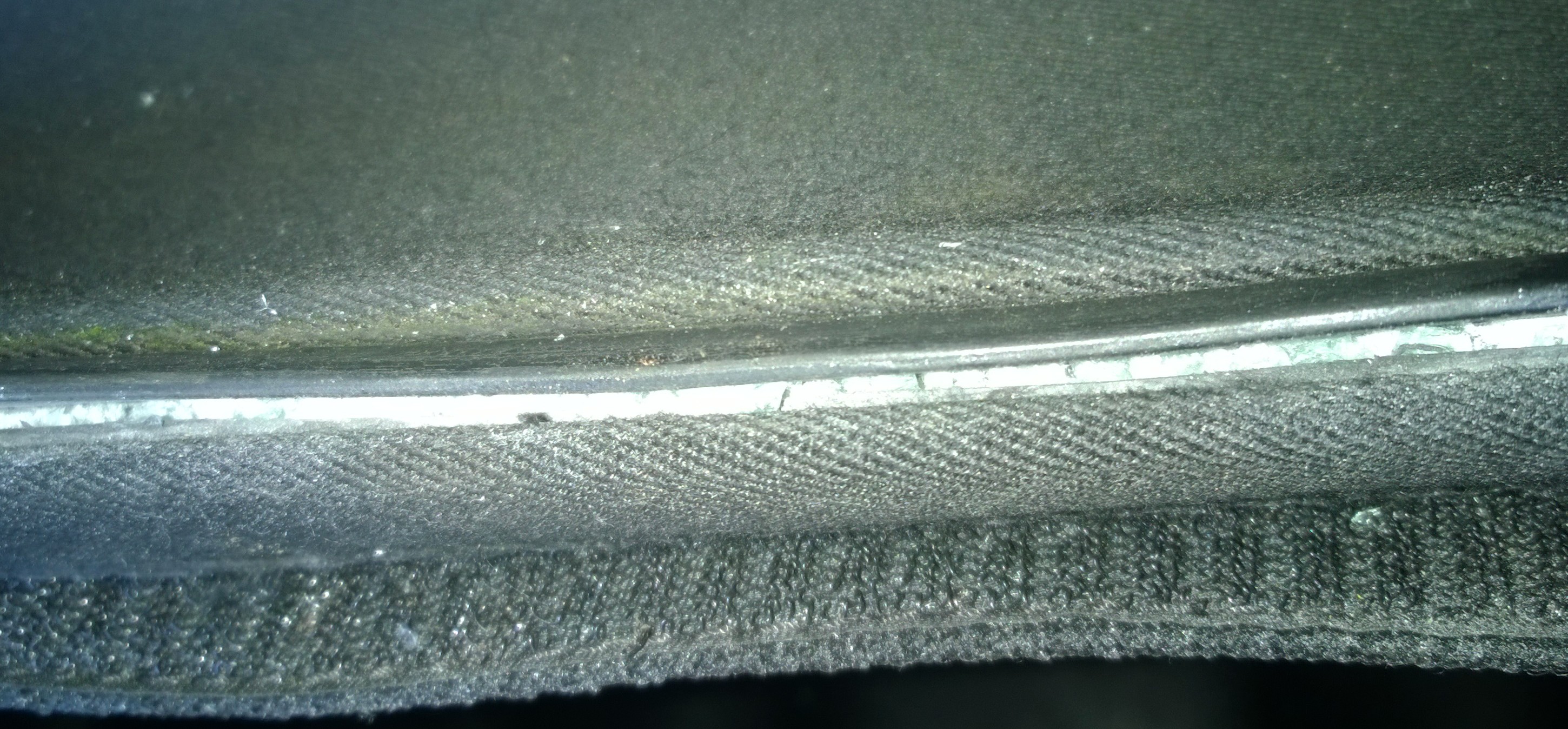

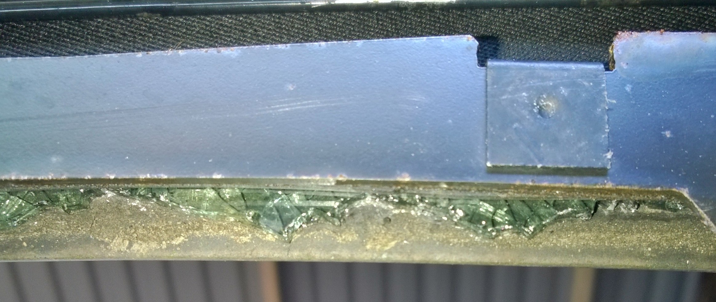

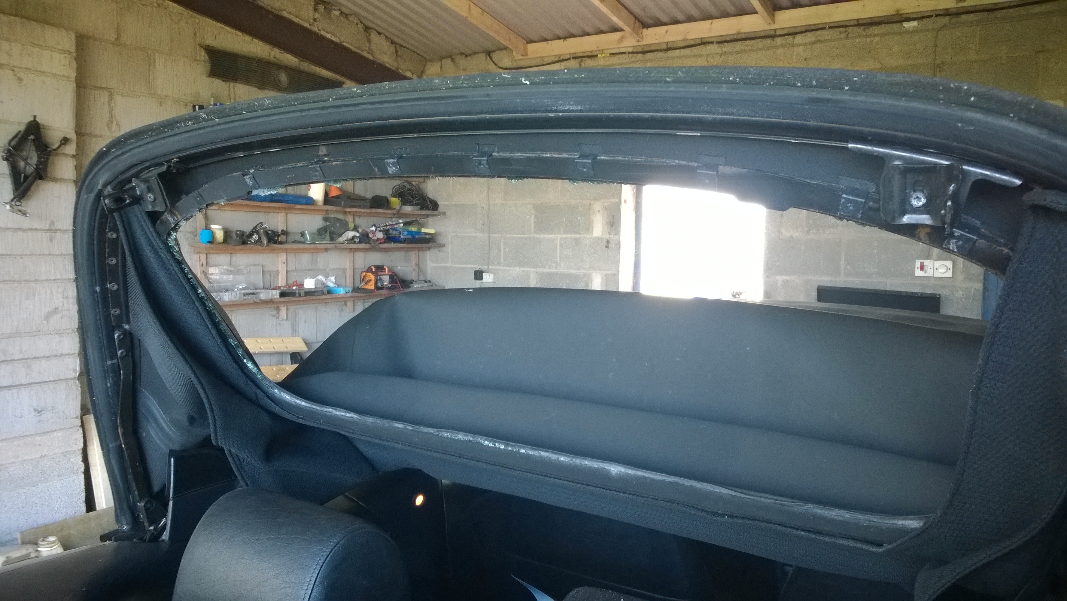

Put the hood up to have a better look and there seems to be a channel the glass sat in. After applying a screwdriver I reckon I can clear the channel out ish.
Is there an alternative to glass I can use to fill the hole?
Happy if I can get the hole filled, even if I cant use the hood. Even better if there is a way to make it heated :)

Spoke to 3 glass places and it would have to be specially made. They were only bonded like this for a couple of years after which you could remove them.
I would have to find a secondhand hood with glass and fit that. The hood is fine which is why I dont want to mess with it.
Have you tried cab glass? They specialise in plant but could cut a piece of glass ready to 'bond' in with araldite/gaffer tape
That might be an idea. I think GF-Moog has decided she wants car replaced. I think she wouldn't trust it if isn't a "proper" repair.
Thanks for suggestions but will just put it up for sale without window, let new buyer make a decision.
